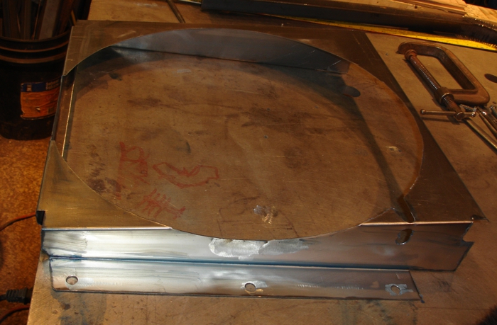

I spent some time in the shop making up some more sheet metal parts. First up was fitting the lower radiator splash panels. These came in two parts and seal off the space between the bottom of the radiator and the mounting bracket and the frame cross member. As expected everything lined up perfectly.
I also started in on making up the radiator shroud. I got the top one done up.

The radiator shroud is coming along. This was a pile of work to measure 5 times and then cutting it out.
