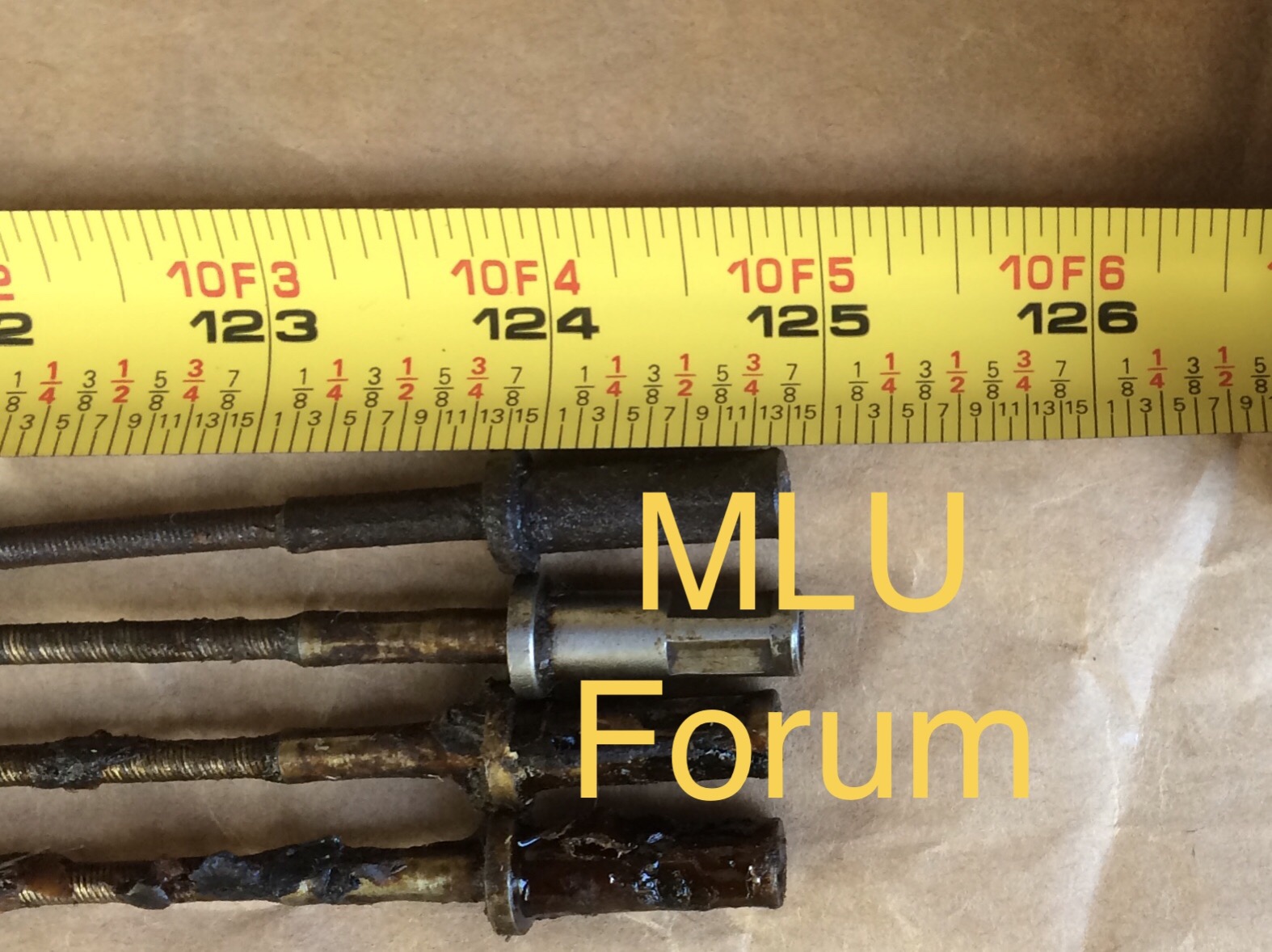

The speedometer shaft was supplied as an assembly with the inner and outer parts. Canadian speedometer shafts and casing assemblies replaced the UK Type Y, although the inner remained the same length, 10’ 3”.
The Canadian shaft and casing assembly for the three bogie wheel hull models is P/N C01UC-106014-B.
There were two Canadian speedometer types, identified by the change in their dial and pointer. The early model dial is observed with white markings on a black background, the later model, usually called the MK-II* speedometer, had a two tone white and black dial, white pointer showing a red tip. See part numbers C01UC-106001-C for the speedometer assembly, along with 106106 B, and 106107 B for the dial and pointer.
The black dial face pictured is a reproduced item by an MLU contributor.
25586971-C8F1-49D2-8937-EC77898316E1.jpg   92A06980-3396-47D5-BE92-BEFF17D618AB.jpeg   505EBF76-8925-4A11-8627-3B17D213E759.jpg   73FBC23B-4C8A-47B8-AA8A-A298E32411B1.jpg

The speedometer cable length is published as 10’ 3”. Once you add the end bits the total length is closer to 10’ 5”.
6CBD162B-6FB3-4953-A2E9-70CBE35C565A.jpg   54E7B369-A93C-44EE-B571-356DBE87DEB9.jpeg   F638662F-67ED-4F3C-9CE3-BC35360A4258.jpeg
