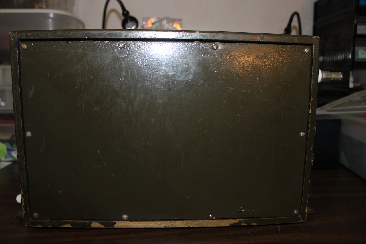

Default Pictures of WS52 Aerial tuning coil.
At the moment its looking a bit sad as its been got at. But I'm sure I can invisibly mend the chopped out bit. The connector is my biggest concern

Posts: 3,720
Yikes, Brian.
Looks like an entire family of Bodgers moved into it for a while. Even added a switch to the front panel. Probably to turn on the coffee maker. I often wonder what prompts people to ‘make things better that don’t really need to be improved.
I will see what I can do to help.
