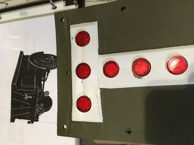

«* Question «* to the experts : The «*T*» sign that goes on the rear right corner of the Canadian trailer , what colour should the contour be ? Black or Green / Canadian Brown . The «* T «* proper is white , i get it . The jewels / reflectors red but why would the contour be Black like the British ones instead of Green / Canadian Brown ? anybody got WW2 era colour pictures ? The pictures / illustrations i have are all black & white so impossible to tell .

Old 11-10-19, 04:24
Location: Burnaby B.C. Canada
Posts: 1,137
Default T plate
mine was only ever green and white.
Old 11-10-19, 06:04
Posts: 4,192
Nice find and nice job on the trailer. I believe that the T plates were satin black with a white T and red jewels.
Old 12-10-19, 05:43
Robert Bergeron's Avatar
Join Date: Nov 2012
Location: East Central Canada
Posts: 1,532
Thanks Harry ( miss you btw) . Was it an original plate , never restored Harry ? Thank you Jordan . I accept that British trailers had a satin black contoured plate . But what about Canadian trailers , what evidence do we have .
Note : Colin McGregor - Stevens ( Hi Colin don’t be jealous miss you too ) wrote an excellent piece on these trailers , look it up on Goggle under 10 Cwt . These were «* the*» Jeep trailers for Canadians . They continued post -war right into Korea . Canada even reinforced the T-3 Bantam / Willys trailers to make them 10 Cwt instead of 5 Cwt they were so delicate and inadequate. So , for a correct Canadian Ww2 ETO Jeep you need a 10 Cwt trailer by Brantford & Body or a modified T-3 !
44 U.C. No-2 MKII* /
94 LSVW / 84 Iltis
Old 12-10-19, 18:32
Posts: 1,137
Default My trailer
Mine was all original when I got it. I’ll look for the pictures.
Old 12-10-19, 20:48
We have an unaltered T reflector plate at the museum. I'll post a photo Tuesday (if some of this snow is plowed by then) . I believe it is black.

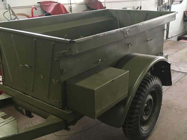

Here is what it looks like today with the wheel fenders and document box .

Front view with fenders and tool box.

A looksie from behind . Still lot’s of work to do .
