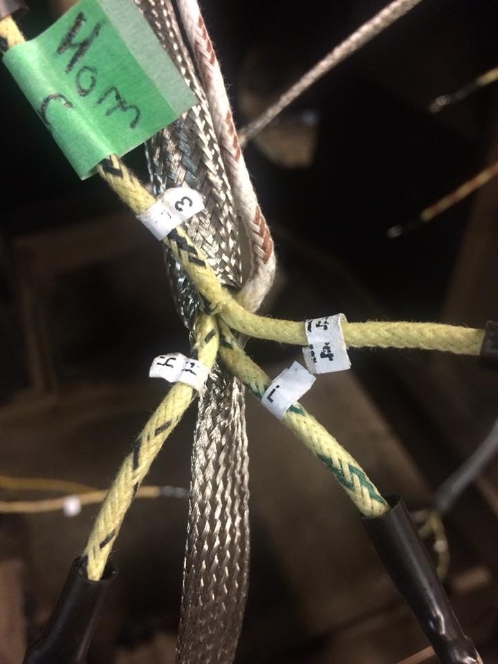

Default From notes-
This past week I have been working away on the front harness.
One question I do have. Do I have the green wires on my drawing correct? That power comes off that circuit overload piece and then the wires split into 6 individual wires going to the inspection lamp socket, dash lamp switch, tail lamp switch, tail/side switch, tail/side/headlamp switch and stop isolation switch?
Hi Jordan
From my notes the green wires in the drawing match my HUP.
But I'm not sure of the stop isolation switch, as I wired that switch different and added a turns signal flasher and a warning light which turned the function of that switch into rear hazard flasher. Brake light always works when peddle is pressed, dash warning light comes on. If the brake isolation switch is thrown, power goes to through the flasher causing the brake lights and the dash warning light to flash. If the brake peddle is pushed the brake light come on.
Your work is so neat, and nicely layed out.

Posts: 4,190
Hi Phil
Thanks for the on my wiring plan.
You wouldn’t happen to remember how you wired in the flasher for rear hazard lights do you? I didnt see it on your hand drawn wiring diagram on your website.

Default Will dig out my noted on it.
Yes I will dig out the notes on it, won't be able to do it until next week as I'm leaving for the Weare Summer Rally which is this week, in the morning.
The change to the wiring is real simple, boils down running continous power to the preasure switch then using the stop light isolation switch to provide blink power to the light side of the pressure switch.

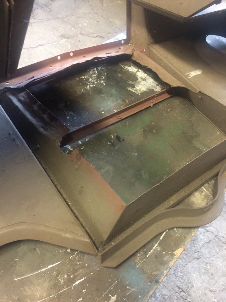

Posts: 4,190
Removing the one bad panel from the nose. A rather poorly done previous repair was the main reason. Globs and globs of brazing with an ugly seam across a flat panel is not a repair. The air hammer made quick work of the wartime spot welds. I also picked up new steel today for making a replacement panel and the air shroud.

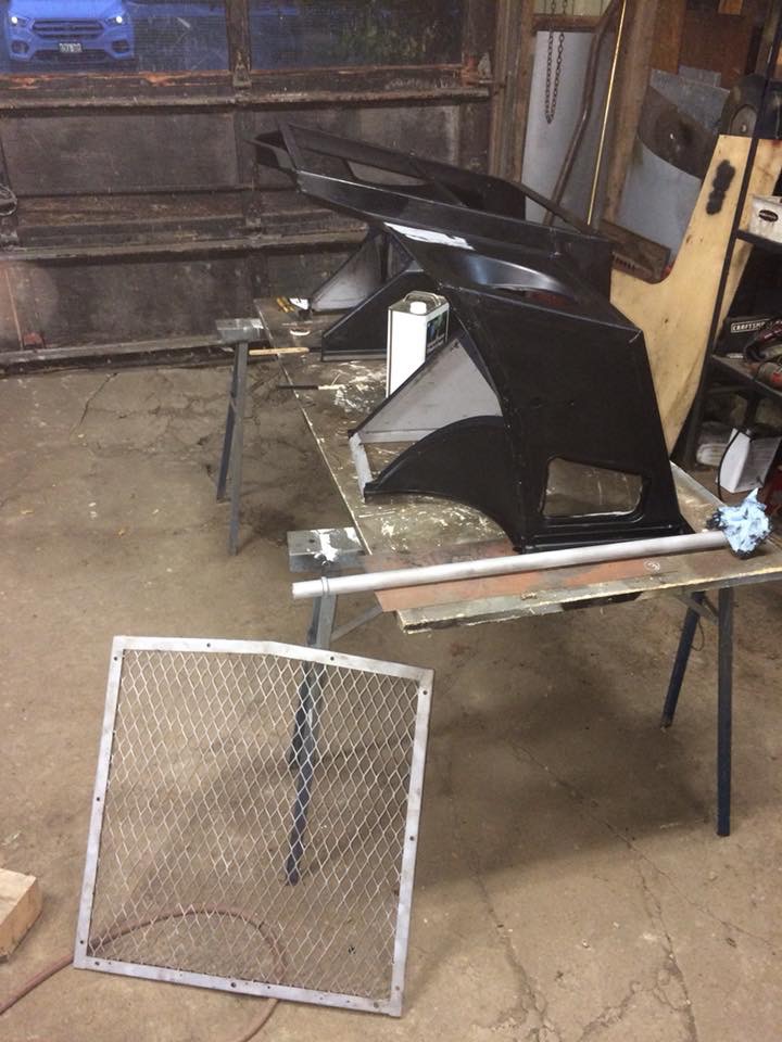

Old 23-10-19, 01:44
Posts: 4,190
Yesterday I cutout and made up the replacement nose floor panel. I also picked up the nose, hood, grill and brush bar from the sandblasters. I started painting the POR15 on the nose. With all the seams, I decided to hand paint so I could ensure that POR got into them. Spraying would have been difficult trying to fit my sprayer in.

Old 23-10-19, 15:31
Default Tie Coat ?
Hi Jordan
My experience, several years ago, with POR15 as a base coat was that had to have the special Tie Coat primer used over it to get primer and top coat to stick. But now when I check the Por15 web site https://www.por15.com/All-Products-Category does not show it. So I'm left to wonder if they have changed product? Will watch with interest how you proceed.
  #659
Old 23-10-19, 15:38
Posts: 4,190
Hi Jordan
They still make it. Just changed names to High Build Primer. Still uses the same part number.
