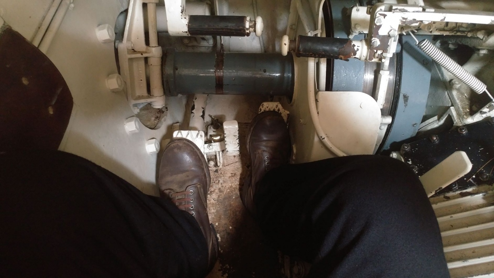

This is quite specific and I dont expect a flood of responses , but we have just acquired a nice restored Jagdpanzer 38(t), aka Hetzer, thanks to a rather wealthy benefactor.
It has a Wilson preselect gearbox, like a Ferret, or more correctly, a Praga-Wilson preselect gearbox. It has the same left hand pedal, similar to the gear change pedal on a Ferret. But what interests me is the gearbox is bolted directly up to the differential with no evidence of a fluid coupling like a Ferret, or a clutch.
It seems that, unlike the Ferret, the gear change pedal has two functions as it rises from the hull floor, first it engages the gear selected, and then clamps the band around the drum. This clamping serves as the clutch engagement. I say this because when you come to a stop, you have to depress the pedal and select neutral to prevent the engine stalling, unlike a Ferret.
Anyone any insight? Manuals for WWII German vehicles are damn near unobtainable.
Another thing I thought was interesting: the steering and brake drums are fully exposed. You can see the steering band clamp around a steering drum when you pull back on one of the (horizontal) tiller bars, and you can see the drum stop, confirming you are getting the designed steering radius for whatever gear you are in. The trouble is the steering radius is horrible, even in first gear. It's an extremely unmaneuverable vehicle. Much worse than a Sherman, and they're not great. And no neutral turn. So to aim that gun, you had to drive forwards or backwards. I can see the desirability of setting it up to fire down a bottleneck for oncoming tanks to keep you in the narrow 16 degree traverse range of the gun.

this is in response to the question about turning in the 'Hetzer'. i have had the pleasure of driving both the Hetzer and Shermans. i don't have much on the technical information of the wilson gear box but i appears as though it's being covered. the Hetzer in question is owned by the American Heritage Museum. it's quite a good runner and very nimble. i my opinion it's as maneuverable as the Sherman all day. the Hetzer has a 2 stage steering. trying to remember how it goes but i believe as the steering controls are set to high speed turning normally and when engaged the steering has a much tighter 'feel' and turns much more responsive. the Hetzer was originaly from the Littlefield collection. it started life as a G13 and was converted back to war time configuration. it has the 6 cylinder petrol engine and 5 speed gear box. i've included some pictures. if you look at the steering controls you will see a button that gets pressed with your thumb to engage the hi/low steering. a side shot of the transmission and drivers postion. last up, me driving and a shot of my truck with my ford.

Originally Posted by Tobias Weibel View Post
Hi at all
I'm happy to help.
Unfortunately, my technical English is not so good. That's why I can't argue with you.
The two items were on the drive end of the engine are an flywheel and the safety sliding clutch
safety sliding clutch:
Are the Brake Bands new?
It is very important that the brake bands are adapted (grinding)
Tobias, thanks again for the new schematics.
I find it quite humbling that so many Europeans, like yourself, are quite fluent in
English, yet we British and North Americans are hopeless at European languages. Thank God for Google Translate.
I don't know the condition of the brake bands but they do look new. And if you are referring to grinding of the brake drums, no, I dont think they have been ground, they look a bit scored.
Malcolm
