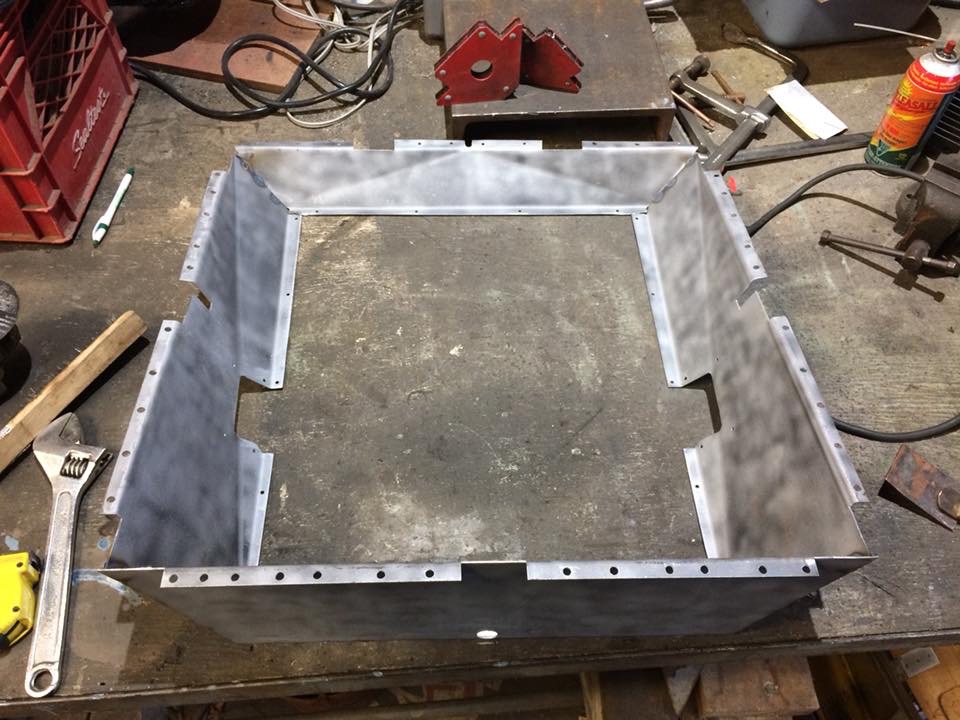

Old 29-10-19, 04:53
Posts: 4,189
Big thanks to a fellow MLU’er for taking the time to draw up the nose shroud for me. I’m now able to make a brand new one. I managed to make up the top and bottom parts today.
I also took advantage of the very nice weather today and got all the nose parts sprayed that lovely light hue colour.

Old 01-11-19, 23:52
Posts: 4,189
The nose/cowl shroud is coming along nicely. I finished cutting out and bending up the two side panels today. Now I just need to do some final fitting and welding them up.

Old 03-11-19, 03:59
Posts: 4,189
Sandblasted and all welded together. Now to get it welded into the nose and painted.

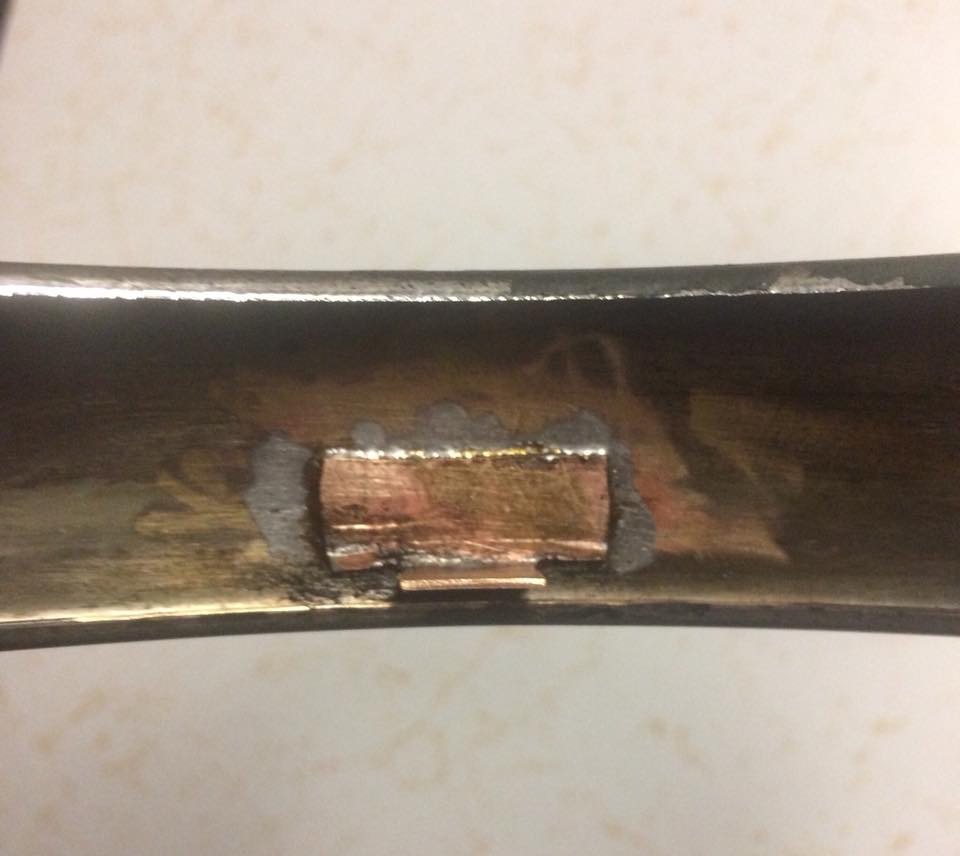

  #684
Old 13-11-19, 02:14
Posts: 4,189
I also fixed an outer headlamp ring. Now I’ve got both that I needed. The upper clip had broken and also separated from the ring. The original on this sample was made from brass and that’s what I made a new one from. It was then soldiered in place.
