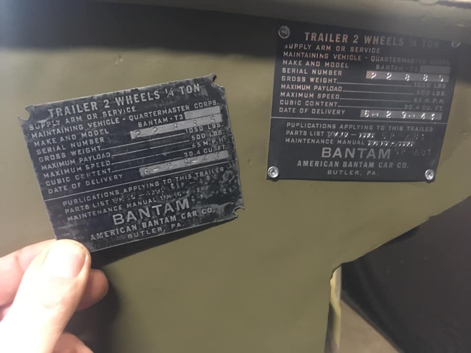

Bumping this back to the top with a couple of questions on a Canadian used Bantam T3 Trailer
We are just about finishing a full nut& bolt restoration of Bantam T3 #22885, DoD 29th June 1943. Body Box number is 52902.
The original dataplate clearly shows that it had been delivered to the Canadian Defence Forces (the US manual lists have been crossed out and replaced with Canandian info), and the trailer still had the longer heavy duty springs with relocated spring brackets and gussets , the tandem trailer triangle kit and the holes for the tandem trailer receptacle box at the right rear corner of the body box. So it was restored back to these Canadian specs...
Only things left to do now are new tyres, shocks, a final coat of OD on the inside of the box and applying the CX number on the rear panel.
Since there are no official lists for the CX number, we chose number CX4252902, as most numbers I see on original photos start with CX42 and added the box number 52902 to come up with something that looks good…
Now for my questions…
1. Since this trailer was delivered with a standard US Army type dataplate which was then altered to Canadian specs and not the plate with the Canadian manual numbers directly printed on the plate; would it have been delivered with a blue drab U.S.A. registration Number on the rear panel, only to be covered with the CX number?
2. When applying the 4" CX number, what would be the best location, seeing that it doesn't fit between the rear reflectors? centered on the rear panel as shown on my photo? Or should I use 3" stencils?
3. Would it have had unit markings…? Jeep which will generally tow it is marked to the RHLI, 2nd Division.
Will post more photos once all is completed!
THANKS!!

Johan, the big question is do you plan to oil down the bodywork once the restoration work is complete....?

Hello Johan
I hope that you have not painted the markings on yet.
Your original WD is CX5712917
I do not have the unit it was attached too.
The WD number was across the back and the front of the trailer. It has been seen along the bottom, middle and top left on the rear in both as original stencil and filled in.
With the larger springs your trailer was converted to 10CWT.
It is unusual that the data plate was re-stamped.
Hope this helps.

Thx, Eric...
Havent marked it yet!
How about a possible USA number because of the restamped plate instead of a pre-made plate with Canadian info?
I will try to make out the size of the stencil from your original photo above
Johan

Here it is...
Will stencil the correct number next weekend...
Only thing left is better tires...

I have got one with towing hook , with bigger springs , but hangers are also then on another position .
On mine there where never holes drilled for the electric socket box , on another ex Canadian one I saw there was also no hole for the socket box.
Thanks Maurice, yes the spring hangers have been moved forward and backwards about 3-4" to accept the longer spring packs
