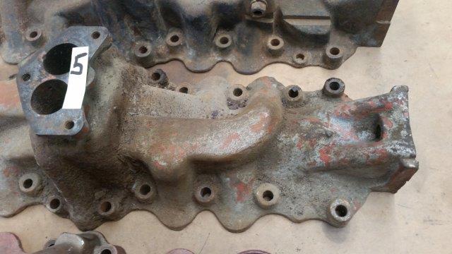

Anyhow, I have 7 flathead Ford V8 inlet manifolds. see photos.
I have numbered them 1 through to 7
1,2,3, have carb mounting flanges that look like they would suit 97 Strombergs?
4 is a special unit. Part# C29SR 6520. More later.
5,6,7, have the Holley style carb mounting flange. For those not sure, the carb stud arrangement means all the carbs fit all the manifolds.
1,4,5 are cast iron, the rest being alloy.
1,2,3,7 have the blanked off forward oil filler hole.
6 is from a post war 8BA.
1,5, I cant find a part number, both being similar except 5 lacks the forward oil filler hole.
1 is drilled for positive crankcase ventilation 5 is not.

The 1941 Canadian carrier parts list shows a Cover, C11A 6520-B cast iron. I dont know what they look like.These must be fairly common still, in carriers. Do they break?
THe March 1945 British Chilwell (Carrier parts list)63/76 lists a:
Cover C11A-6520-C I have 3 of these (2,3,and 7) They have 2 big ribs running to the front flange. Do these break?
As it happens I have the C29SR manifold that I previously mentioned. It is from a Lynx and is a very robust looking manifold. Was made to support a massive (lets do some arc welding) 90 amp generator. It has the ability to have suplimentary support brackets as was the case with the big generator. This would (hopefully) limit the failures to all the components forward of the manifold (cover)
Can anyone come up with a part number for my two other cast iron manifolds (1, and 5)
I have put up pictures of the big generator from the
Lynx along with a std. Canadian generator/ fan extension to show the comparison along with one of the un identified manifold and the C29SR.
Thank you and stay safe.
