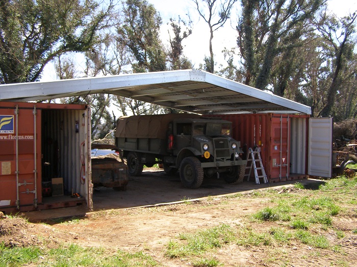

If you are going to have two twenty footers, for a few hundred extra you could have this dome. A lot going cheap at auction (commercial grade) at the moment.
Or you could give them the finger and just put up the little structure in the first photo'

If you are going to have two twenty footers, for a few hundred extra you could have this. A lot going cheap at auction (commercial grade) at the moment.
Lang
Hello Lang,
While they are a very good idea - I somehow doubt they would fit into the Council's definition of aesthetics. It would a bit hard to meet the Council requirement of: so as to screen the structure from neighbouring properties . It would take some big mounds of earth to screen those examples Lang!

As Rob said they have two designs, the one I used is fixed at 10deg pitch. Their maximum span is 22 metres.

Hello Rob and Robert,
Firstly, thank you Robert for posting the photographs so quickly.
Thank you Rob for posting the link to the cover people. Good to know that they can span 22 Metres. It is a shame the mobs do not sell plans. I suppose things like cyclone ratings make things more complex than a one-size-fits-all drawing.
I visited Rob's link and butchered one of their drawings using Microsoft "Paint" to mock up a possible style. The second container located 14 Metres away would be a mirror image. Their design featured two containers side-by-side.
Anyway, I have a Land Rover ex-Army 2A Ambulance motor hanging off my trailer crane while I sort out the engine stands fixed wheels and change them to swivels. Then it is a little trip from the shed to the container to make some more space in the shed.
Kind regards

https://www.podroof.com/au/examples/
This is the company I used, I didn't find the one Rob linked.
