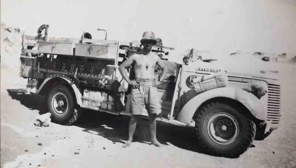

I must be off my rocker for getting into a new project, but here I go... I just managed to purchase another 39 (1.5) ton truck with an open cab, which maybe gives me two options for a recreation...
Name:	DSC_6861 - Copy R.jpg
ID:	114049 Click image for larger version
Name:	DSC_6899 - Copy R.jpg
Option A first photo, My questions are, what is the wheelbase of that truck...Could it be 158"? like my new rig... Sure looks longer than the second photo... What are the bed dimensions??
or option B, second photo... This time I don't have a cab, the right rear fenders are correct, but the truck is not the right wheelbase! Grrrr.... A real pickle!
Lastly, are the bed dimensions on B truck the same as the bed of the third photo? Thank you.

Hello Hanno,
Fire enthusiasts had 30 years to do something about this beast... As far as I am concerned, I saved it from the scrap pile and made a lady very happy for getting it out of the side of her house...
Thank you very much for re-posting the old topic... I wish that is was a shorter wheelbase or a 1 ton, I would definitely do the Indian pattern 1311x3; but it is 158-1/2" (1.5 ton) truck similar to the radio/survey truck posted here... Somehow, I will have to figure out the size of the rear box...Wish I could find photos without the rear carvas...
I don't even have the dimensions on the cargo bed from the IWM truck... It would be good to have for reference...
Hello Philippe, I looked up the specifications for 1940 model Chev trucks: the WA is a 133" w.b. 1-1/2 Ton Truck with Single or Dual Wheels. If you want to make a LRDG WA, shorten your fire truck's wheelbase. It would be my guess someone has take the cargo box dimensions off the IWM's preserved example? I'd guess (again) you are in touch with the LRDG reenacting community in the UK.
The WB is a 158-1/2"w.b. 1-1/2 Ton Truck with Single or Dual Wheels. This was one of the chassis with cowl and windshield supplied to India, where they fitted a cab plus cargo body.
If you retain the wheelbase, the Indian Pattern WB is certainly an option and Davistine Liddle may help with body dimensions off his Chevrolet. This forum contains multiple pictures of this so-called "Bombay Chev".
