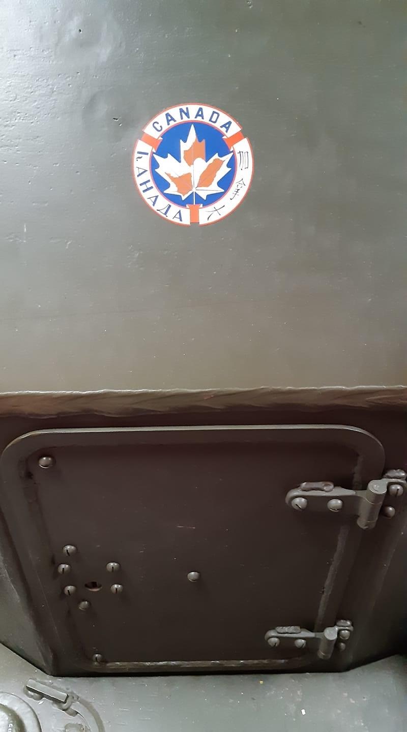

Old 27-06-20, 22:42
Mike Gurr Mike Gurr is offline
Join Date: Dec 2015
Location: Surrey, United Kingdom
Posts: 192
Hanno,
The decal on my Carrier is 3" diameter. From the centre of the decal to the rear edge of the armour is 36" and centre to top of the side amour 12". Although the Carrier has been painted green over the original brown it seems that the original decal has always been painted around.
Mike Gurr
1944 Matchless G3L
1944 No2 MK2* UC
10 CWT GS trailer
1944 BSA M20
Royal Enfield RE125 'Flying Flea'
