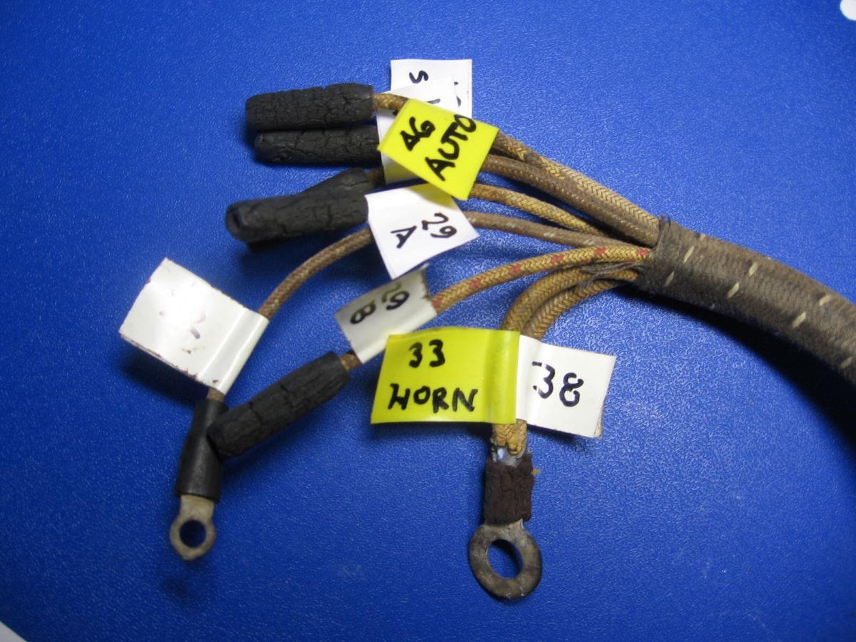

I have attached a photo of a NOS wiring harness with No. 46 Autopulse wire included. All wires have been traced and marked and there is no No. 45 leading to the starter solenoid area. No wires appear to have been cut off or removed from the harness.
According to Parts List it is *C29QF 14403- Wiring Assembly- Horn (used with new design cab)
It terminates near the starter solenoid so a short tail would all that would be required to connect it to the Autopulse.
This is what has thrown me that the wiring diagram list of wires infers two wires to the Autopulse.
My apologies, Phil, for hijacking this thread but hope it is of interest. Perhaps Hanno can migrate it to the Snakes Alive thread.
