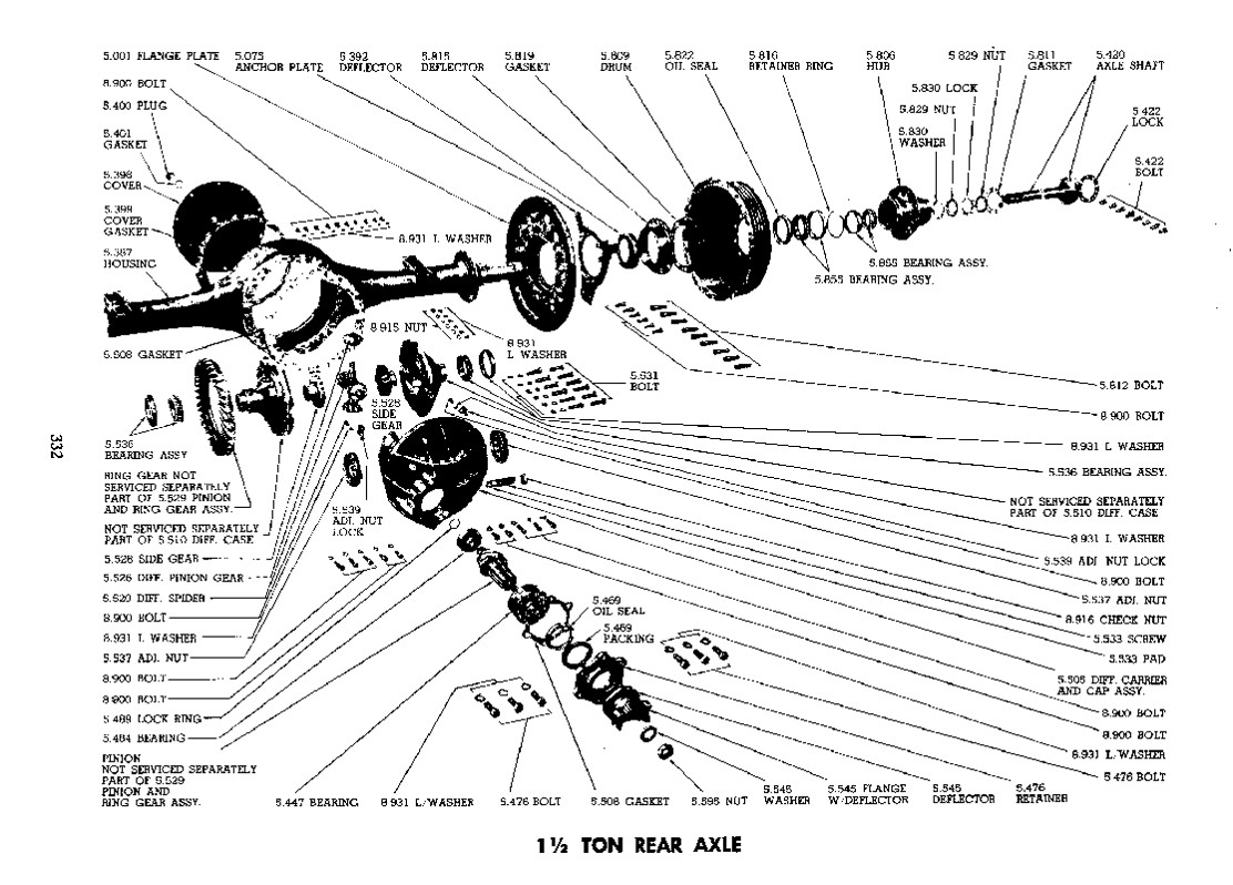

Default 2 Speed Axle
My research has led to a website http://chevy.oldcarmanualproject.com/index.htm
which has lots of old manuals on it.
I have attached illustrations showing exploded diagrams and parts lists of a 2 speed differential, a standard axle for comparison and diagram of the linkage to the cab although it doesn't show the cable connector to the speedo adapter.
Its not clear to me whether the 2 speed unit bolted on to replace the conventional axle differential casing at the front of the axle, or it came as a complete replacement axle. I haven't yet found a good clear photographs of either axle for comparison.
The front axle was 100mm wider than the normal axle to allow for the extended fenders and sand tyres. I presume the rear axle would also be extended. Would this be a new axle, or would they just have extensions to the standard axle?

There’s a lot of info to be found on the Eaton conversion. But where do we find documented proof of the assumption/fact that the 1533X2 was fitted with a 2-speed Eaton axle? Is it only the handle in the cab?
Would there be a need for a 2-speed axle? Or would the LRDG have more benefit from a limited slip differential as fitted to the CMP C15?

  #139
Old 17-08-20, 00:26
The Eaton 2 Speed diff was a very widely used diff in both military and commercial trucks from the 1930's right up to today. Methods of engaging the diff have ranged from a lever and solid rod, cable, pneumatic and electrical controls. During the war, they were fitted to Chev, Ford and Dodge vehicles in large numbers.
The adapter is a necessary part of the installation. The drive for the speedo cable, and therefore the speedo and odometer comes off the gearbox and is geared to read accurately when the diff is in the "High" ratio. When the "Low" diff ratio is selected, the gearbox drive will still be reading the higher speed for a certain gear/rev range. The adapter is switched with an actuating cable from the lever, and reduces the cable speed by a similar reduction ratio to the diff (which I understand is a reduction of 39%, ie a ratio of 1.39:1)
Eaton 2 speed.JPG   adapter1.jpg   stewart warner speedo adapter.jpg   adapter2.jpg
