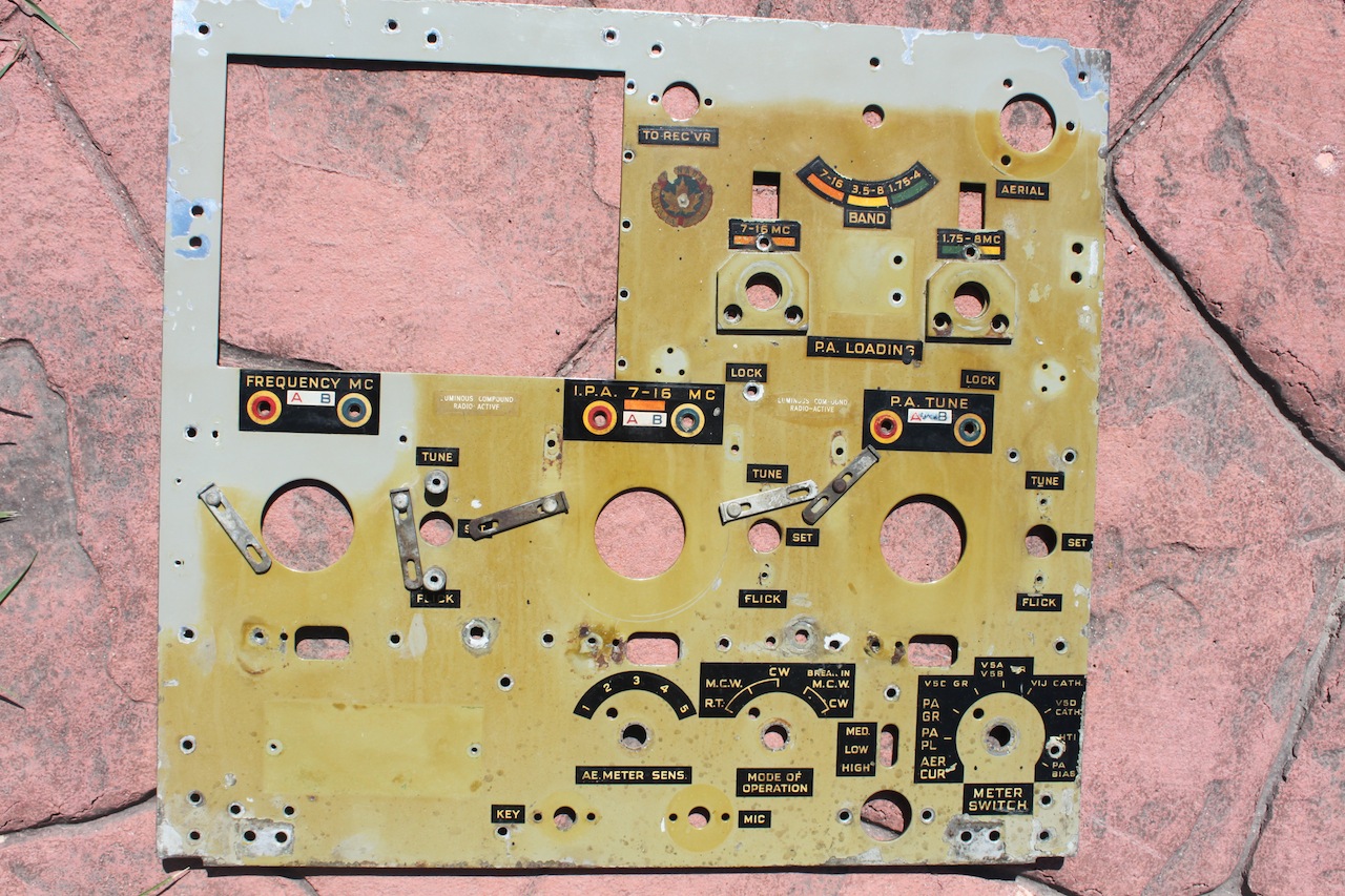

Well the Doors assembly is now ready to go in for a colour match.
The most challenging bit of physical restoration of the entire 52-Set Project has yet to be started. The second photo today shows just exactly what I have ahead of me. Still some thinking to do about the approach/process needed and I am sure whatever I come up with will get modified on the fly, as soon as I begin.
While I think of it: the PA LOADING decal between the two dial reinforcing plates is the one with the big blob of crud covering most of the letter ’G’ at the end of the decal.
I dunno Dave...faced with that yellowing it might be easier to just get a new face panel from stores...

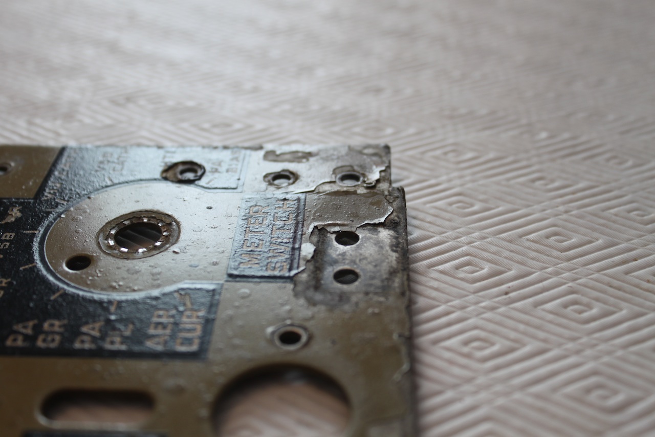

For a number of weeks now, I have been hesitant about starting the clean up of the Sender front panel. This centres primarily on the lifted paint. It basically consists of two forms of lifting: some has lifted and stayed flat, other bits have lifted with a curl. The attached photos illustrate some of the latter.
Flat lifted paint is relatively easy to deal with as it is generally fairly tolerant of pressure being carefully applied to it, as will happen with cleaning and polishing, and it can be reattached to the metal panel plate with a little Crazy Glue being wicked under an edge. Some bits you can clean first, others may need to be reattached first, but the process is fairly straightforward, though slow.
By comparison, lifted paint that has curled is a nightmare. It can be snagged by almost anything and get torn loose with no guarantee at all about how large a piece will break free. With no support under the lift, any downward pressure will snap it free with the same unknown result. You can get glue under it easily enough to support it for cleaning and polishing, but you must be prepared for the fact these imperfections will then be permanently visible on the panel.
I had initially thought of using a heat gun to soften the paint gently in order for it to relax enough to be pressed back in place and be allowed to cool flat enough for the Crazy Glue treatment. I am still confident the concept would work on a panel that was a simple, painted surface. The big negative on this Sender panel, however, is the large number of original decals still present and in close proximity to most of the curled paint bits.
I have absolutely no clue what type, or thickness, of clear substrate was used for these 75-year-old decals. Same goes for the glue used on them and the whole process of bonding decal paints, luminous paint pads and paints. The odds are extremely high they all have different expansion and contraction characteristics under a high heat load and with that many unknowns at hand, I am going to forgo the use of the heat gun.
After studying the paint for some time now, it is evident one can rank the condition of it from ‘best’ at the top of the panel to ‘worst’ at the bottom. That does not eliminate surprises from the project in the least, but logic tells me to start at the top and carefully work my way across and down, adjusting techniques and processes as I go. My fingers seem to have survived cleaning the Sender Door assembly just fine. I will just have to continue to proceed in baby steps and the first ones will start today.

The cleaning of the Sender front panel officially started just over two hours ago, only five minutes of which was used to take the two attached photos.
One small section was cleaned, top left corner above the door cutout. On the good side, not one small chip of paint was lost. On the bad side…that was a lot of work! Here’s why.
Take a close look at the second photo, at the junction of the now re-exposed original Gloss Navy Grey paint and the varnish topcoat. At the leading edge of the varnish, notice the thin band of lighter varnish? That is the original wartime varnish topcoat. It is a thin and consistently even application of varnish. The darker stuff is the varnish coat that was applied in the 1960’s and it is one horribly, sloppy job! If you take this panel out into the sunlight and move it around, you can actually see various shapes and sizes of spray gun patterns where the varnish was applied. Some are thicker than others. Some are almost at the point of going ‘orange peel’, and all of them were applied over everything on the panel! Dirt…dust… missing paint…everything! If you look again at the second photo, you will see a light coloured line in the varnish wandering roughly left to right from the midpoint of the transition line between the Gloss Navy Grey and the varnish. THAT, is a run in the 1960’s coat of varnish. There was not proper spray paint technique used at all. It was a simple ‘aim and spray’ at various points over the panel.
What makes this varnish work even sadder is that only two new decals were applied to this panel in the 1960’s overhaul: the two white “LUMINOUS COMPOUND RADIO ACTIVE” decals seen between the red and blue Flick Indicator Decals. And these decals are incorrect. None of the paint is radio-luminous. It is all phosphor-luminous.
A good three quarters of the time spent on that small section was simply cutting through the top layer of varnish. Once it is out of the way, the wartime layer polished back very quickly.
The nice thing about the polish I am using it that it leaves a thin coat on any bare metal surfaces, which helps keep rust at bay until the entire panel is done and touch up painting can begin. A cloth with warm, soapy water takes the polish of easily and then all those bits of metal can get a coat of primer, ready for the paint build-up process to begin.

  #348
Old 18-08-20, 20:31
Posts: 3,720
I had a box of Danish for breakfast this morning, so was feeling a bit energetic today. The left and upper surround of the Blower Door opening is now cleaned.
Interesting to find some touchup work done to the paint early in this Senders career, and another bit of good news showed up as well.

A nice sunny morning today so a little bit more of the panel has now been cleaned. Progress slows quite a bit when you get in between fittings and decals, and add that to the sections that are so heavily coated with varnish.
Took a bit of work but the erroneous decal under the door cutout did polish out. The white paint came off the top quickly and then a yellow rectangle remained where the backing of the decal had covered the original wartime varnish. Once I broke through the decal backing, the original varnish polished back very easily.

A little bit more done down the right hand side today.
I think I am getting close to the halfway point for this polishing now.

Old 25-08-20, 19:54
Posts: 3,720
Now finally at the point of just over half the front panel having been polished clean of discoloured varnish. The second incorrect decal warning of radioactive luminous paint is gone, and of 30 decals on the front panel of the 52-Set Sender, 10 are now standing free and clear of discoloured varnish.
Slowly we make progress!
