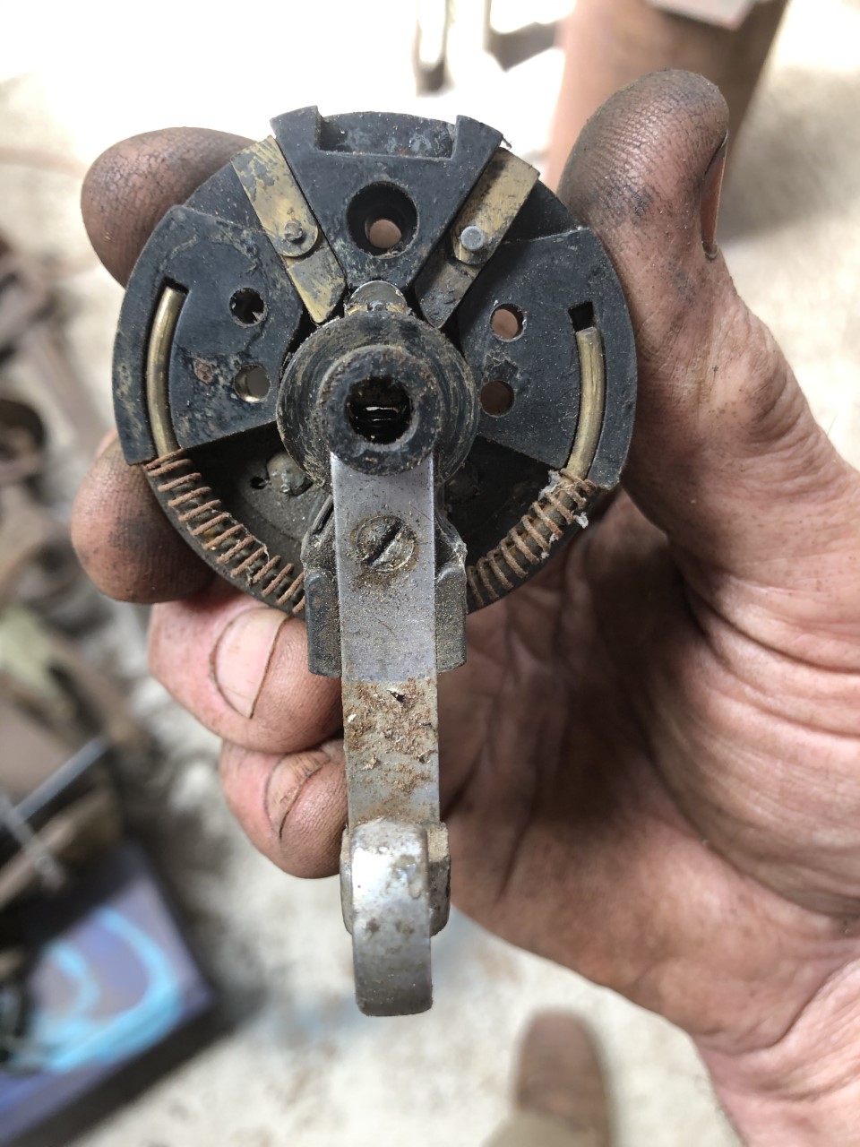

Next was to disassemble the switch itself. Apart from being dried out they were both in relatively good condition and after cleaning and attaching new wires, the loom was rethreaded through the steel tube and installed. A very fiddly process to rebuild the whole set up but it all appears to operate very smoothly.
With the rebuilt steering wheels Chris had done it all looks pretty good.
thumbnail_IMG_1831.jpg   thumbnail_IMG_1826.jpg   thumbnail_IMG_1832.jpg   thumbnail_IMG_1833.jpg   thumbnail_IMG_1837.jpg

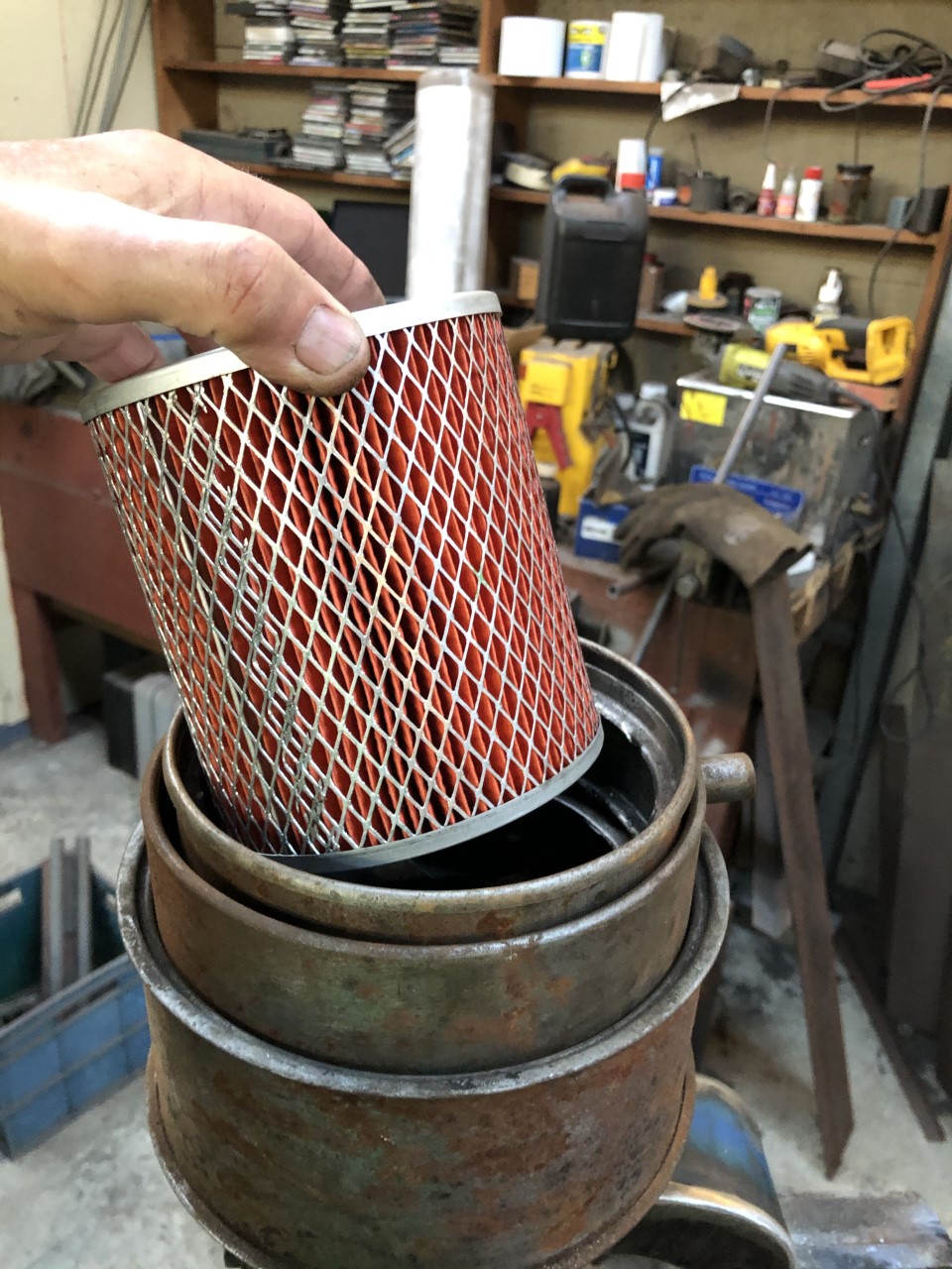

The other thing we decided to do was ditch the oil bath filter in favour of a paper element. Once the oil bath setup was gutted it was a simple matter of measuring up to find s suitable paper element.

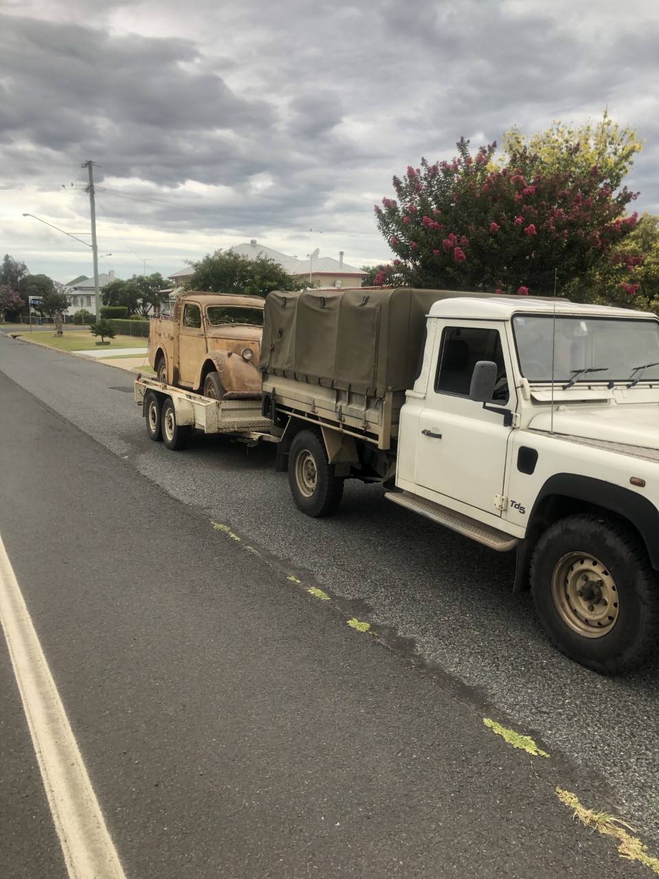

Well last week I did a lighting trip (four days, 3500km) to pick up this little dude. He will be a thread of his own but being so original and complete, should be a simpler story than this Tilly but is already providing a wealth of genuine original and more importantly very accurate data.
thumbnail_IMG_2070 (1).jpg   thumbnail_IMG_2072 (1).jpg   thumbnail_IMG_2073 (1).jpg   thumbnail_IMG_2077.jpg   thumbnail_IMG_2078.jpg

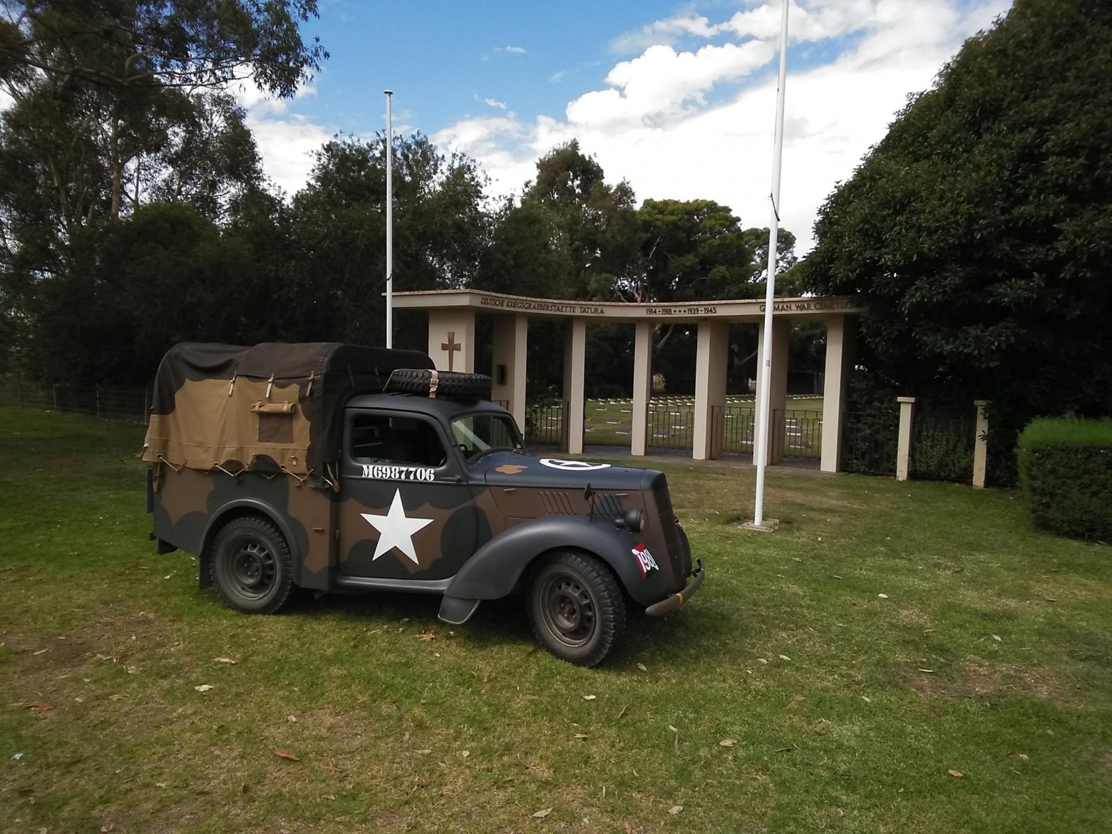

Scrappy the Tilly has hit the road coming up to two years now, Shes not what you'd call fleet of foot, gets a bit hairy over 45 MPH, and sits pretty comfortable at 40, much to the frustration of the average Aussie road user. We've taken her to Corowa twice first time via trailer, the second time an Epic two day one way journey from her.
the first set are getting The Scc14 on, and the Tillys first outing a road trip from Geelong to Winchelsea via Inverleigh, Cressy, Lake Bolac and home again, some slight issues with the Dynamo, and a leaky oil pump but we got her home.

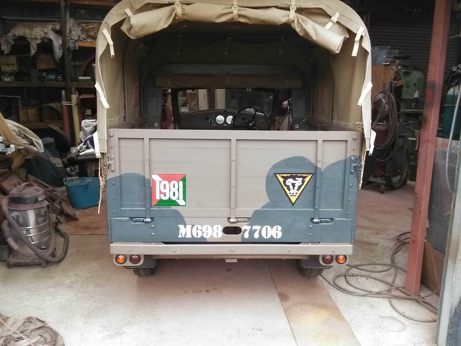

We painted Milly up just like early well known late war photo of a Morris Tilly in a RASC unit in 79th armoured Division.
272887792_4521186278008092_947622516581172102_n.jpg   272888189_4521186451341408_5821834613499021757_n.jpg   273015263_4521186121341441_44385674507508843_n.jpg   274647737_4606719252788127_7704317617471528995_n.jpg   274649525_4606719799454739_6330465187788922225_n.jpg
Military re-enactor and modeller

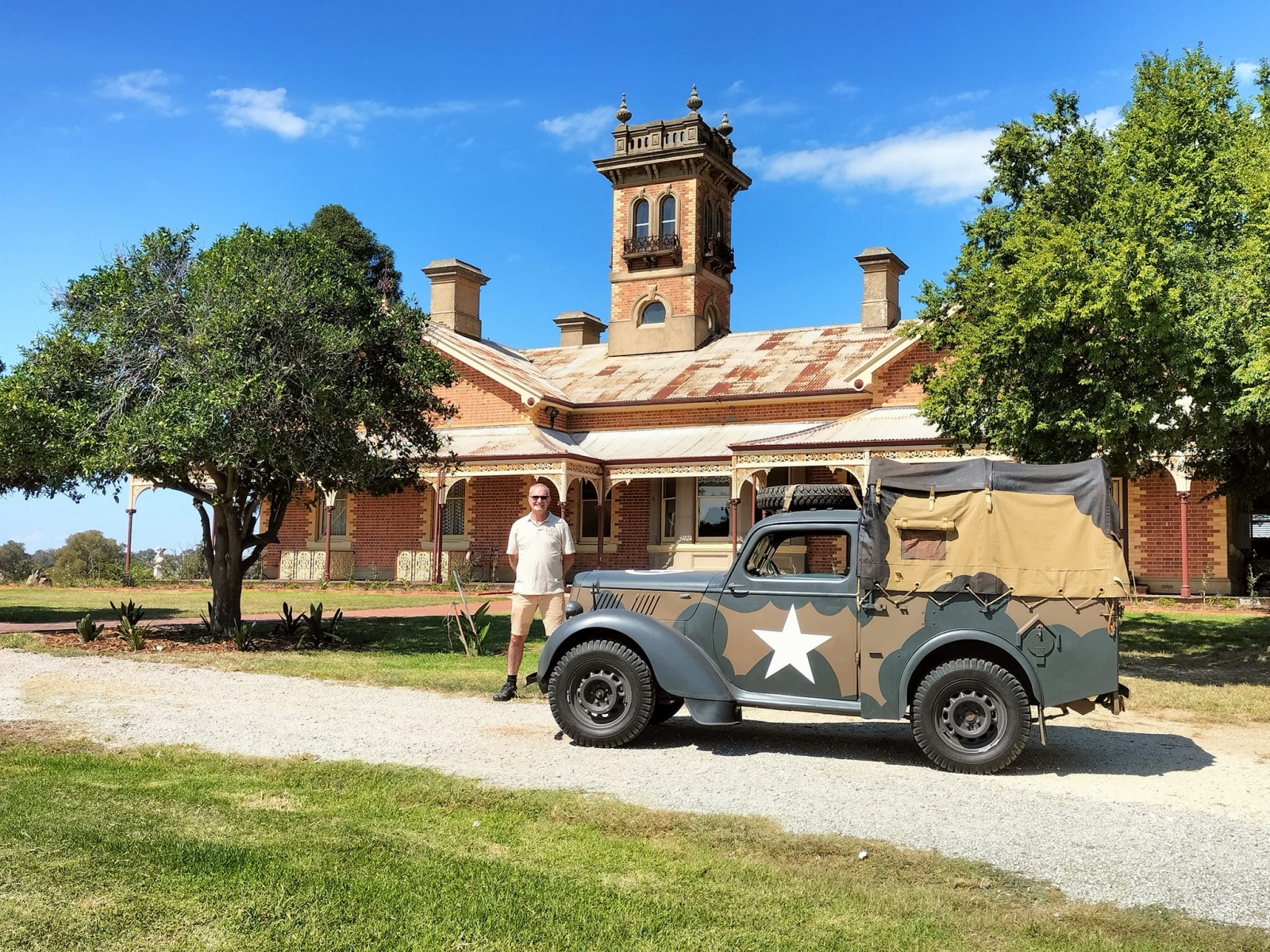

We trailered it the first time, and Greg had a grand time tootling around northern Vic, My wife and i joined them and we took Scrappy out to Olive Hills estate Rutherglen, and took some great photos outside the homestead.
we even took out Peoples Choice, amongst a sea of Jeeps!

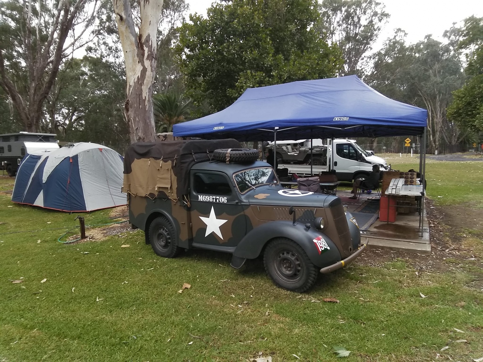

The second outing to corowa Greg and I Drove Scrappy up from her current Home at Bacchus Marsh, to Corowa, the back way via Gisborne and heathcote staying overnight at a pretty sketchy caravan park outside of shepparton sleeping in swags, We stopped at the Cemetary where 250 Kriegsmarine POWs are buried, and viewed what can be made out of the POW camps near Tatura.
It was a great week!
Greggy has even been brave enough driving scrappy to his hometown of somerville, though the sprawling metropolis of Melbourne and back again a few times to attend his local ANZAC day services.
331872570_624100339529221_396686901674776102_n.jpg   333535910_587007413348403_5324787349424590379_n.jpg   333911607_514620554210500_4783072298419552138_n.jpg   278965010_4756990334427684_3465156734517247133_n.jpg
