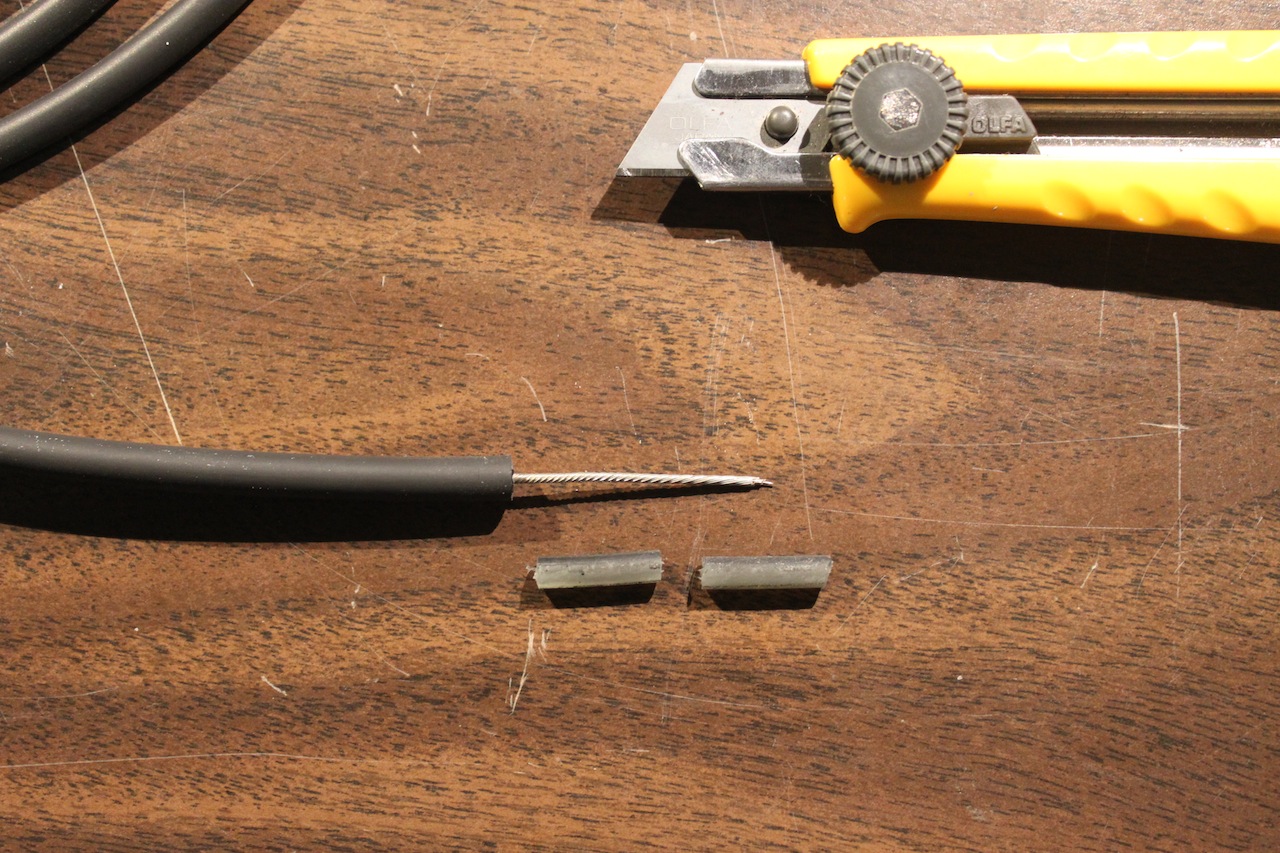

I was able to move forward on both the Reno and this sub-project today.
The sub-project was broken down into three steps, the first step was the one completed today, and for a variety of reasons it was the most important as it put a number of assembly theories for this LEADS to the test. All have passed so far.
The first thing was to measure off 1-1/2 inches back from one end of my piece of 7mm rubber sheathed, braided copper core HT Cable, and tape that point off. This is the start of the process to get that measured length of the central copper core exposed to pass through the tip assembly of the LEADS.
Once measured off, I used a thin. Blade cutter to slice through the outer rubber sheath of the cable at the edge of the tape. I then made a longitudinal cut from the circumference cut at the tape to the end of the cable and peeled off the rubber sheath to expose the inner insulation.
I was lucky the inner insulation was a soft clear plastic product that when cut into carefully, the insulation could be carefully bent at the cut and it would slowly split by itself to the inner copper core. I removed the insulation in two sections as shown to make it easier to slide the insulation off the copper core. As I removed the second section of insulation, I slowly twisted the insulation in the direction of the stranding on the copper core to tighten up the core wires as much as possible. I wanted to do this so it would all easily clear the pin assembly as it passed through it.

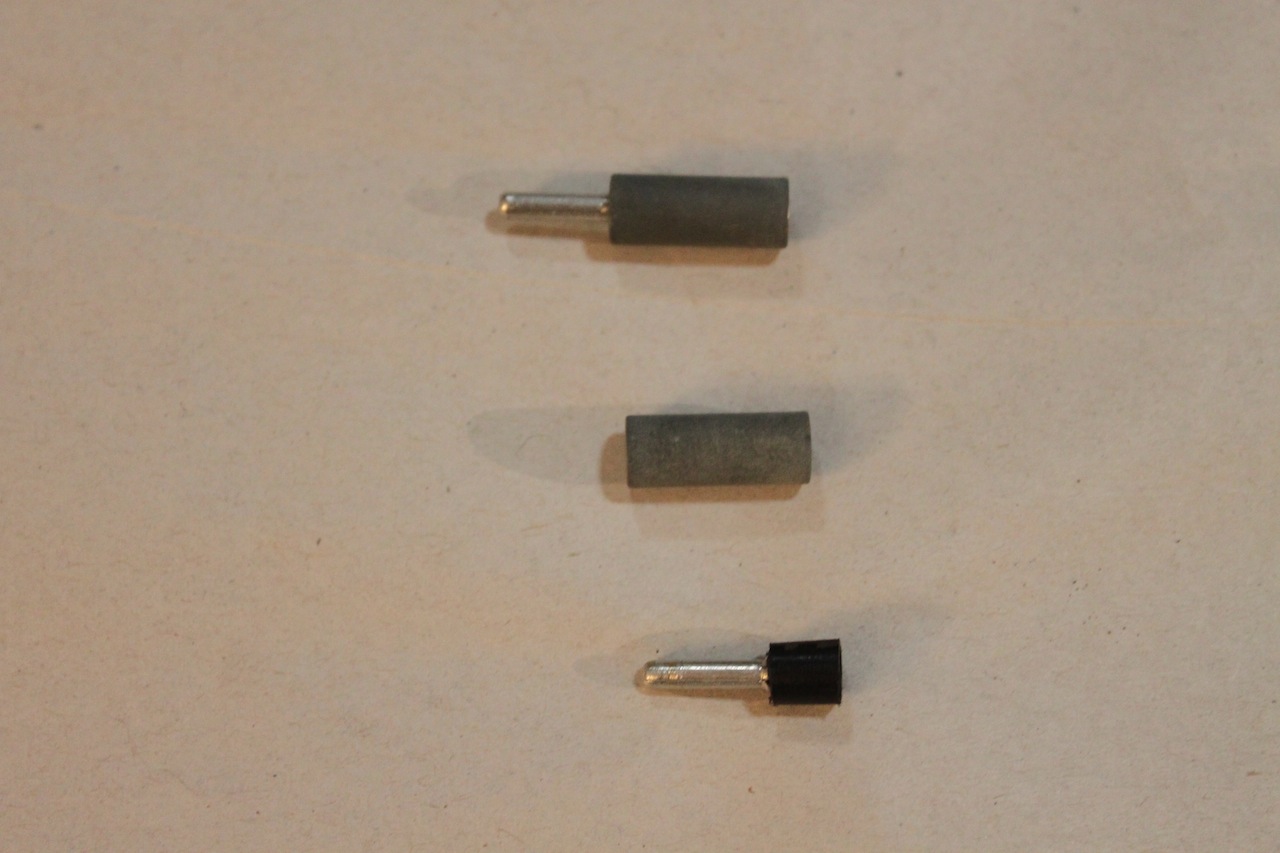

The next step was to insert this end of the cable all the way into the pin terminal I had fabricated.
LEADS, Aerial 25-3:4 inch Project 21.JPG   LEADS, Aerial 25-3:4 inch Project 22.JPG   LEADS, Aerial 25-3:4 inch Projecr 23.JPG   LEADS, Aerial 25-3:4 inch Project 24.JPG
  #544
Old 07-03-21, 22:44
Posts: 3,720
Once the cable was in the pin terminal assembly, I pulled it all snug with my fingers and then bend the copper core 90 degrees over the tip of the pin to secure the cable at the inner end of the pin terminal assembly. The pin is a nicely rolled tube and I made certain the core was bend 180 degrees away from this rolled seam. I wanted to take advantage of that seam for solder to wick down the full length of the pin to ensure a solid bond between the copper core wire and the inner wall of the pin. You can see that slot facing the camera in the first photo.
I then placed a small ring of solder round the base of the pin at the front end of the sleeve with the cable held vertically in a small bench vice. My plan was to use a propane torch for the soldering rather than an iron, to avoid any lateral load on the pin from holding an iron to it to heat the pin. I did not want the pin ending up on an angle. I also had to ensure the base of the pin was firmly soldered to the metal sleeve assembly for maximum pin stability. This would also make the pin terminal ‘hot’ electrically, just like the originals were.
When I heated the tip of the pin with the propane torch, I could watch the small solder ring at the base, as soon as it melted, I could remove the flame from the pin and add solder to the tip of the pin to secure the copper wire core inside it. I could also then go back and add more solder to the base joint, if necessary. It worked out pretty slick.
Once the pin had cooled, I snipped off the excess copper wire core from the tip of the pin and filed down any excess solder from the pin and base of the terminal assembly.

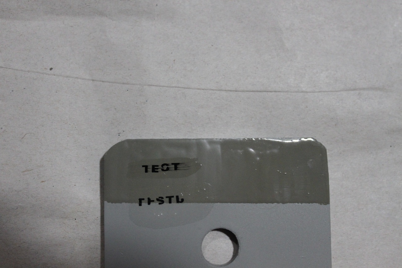

As mentioned in Post #543, there are three main parts to this Sub-Project. The first part, now completed, was to fabricate the Receiver end of the LEADS, as it was the most complex.
The second part will be to add an Identification Sleeve to the LEADS.
From what I have seen from available photographs, this sleeve is between one and two inches in length (closer to the two end) and in most instances is yellow in colour with black lettering. A few photos suggest there might also be a version out there with a brown resin impregnated sleeve. The yellow one, I think, is early production as the illustrations in the manuals show it with “ No. C7” just legible. The 1948 Update to the Master Parts List shows this illustration but notes the wording on it is early production and should be ignored.
The challenge I have encountered with this ID Sleeve is getting the right size of sleeve in yellow. A 9/32-inch Inside Diameter just slides nicely over the 7mm HT cable for the LEADS. I have been able to source thin wall heat shrink tubing locally in that size, but only in black. I like the idea of the thin wall heat shrink since the actual location of this sleeve in photographs varies from right up against the Receiver Pin Terminal on the LEADS to nearly at the right side partition wall on the Carriers No. 4, between the Receiver and Supply Unit. It is possible it was a lose sleeve in the first place based on the photos, so I would not have to heat it in place. This offers a second bonus. Thin wall heat shrink tubing tends to be much more flexible in its unheated state than post heating, so it would have added flexibility for the large curve the LEADS makes from the Receiver AE Terminal around to the first hole it encounters in the Receiver/ Supply Unit partition on the Carriers No. 4.
So the game plan for the sleeve is to find an appropriate shade of yellow spray paint, cut an appropriate length of black 9/32-inch ID heat shrink tubing and paint it. Once cured, it will slide easily enough onto the open end of the 7mm cable I am working with and I can move it up to the Finished Receiver Pin Terminal end. I can then take my time looking for appropriate black lettering to add to the ID Sleeve,
Once the ID Sleeve is finished and on the cable, I can measure out the correct length of cable to finish this Sub-Project and add the Sender Pin Terminal Assembly to it. The 9/32-inch ID of the heat shrink is too narrow to fit over the 8mm OD Pin Terminal Sleeve, so the heat shrink tube has to be slide in place before the cable can be fully completed at both ends.

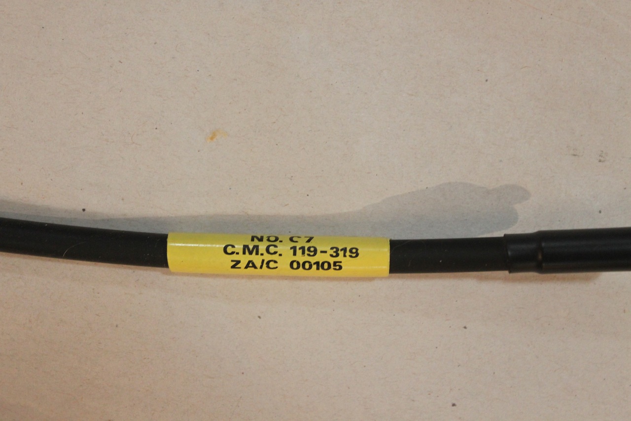

I took some measurements off the Illustration in the Parts Manual and a photo of the complete set in the Operators Manual and dusted off my Proportional Algebra from High School this morning.
From the Illustration, I got a length for the ID Sleeve tucked up against the Pin Terminal Sleeve of 1.20 inches.
From the Photo of the ID Sleeve a bit way up the Leads from the Pin Terminal, I get a measurement of 2.0 inches long for the ID Sleeve. The more I look at these two options, the more I think the differences reflect two, distinct types of ID Sleeves.

Old 09-03-21, 22:26
1-5/8". There is one in captivity...

Metal ends are 1/2" at 5/16" diameter and 9/16" at 1/8" diameter (1-1/16" total, and both ends are the same). Cable is 1/4" diameter 23-3/8" long between the backs of the metal end plugs, so overall cable length tip to metal tip is 23-3/8" plus 1-1/16" plus the other 1-1/16" or 25-1/2" tip to tip.

Fantastic Pictures, Bruce. Thanks for posting with the specs!
Beats me what the original material was the ID Sleeve s fabricated from. It certainly does not look like the typical woven fabric, resin impregnated stuff one usually sees. The Sleeve you have looks very smooth with a consistent solid colour throughout it.
The only cables I have on hand with yellow ID Sleeves that still have a look and feel of rubber or soft 'plastic' are on a pair of CPP-2 output cables and a late issue 19-Set Black Rubber 12-Pin Connector Cable from Set to Control Box.
A 19-Set 3-Lead Battery Cable on Hand has one single cable yellow sleeve and a double wide yellow sleeve on it where the material is hard and 'plastic' feeling.

Dave, it's a rubber or synthetic rubber. Pretty soft, slightly mottled and with a joint molded seam throughout its length. I'd almost suggest modern coax cable although it would be a little too hard and not as flexible. The tag is smooth, glossy, plasticky and brown exterior and underneath. Whether it was originally yellow and faded (more GD tobacco?) I'd need a time machine to confirm.

This little Sub Project has come together rather well, so far.
With the measurements Bruce posted from his surviving Leads, Aerial 25-3/4 inch, I cut a matching length from the heat shrink tubing I had available that just slides over the 7mm HT cable used in the Leads.
With access to shops once again, I checked available yellow paints in the local Canadian Tire Store and lucked into one remaining can of Rust-Oleum ‘Painter’s Touch’, gloss enamel that was a good match to the yellow ID sleeves on my CPP-2 cables. This paint is Stock Number N1945830 and is called SUN YELLOW. All of the other yellows I looked at were too much to the orange part of the spectrum, or the cream section.
The next thing I had to do was paint the sleeve I had ready to go and set it aside to cure. In the meantime, I measured out the length of cable I would need to finish this Leads Assembly off at the Sender Pin Terminal end, hopefully maintaining the required 25-3/4 inch length between the end faces of the two Pin Terminal Sleeves. With the working length of cable ready to go, I could then slide the painted and cured ID Sleeve up the cable from the free end to within about an inch of the insulated Receiver Pin Terminal end. Hopefully it will end up located and looking somewhat like the Leads does in the manual when finally installed.
With the ID Sleeve in place near the Receiver end of the Leads, I was then able to install the Pin Terminal assembly over the Sender end of the Leads. The Pin Terminal Sleeve at this end needed to be carefully crazy glued in place on the cable to prevent it from possibly twisting about and perhaps eventually cracking the inner copper wire core of the HT cable. So it was glue on and the copper core wire pulled 90 degrees over the end of the pin to snug it all down. The cable was then set aside 24 hours for the glue to fully cure.
This morning, I did the soldering at the Sender Pin Terminal end of the Leads and cleaned up and excess solder. Final measurement of this Leads ended up at just a stink over 25- 11/16 inches. I can live with that.
I have found just one black Letterset font in my stash that might work for the printing on the ID Sleeve. I will have to do some comparisons this weekend between the outer circumference of the sleeve I have used and the height of the font and see if I can get the required number of lines to fit in.

When I found the sheet of Letraset I was looking for, I found the original Sales Slip still in the bag. 1976 at a cost of $18.12 for one 10” x 14” sheet. The sheet holds four full sets of upper and lower case fonts, with numerals and an assortment of punctuation. Purchased at a local, long since gone, drafting supply shop.
The lettering is definitely more challenging to work with these days. It has a tendency to lift off the backing too easily, and shatter a bit more than I would have liked. Trying to apply it to a soft material did not help, but as I progressed, I began to like the tatty look quite a bit.
I definitely have to give the lettering a protective topcoat now. I have a jar of yellowing clear nail polish I want to test. Not sure, but I suspect the acetone in the polish will not be kind to the lettering. I will see what happens with the test.

My suspicions about using the old nail polish as a clear top coat for the lettering on the Leads, Aerial 25-3/4 inch ID Sleeve were correct. As per the first photo attached, the lettering smeared instantly with the first stroke of the brush across them.
I went to Plan B, a can of satin finish clear acrylic Urethane, I had on hand to see what it would do with the lettering, being water based. This top coat worked a treat, as per the second photo, so that is what I used yesterday on the ID Sleeve.

Here is the finished Leads Sub-Project finally, temporarily installed on the 52-Set, along with a comparison photograph from the Working Instructions manual.
I have no idea when the last time was that this 52-Set had one of these Leads fitted, but it sure feels great to have one ready to go now.
