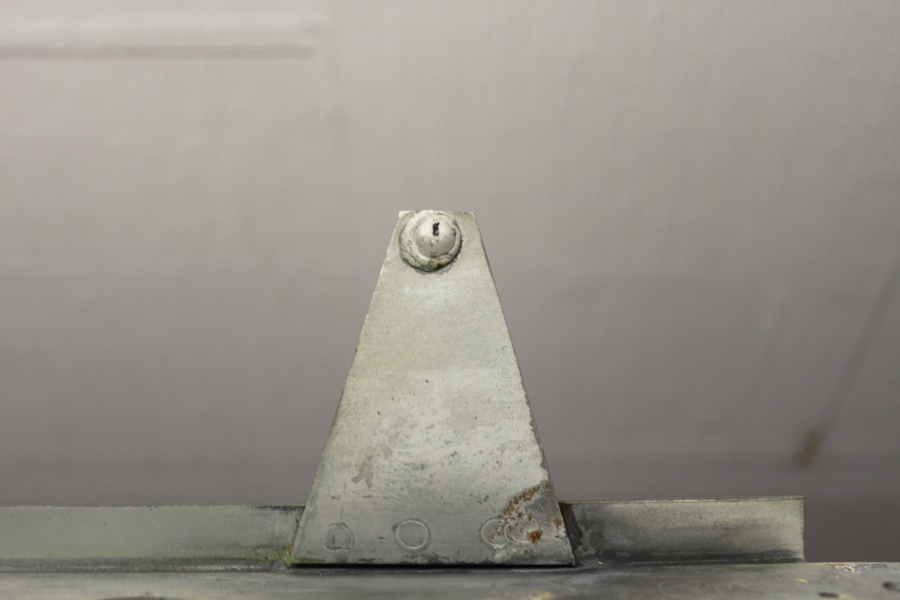

Default Supply Unit ZA/CAN 4772
A little bit of a spinoff from my last Post.
While temporarily having the Leads, Aerial 25-3/4 inch installed, I am not yet able to feed it through the Eye Screw located at the top of the front panel of the Supply Unit, because this particular Eye Screw has had the eye loop crushed in on itself.
If you look at the upper panel edge in this photo, you can see a set of four angled gouges in it, running from the right side to directly over the Eye Screw located at the upper right corner of the Sender Heaters decal.
When Jacques and I got our first close looks at the Supply Unit, we thought somebody had used a heavy screw driver in the upper panel edge to try and force the Supply Unit out of the Carriers No. 4 at some point in time. A close look at the inner face of the Carrier No. 4 in those four locations shows absolutely no damage at all.
So my current theory is that at some point in time, the Supply Unit had been removed from the Carriers No. 4 and was sitting on its own somewhere when a pair of Idle Hands came along with nothing better to do and decided to give the top edge of the panel several whacks with a ball peen hammer, or chunk of heavy bar iron. The one blow directly above the Eye Screw caught it and bent the eye closed.
Now noted for future repair.

It may have been in a different carrier when Mr Hamfisted attempted to pry it out (or force it back in, not realising that if you remove all the units from the carrier you have to remove the interconnection bar because the connectors definitely won't line up and fit it after everything is back in position). There may be another rack out there with matching damage,
Chris.
  #575
Old 22-03-21, 01:24
Posts: 3,721
Hi Chris.
That is another good possibility, actually, though the most likely place for Carriers to have been switched up between a number of 52-Sets would have been at No. 202 Workshop where all the major overhauls took place. That would suggest Mr Hamfist would have been in the military, perhaps a wireless operator, and that couldn’t possibly happen, could it?
Said Workshop may not have had a high priority for returning exactly the same equipment to a unit that submitted it for overhaul, as far as I know. As long as a duff set came in and a fully working one was returned, that might have been acceptable. Again, I do not know what the actual service procedures would have been.
I do know issues did occur where upper panels on Receivers were replaced on incorrect lower chassis assemblies, which caused a level of concern at 202 Workshop. That meant the Modification Records stored in their holder on the lower chassis no longer matched the serial number on the Data Plate mounted on the removable upper panel. Several Receivers are known to have survived with a mod moving the Data Plate to the lower chassis, where the left side Handle was originally located, and that Handle being moved over near the Meter. The work on all those receivers is identical, suggesting some form of standard was being followed.
The damage on this Supply Unit panel and Eye Screw definitely appears repairable at the moment, so in that regard, things are still on track. And besides, what fun is a project if there are no mysteries involved!

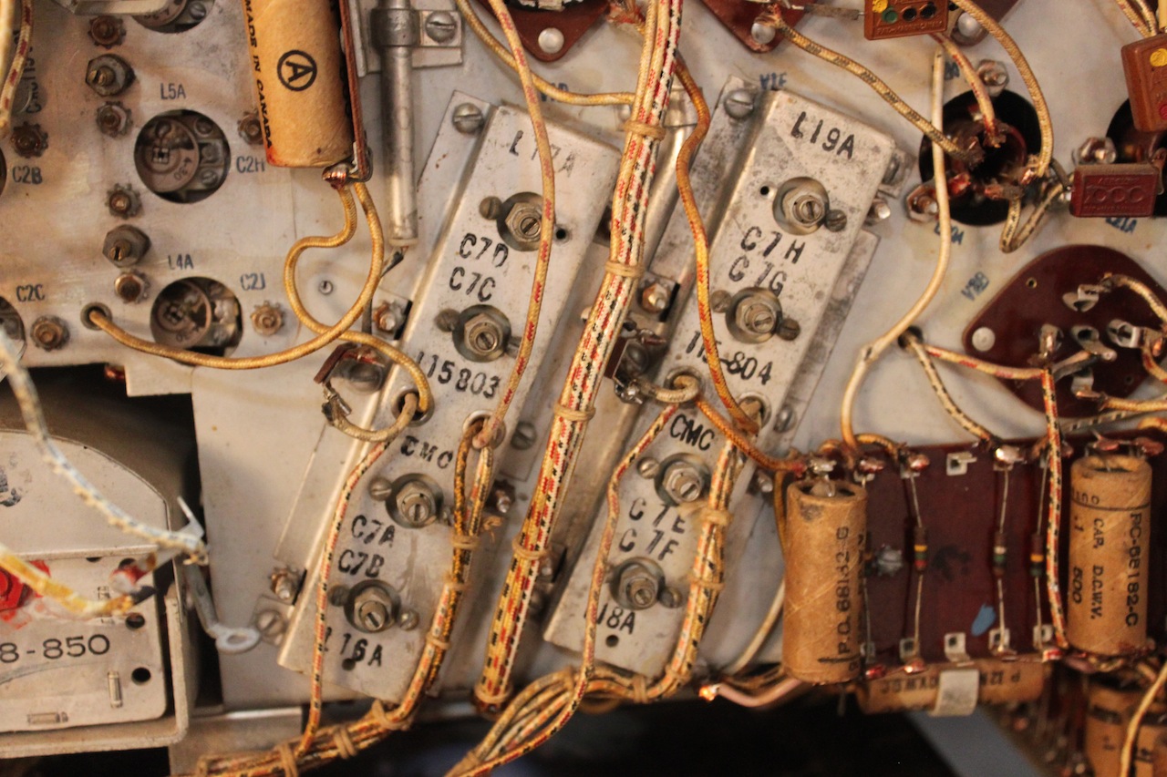

While doing this work, I was chatting with Jacques Fortin and he asked if any of the receivers had Modification Instruction 6 Performed on them. I had forgotten about this one. It was issued 24 April 1959, and involved replacement of the 10 original 100 uuF Trimmer Capacitors in the IF, BFO and Detector stages of the Receiver.
The originals, a semi-fixed 5-100 uuF capacitor were found to be defective and were to be replaced with a newer improved variable, air dielectric 7.5 to 99.9 uuF capacitor.
The distinguishing characteristics between these two sets of variable capacitors visually, is the originals had a flat zinc plated finish on the tuning shafts and locking nuts and the shafts stuck out beyond the locking nuts about one quarter inch. The new replacement trimmers have a bright nickel finish and the shafts sit flush with the locking nuts.
The Modification Cards in my Remote Receiver and Parts Receiver confirmed the change was done in 1961 on the remote Receiver and never done on the Parts one. The first two photos attached show the originals in the Parts Receiver and the second set of photos show the upgraded capacitors in the Remote Receiver. C7A to C7H can be found in two banks of four at the back of the chassis. C7K and C7J are found, left to right, at the front of the chassis on the extreme left directly above the retaining clamp for valves V1G and V1H. No letter “I” was used in the coding system for these trimmers.
I thought I would post this information in case anyone has a 52-Set Receiver with no Mod Card. They can at least now determine if their receiver was modified or not.

The slow, but steady, disassembly of my Spare Parts Receiver 8349 is underway and it is already revealing some interesting bits of information.

Default Receiver Valve Shield Retaining Brackets
These two retaining brackets cannot be found in either version of the Master Parts List for the 52-Set Receiver. Odd, because they are clearly designed to be replaceable, if needed.
For lack of a description, I have simply referred to them as ‘Valve Shield Retaining Brackets’, as their intended purpose is to keep the shield assemblies for the two horizontal rows of valves in place.

This morning I was able to remove all the loose switches from the front of the chassis. I did not want them continuing to swing and bang about while maneuvering the chassis around trying to work on the removal of other bits.
I can see already I will be needing more desoldering wick real soon.
Once the removed parts are cleaned and checked, I bag them with an ID Sticky Note and if the part is compatible with any Canadian 19-Set Mk III parts, I make note of that as well. It slows things down a bit but at least in the future, I will know exactly what I am looking at during a parts search.
I will start on one of the Tag Panels at the back of the chassis next.
