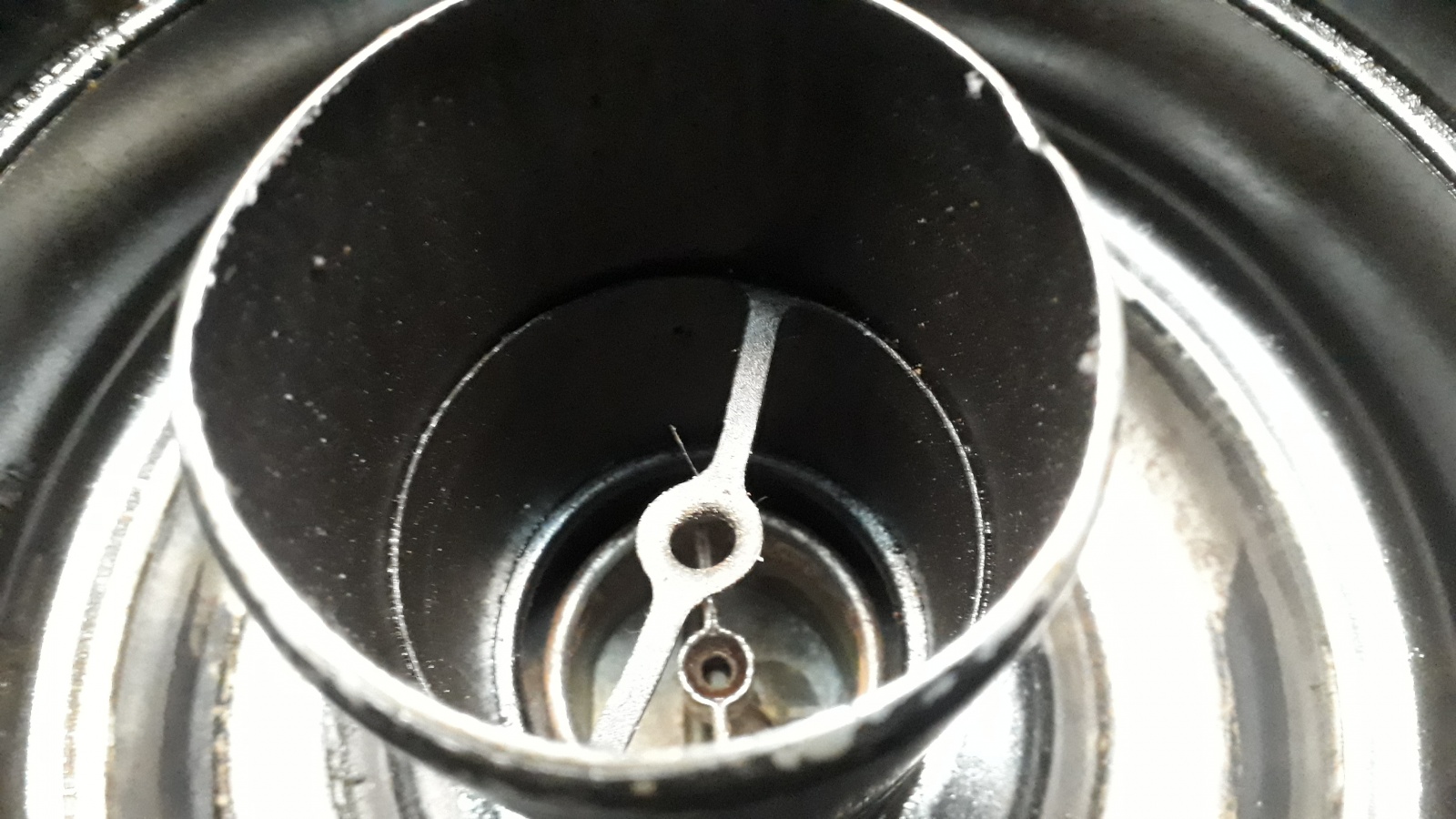

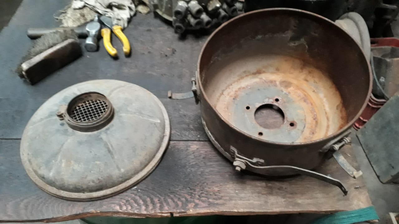

Default Wadeproof Ford Air Cleanner
Another rare part found. Wanted to know how attach to carb!

What type of clamp i need to install the air cleaner and shield??

Thanks to Herman Van Hove i have the answers!
