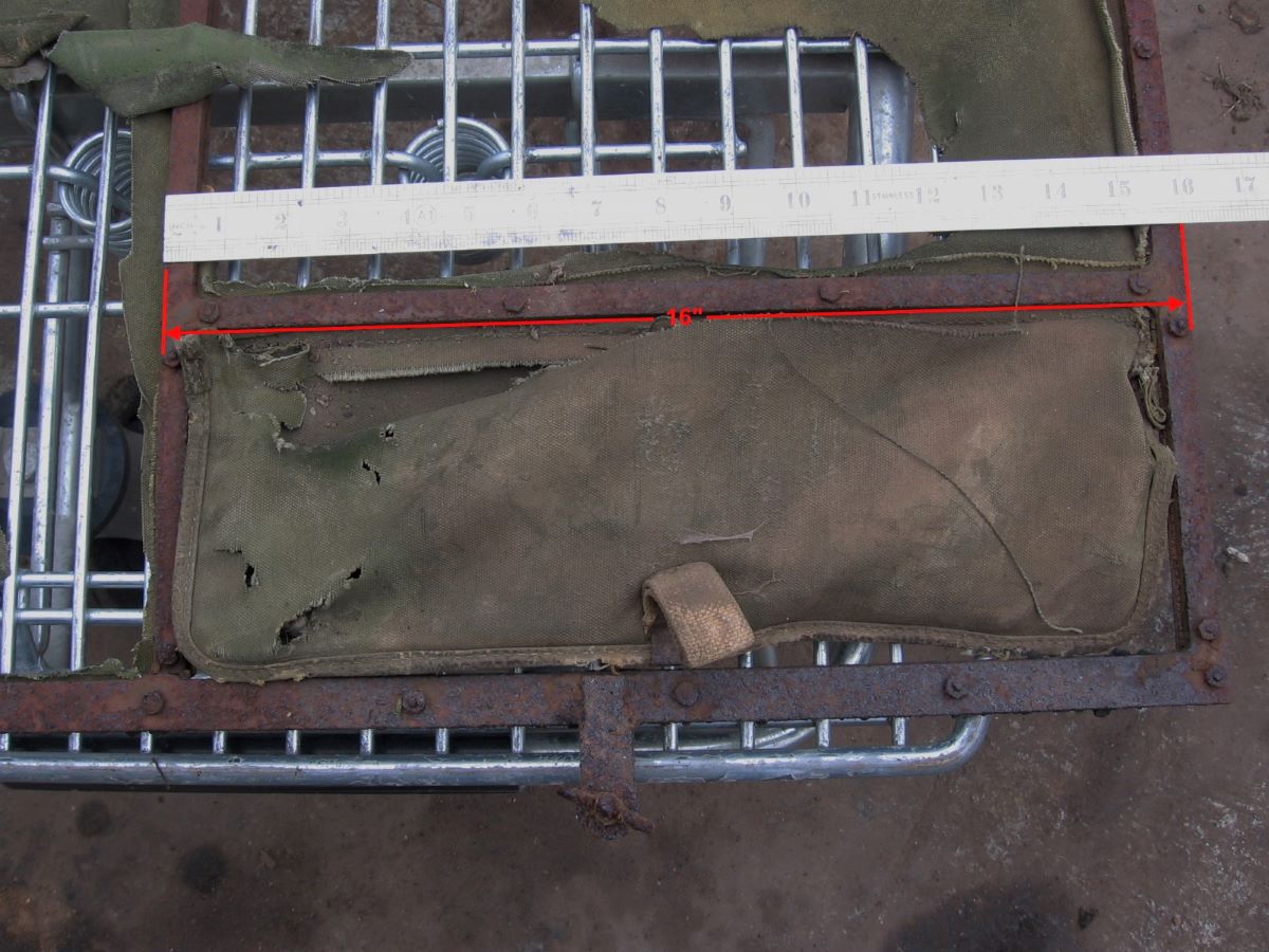

Default Ford CMP truck- Front Curtains, Cab 13, Australia
Good Day,
I posted some information on Harry Moon's threads on side screens for CMP vehicles. As I noticed a different design between those for Ford and Chev trucks I thought it might be better to post it on my Ford CMP thread rather than further hijack Harry's. My apologies to you Harry.
The height of the frame is the same for both 15-1/2" but I noticed a difference in the length of the frame, 34-1/2" for Chev models and 32" for the Ford model.
I had a look again at the photos I took of the original curtain that was attached to an Australian Cab 13, F-60L and the one from which I derived my drawings. Luckily I had laid a steel rule on it to verify the size and it does prove, at least, that the Australian Ford curtain frames were only 32" long.
I may one day get back to the property to double check all the dimensions. Hopefully the owner wont be in a hurry to get going somewhere and I can have enough time to do it. After 6 years I am sure it will still be there- just a bit rustier.
Hope this is of some interest.
Name:	IMG_0018 (2) length.jpg

  #219
Old 10-06-21, 03:59
Posts: 2,405
Default Unique Aust Curtain
Hi Jacques,
Perhaps we should point out that the side curtain shown in your images is for the '44 pattern Australian cab which had a flat-frame, de-mountable door with external hinges on pins welded to a forward insert in the door frame, which I think was about 2 inches wide, and an external door clamp at the rear end which snigged into a slotted plate welded to the exterior of the cab.
Maybe this different configuration accounts for the difference in length, although the actual 'window' opening above the door was still the same length, I think?
  #220
Old 10-06-21, 04:15
VMVC
Join Date: Jul 2012
Location: Victoria Australia
Posts: 872
Default Ford CMP truck- Front Curtains Cab 13
Hi Mike,
Thanks for that great info. I cannot remember what the door looked like, I thought it was the same as mine, double skinned, but I have seen a photo the same type curtain on a double skinned door. Perhaps a post war use of what was on the surplus market at the time then, even if it was not the correct one for that door?
Guess this means back to the drawing board! At least for the one for my doors.

Old 10-06-21, 04:30
Posts: 2,405
Hi Jacques,
The curtain for the standard, double skin, 'non-demountable' door has a step in the bracket that slots into the bracket on the inside face of the door. The step spaces the curtain so it sits on the outside edge of the door, with the underside of the step sitting on the top flat of the door. With the Aust '44 pattern door, the depth is only the thickness of the frame material, I think about 1/8th or 3/16th, plus its canvas covering, hence the straight, flat mounting bracket visible in your images.
There was a whole raft of 1950s-era CGCF-marked door curtains floating about at one stage (20+ years ago??) I'm reasonably sure that Blitz enthusiasts such as Keith and Euan have examples. These were the stepped design for the double skinned door, but the canvas covering had a smaller plexi? window than the WW2 version.
