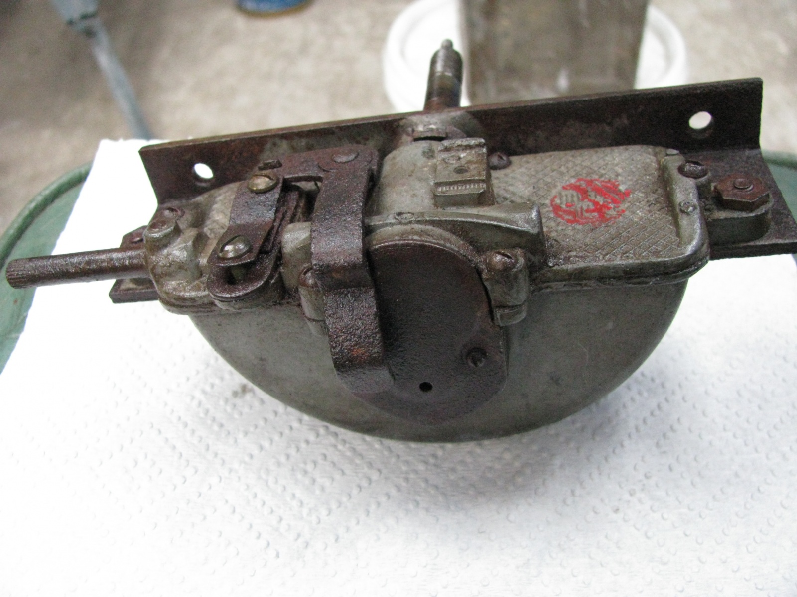

Not sure if this is what you need. These are vacuum wipers and mounting bracket to the windscreen bracket. From a Ford CMP but maybe common. If they are what you need I can get you the dimensions.
Note: Small lever on windscreen side to allow manual operation of the wiper just visible in top view.
Revisiting your photos I think yours are completely different make/type. Anyway, I will leave this post up for interest sake. Sorry I could not help.

Thanks Jacques,
I think you are right about it being the wrong type, but interesting all the same. I don't think the 1533X2 had a vacuum supply to power the motors, I presume it was electric, but to be honest I have no idea! The photo shows a cable or tube feed to the motor.
On the operational vehicles it was removed anyway, but I just like to know what should be there, and it might help with what sort of bracket should be on the inside of the windscreen to mount the motor onto. Grant's photo shows a very simple bracket on a later CMP, but looking at the LRDG photo the bracket seems to be more complicated.
Certainly vacuum. There were a small number of car makers that provided electric wiper motors in the 40's, but usually on high value, low volume models. Certainly not on a Chev (or Ford) Truck, and not for a military model.

There are lots of variations in vacuum wipers, up into the later 50s (particularly British cars, often with a vacuum tank (with the hope that you might get at least one wipe as you climbed a hill) These were mostly mounted under the dash so had a separate control.
There were larger units (cylindrical bodies) in the M series trucks that were new (to the N.Z. Army) after the Vietnam war (70s) (e.g.M816- M818)
These were fitted in Wagner logstackers up to 2000. These big units, as I recall were pressure rather than vacuum. (still available?)
I have seen as thread on here talking about Canadian contract Jeeps with electric wipers.
Wipac is a common brand with British units appearing to have a "shield type cover (pointed at the bottom end) and U.S. ones having a cover shaped like a horse racing oval.(e.g. WWII WC Dodge. _ these were small units early on and were larger like the CMP ones later in the war)
The CMP ones like the Dodge ones had an operating lever (assist) as well as a push pull (on off knob) The CMP cover is more square with a rounded bottom.
I have a couple of them still sealed in their Ford V8 marked LV* CC15 17505. I do have a use for them.
I think they were extensively used as Tony said. I hope that helps a bit.

Vacuum is drawn from a threaded port in the Intake Manifold.

So far though not matched any motor to last photo, which appears to have a block on the rear of the assembly at about 45 degrees. Or is that just an optical illusion?
Is it safe to assume they would be Trico motors?
http://www.mapleleafup.net/forums/sh...t=wiper+motors
