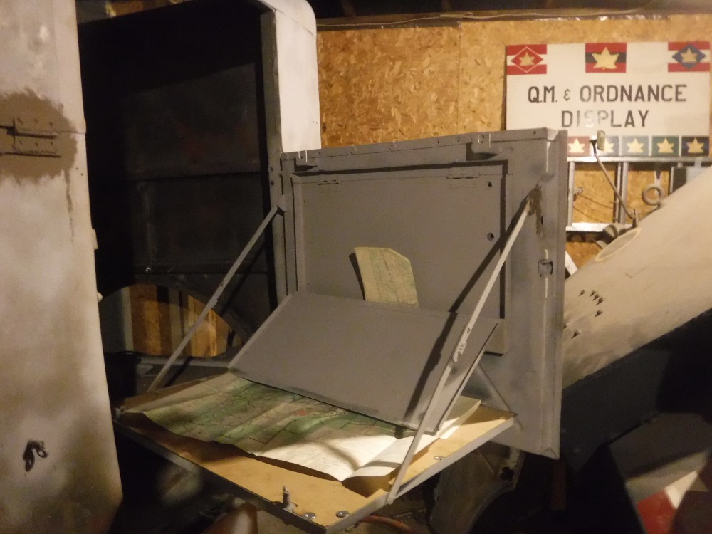

Sometimes in the midst of doing the rusty parts or bodywork you give yourself a treat and put on something newly completed. Here's the folding table and map case attached to the rear door.

Hi Bruce.
I've heard of that combination of kit on the rear door, but this is the first time I have seen one.
The Table clearly sits too low to be of value inside the HUW, so is it safe to assume the intension is to provide an outside work surface under certain circumstances? Something along the lines of the large table stowed on the lower left front of the WIRE-5 2K1 Box, which could be deployed to the left outer side of the Box?
Old 20-07-21, 03:02
Hi Bruce.
Yes it's an outside thing. I guess the signaler in the rear-most sidesaddle seat could open it enough (but just enough) to get maps out of it on the move. There is a hook and ring (seen in the factory back end photo) to keep the door open at 90 degrees. Yet another part I have to make. Oddly despite this outside table HUWs never were equipped with a penthouse as other HUPs were. Maybe they considered it but gave up when they discovered there wasn't a scrap of spare space left to stow it.
