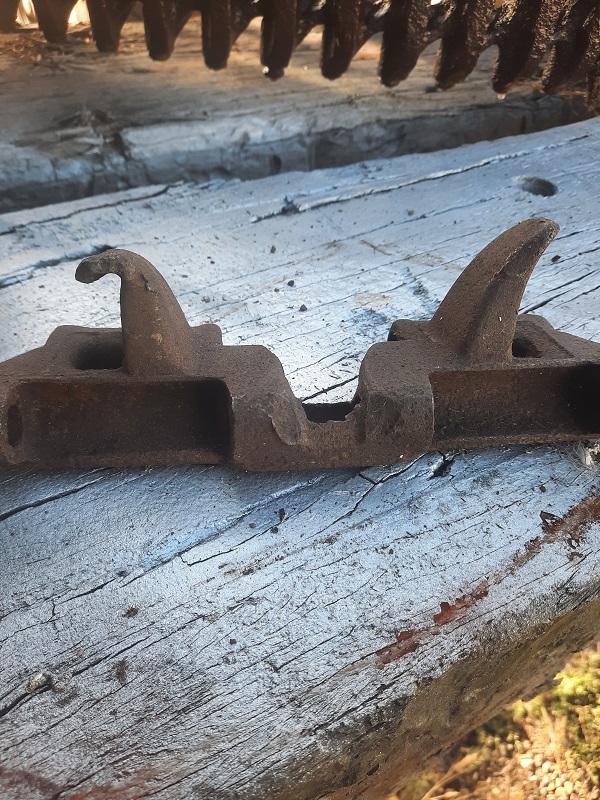

thought I better prepare my track for installation as it is not far away. As a point of interest and I know this has been discussed before but for those who don't know, The track for the Australian carriers and the Ten Vickers light tanks ran wider horned tracks as we have wider wheels than the universal and T16 carriers @ 2.5". The track here is the English track it will suit one of my Vickers and I will be running Aust track for the other as those wheels are the original English design but the Aust width 3" As you can see in the photos the difference in horn spacing.

Just showing a photo of a track link with a bent horn. It goes to show just how malleable they are before they actually break.
I am also machining up connection plates to attach the soft start to the hyd pump. I had some 4140 so I thought it should go to some good use. I just need to cut the key into the shaft.
