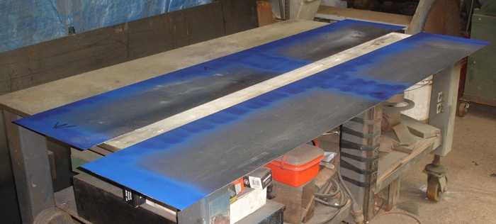

Work on refurbishing Bob's 2B1 body for his C15A has resumed. After considerable planning sheet steel was purchased, and layout done to cut blanks for fabrication of the replacement headboard, tailgate and dropsides.
Bob planning 2B1.jpg   Sheet steel pre-cut.jpg   Bracing blanks.jpg   Headboard blank.jpg   Dropside blanks.jpg

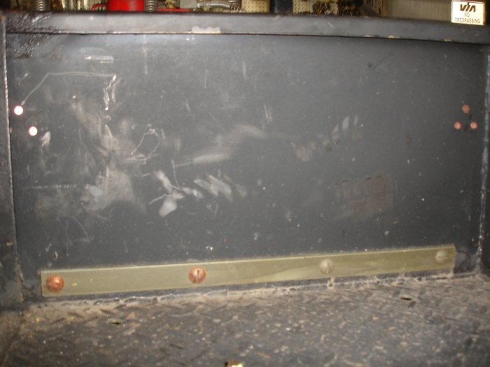

The floor and substructure are original (with minor repairs) along with the wheel boxes (which reminds me that the footman loops on the wheel boxes also need to be added).
