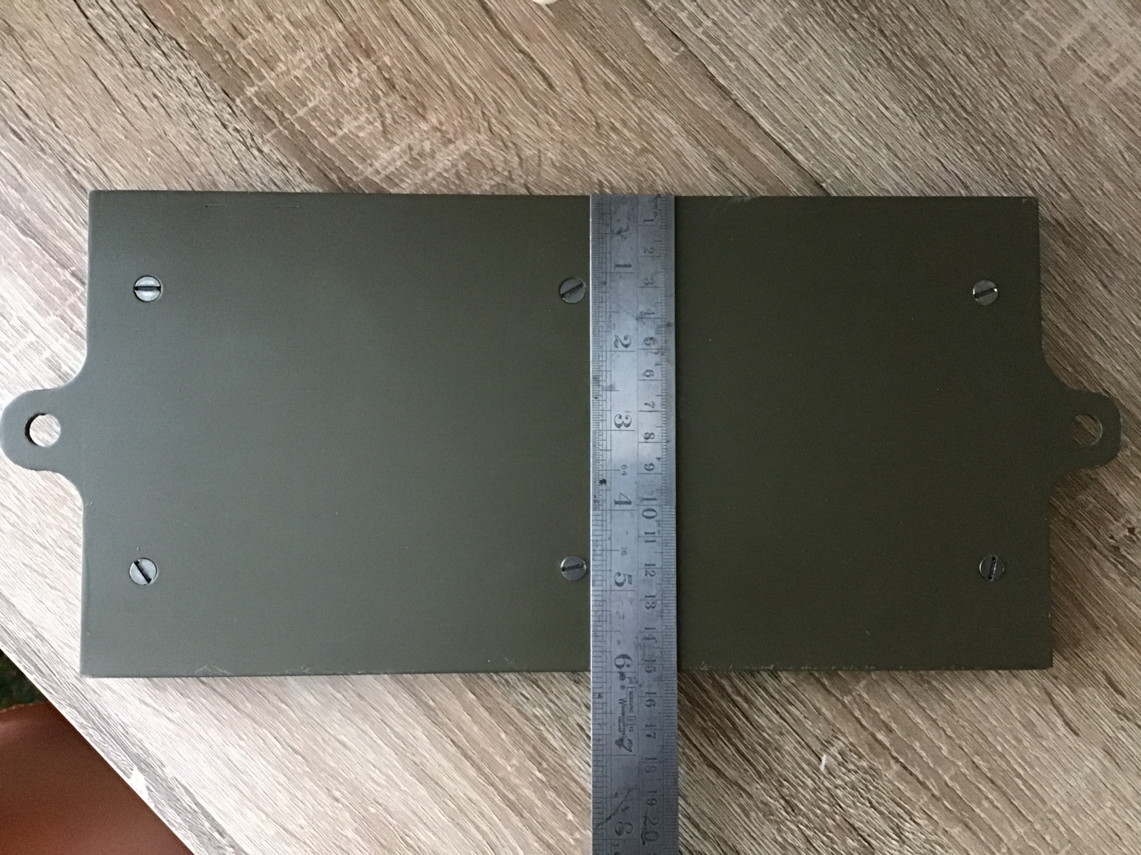

I have one of the back plate's as well, I'll post some pictures and dimensions for you today.

Rear seat back plate dimensions: 12” x 6” x 1/16”
6x no 8 screw holes as per image, 3/4” in from the outer edge.
