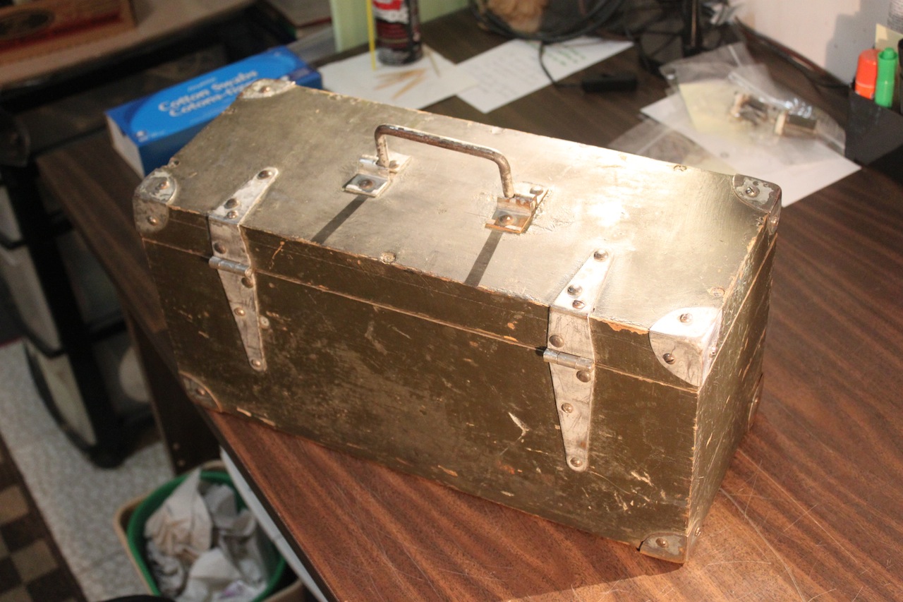

Last weekend, Debbie wanted to visit a local Thrift Shop to look for some items to do a craft project with, so I tagged along, initially to soak up the air-conditioning, rather than sit in the car waiting.
While she grabbed a cart and went foraging, I decided to explore the electronics section where most of the electrical stuff hides. I have actually lost track of the number of wartime wireless equipment bits that have turned up in these shops over the years. I was also hoping to find an old lamp or electrical appliance with a vintage 2-prong cord I could use to replace one on a piece of test gear, as the original is starting to show signed of the rubber crystallizing.
No such luck for either items this time around, but as I was passing a shelf full of old tools, a couple of hammers caught my eye. I needed to find the right size and style of ball pane hammer for the 52-Set tool kit. Bull Dog Tools, a British company that still makes garden tools, made the wartime originals. One hammer was clearly far too large and the wrong shaped head. The second, smaller one looked very close to what was needed and although the head was covered in surface rust, the hickory handle was in excellent shape, so for $3.99, I tracked Debbie down in the shop and added it to her pile of treasures.
It took about an hour to clean nearly all of the rust off the head, oil and rub it down, and clean the handle. The trace of the name on the handle appears to be ‘Benchmate’ or ‘Benchmark’, either of which start with the correct letter, so I was quite pleased with the find overall.
Once cleaned, the next step, of course, was to see how well the hammer fits the toolbox. The hammer can really only fit in the tool box with the head to the right side and the handle resting on top of the wooden partition to the left, and when you look at the spacing around the two metal support brackets fitted on the right side, the head of the hammer best fits with the pane end towards the front of the box. The leaves a nice long area across the front of the box to store the three screw drivers and if you want to avoid accidentally discharging your flashlight by resting it switch side down. It best fits switch up and lens to the partition.
With the hammer in this position, notice how the handle, resting on the partition, keeps the handle of the soldering iron in place and how it would also help keep the hydrometer box in place when it is resting on its larger metal bracket and the partition.
I have not yet figured out how the rest of the tools were packed in the toolbox at the factory, but the various pliers likely went in the middle of the floor of the box, between the screwdrivers and flashlight.
It’s a pity that packing instructions for so much of the wartime wireless instructions have not yet turned up. Apart from the ones for the three wooden boxes/cases for the 52-Set, I would love to find the instructions for packing the small Spare Parts Box for the Wireless Set No. 19 at the factory.

Since the Olive Drab paint I am working with on the various 52-Set wooden boxes and cases is a latex, eggshell finish paint, I was wondering how I was going to deal with priming the metal hardware on all these wooden items, given the grey oxide primers I have on hand are all oil based. Then I remembered several months ago I had seen some small cans of Tremclad metal primer somewhere that I thought were water based. I could not remember where, so started searching the usual stores this morning. On the third try, at a local RONA, I found what I needed, had them shake a can silly and bought it.
This afternoon, I now have all the metal hardware on the Tool Box primed and curing. With luck, I should be able to get the finish coat of Olive Drab applied this weekend.

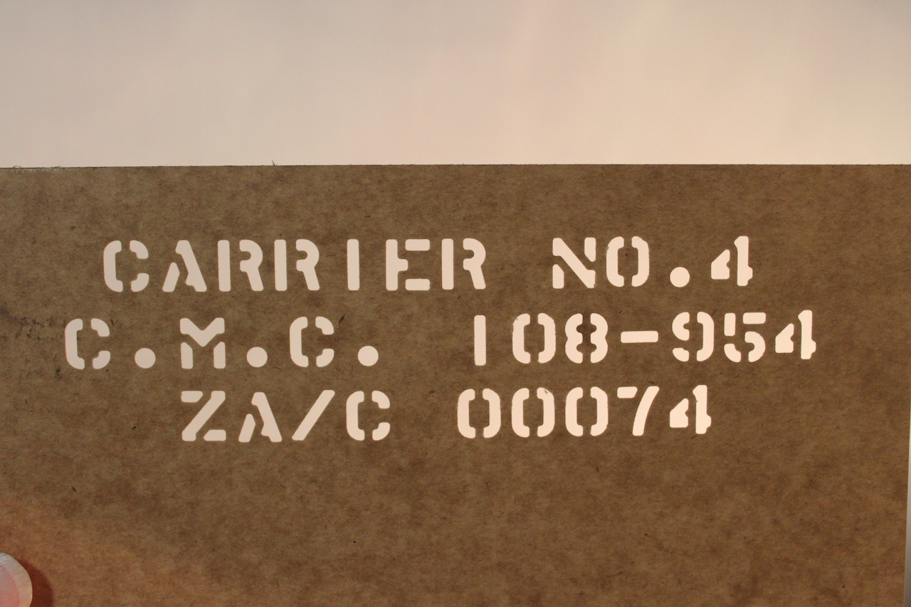

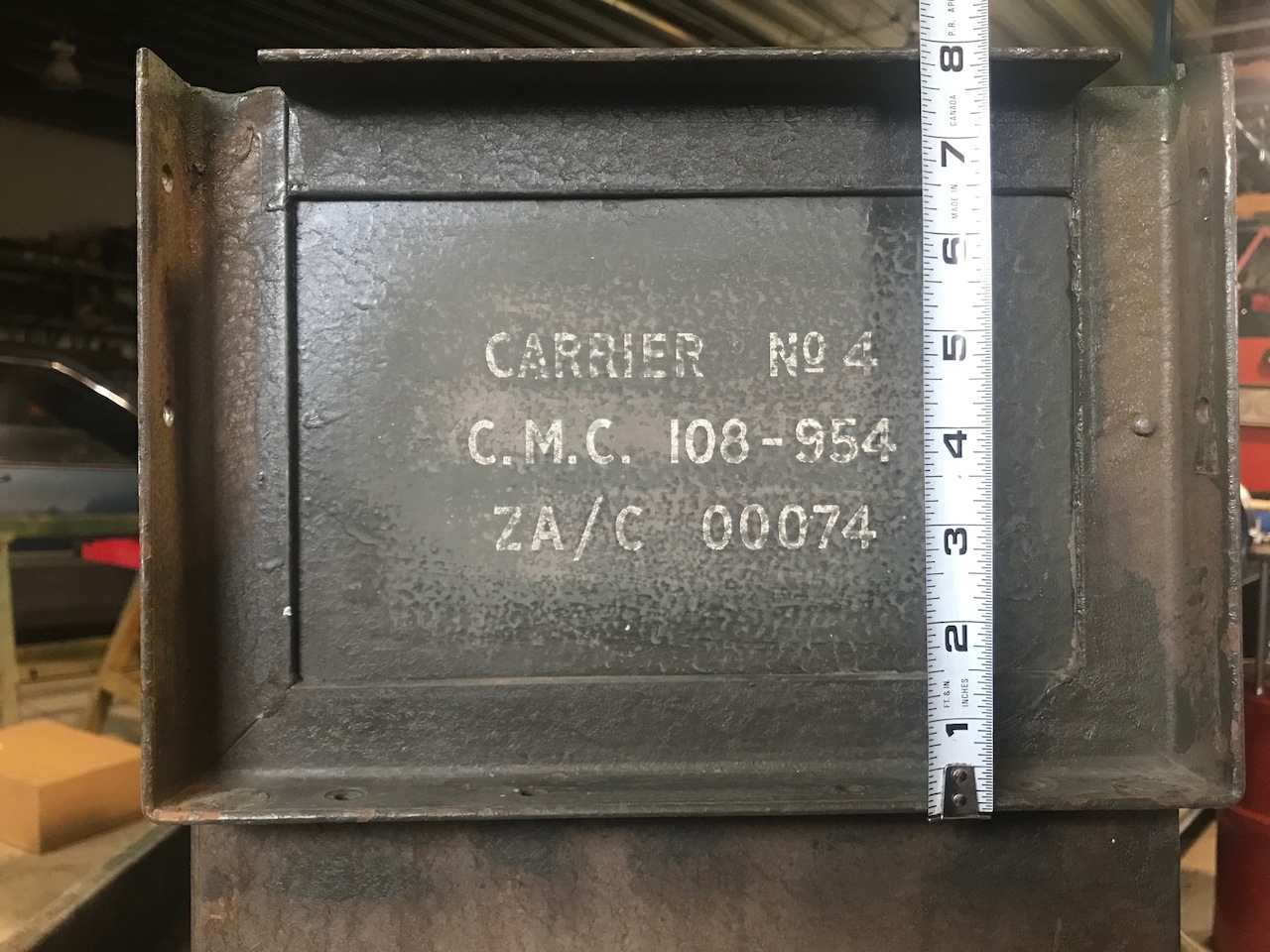

This particular stencil is probably the most interesting of the 52-Set stencils I am aware of to date.
As you can see in the photo of the original surviving markings, it is not a true stencil marking, but some form of silk screened product, perfectly centred on the upper left side of the Carriers No. 4. The characters are definitely all 1/2-inch in height, but slightly slimmer, and without the webbing the stencil cutting machine produces. The line lengths are a very close match but the overall height of the three lines on the stencil is 1/4-inch lower than the actual markings on the Carriers No. 4. Also, there is no means of cutting a lower case, underlined ‘o’ on a stencil machine.
When I started this project, I assumed Canadian Marconi Company built everything for the set but actively contracted out for components. I am not sure why I made this assumption considering I knew Northern Electric had built the Supply Units for the earlier No. 9 Sets made by CMC.
I have now learned RCA and Philco were clearly providing major sub assemblies and accessories to CMC for the 52-Set as sub-contractors. The sheet metal work required for the chassis of the Receivers, Supply Units, Senders and Coils Aerial Tuning (and probably the Remote Receiver Case) would certainly be within the capacity of Marconi’s shops to have produced, and with the exception on the Remote Receiver Case currently soaked with NATO Green paint, all the other chassis bear CMC inspection stamps punched into the metal.
The Carriers No. 4 is a somewhat different beast. Although the basic three compartment box is the same gauge metal as the chassis items, the Carriers No. 4 has some very heavy duty steel formed and fitted to it. It would not surprise me at all if the Carriers No. 4 were sub contracted out by Marconi for production and whatever company manufactured them used silk screen style tools for the markings. When I eventually get to the point of restoring the Carriers No. 4, perhaps some stampings will show up on the metal parts somewhere that will shed more light on this bit of 52-Set production.
In the meantime, I now have a stencil I can use for this marking, if all else fails, and enough time to explore silk screening options a little more to see if there is a way to easily replicate this item.

Default BOXES, Tool, No. 1 WS Cdn. 52. ZA/CAN 4727
Spray painting today, in spite of perfect weather, did not go well.
I did a lot of oil based enamel spray painting years ago, but this was my first attempt at working with a latex paint with an air gun. After a lot of reading, the key issue in working with a latex paint in an air gun is the viscosity. From there, it goes tricky very quickly. There are quite a few thinning formulas out there and all come with warnings. Too thick and the gun plugs and you have to be fast to clean it. Too thin and the number of required coats to get the colour you want and the finish, goes up. At the same time, the colour starts to get lighter and if you go too thin, the tint particles start falling out of suspension. After an hour of fiddling about, I could not get the gun to draw the paint through it at all, so gave up and wasted more time cleaning up the gun and making sure it could at least spray clean water in the correct pattern before putting it away and bringing out the backup plan, small paint roller.
Two coats and four hours later, the tool box is safely back in the basement to cure and harden.
I started with a block of 4x4 under the bottom of the box and painted the back of the box first. I then carefully picked the box up by the sides and turned it to face me and then tilted it towards me letting the lid swing open until the box was upside down.
I then set the lip of the box across two pieces of 4x4, while swinging the lid forward to rest on a 2x4. In this position I could then easily paint all the other remaining sides of the box. After four hours, I repeated the process for a second coat and then brought the tool box back into the basement to cure The attached two photos show it curing in the main painting position described above.
One thing I will do differently with the other boxes/cases is to prime all the hardware by hand as I did this time, but then finish paint all the hardware by hand as well, before going to the roller. On the bright side, the roller application has produced a very nice finish to the paint and I think it is going to work out very well.
The tool box is now dry to the touch but the paint still has a soft feel to it. The manufacturers instructions advise it takes a good 14 days for the paint to hard cure and finally resist push back happening if any surfaces get a hard rub, and become fully wash tolerant.
I did want to get the touch ups done on the metal hardware, so carefully turned the box upright on my work table this morning and it is now resting on two small strips of wood located under the four lower corner plate screws.
The two photos today show the tool box before and after the touch up work was completed. Now the whole paint job can fully cure for the next 10 days, which it will likely take, now that the cooler, slightly more humid fall weather has arrived.
Even though I elected to go with an eggshell finish, rather than the original full flat, when I had the paint for this part of the project mixed, I am very much pleased with the colour match. The factory original full flat paint on the inside of the lid in these photos matches the new exterior paint perfectly.
I have to thanks Bruce Parker again for sending me his ‘parts’, Coil Aerial Tuning Unit for this project. The interior of it was still the factory original Flat Olive Drab green Marconi had used on all the wooden components of the 52-Set and the back cover of the coil box was what I took to the local paint shop to get matched. This is definitely an interesting paint colour. Depending on the lighting conditions you view it under, it can look either green, or brown, or some sort of bizzare mix of both colours. Even the technician at the shop could not tell and took three scans of it before being satisfied it was indeed ‘green’.

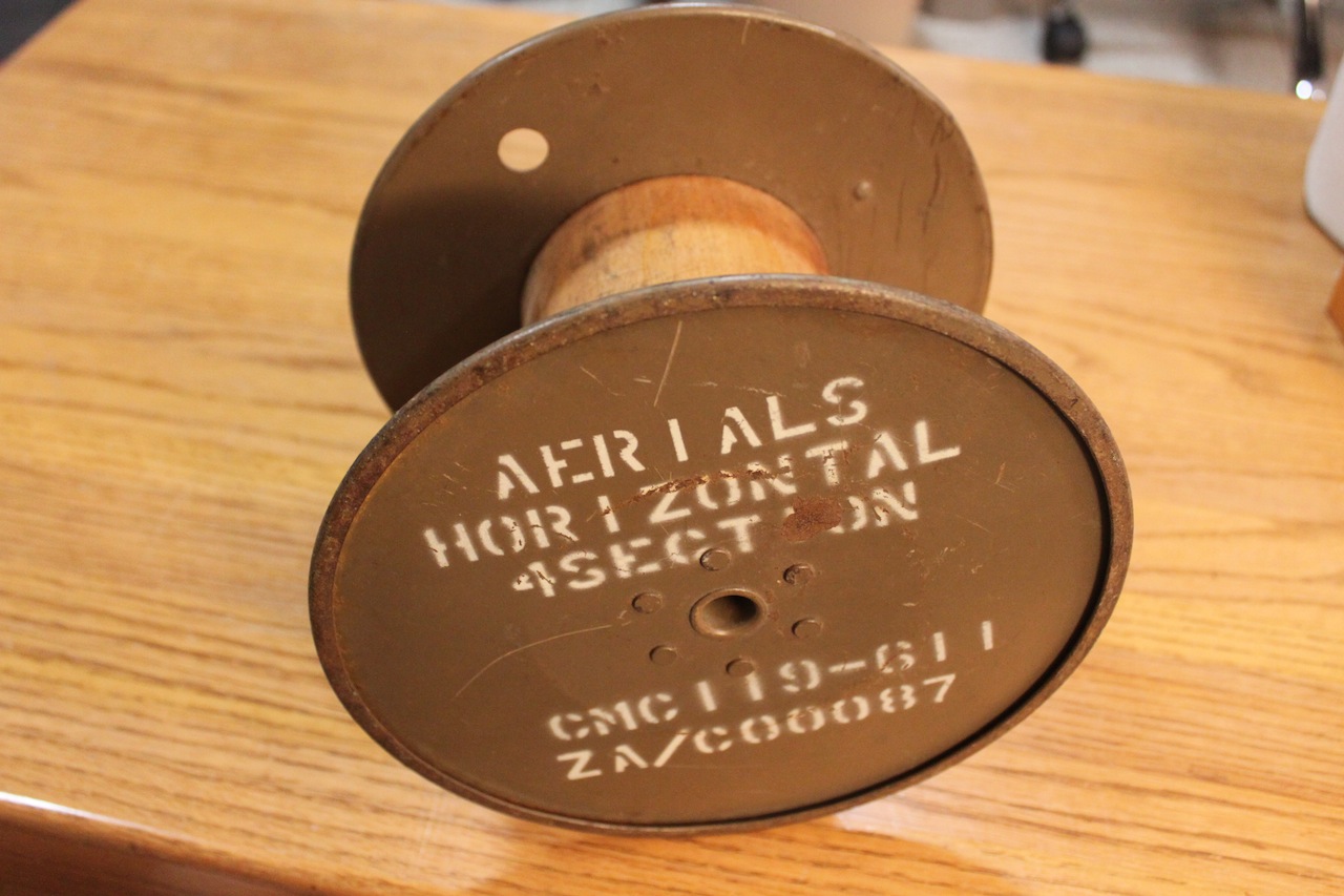

Just over halfway through the cure period for the paint on the tool box. It has now taken on a hard feel and the amount of off-gassing has dropped off dramatically.
Time to start practicing with the stencils I goofed on. The one surviving original stencil I have for the 52-Set Project is on the 4-Section Aerials Reel, but it provides a lot of information. The most notable bit is that stencil markings definitely do not have the uniform, consistency of any decal or screened markings. The distribution of the paint throughout the stencil is uneven. Some parts will have a solid buildup of paint, where other parts will have the colour over which the stencil was applied, clearly ghosting through.
Closely associated with this is the complete lack of any sign of runs in the paint having taken place. The application of the paint was very much to the light side and built up quickly with several thin layers where it was deemed necessary to do so.
80 years later on, this all gives the ‘rookie’ a lot of leeway to get the replication right.
WS No. 52 Cdn, Box, Tools AZ4.JPG   AERIALS, Horizontal, 4-Section  ZA:C 00087 1.JPG
  #928
Old 09-10-22, 20:44
Posts: 3,721
This morning, I was able to measure up and trim the stencil for the Tool Box markings to fit properly on the front of the box, when the time arrives to do the stencil.
Once I figure out how to hold it in place while doing the stencil, I should be good to go. My options at the moment are tape, rubber cement, or some combination of the two.
I have completed a round of stencil tests with the brushes I recently purchased. I did not try the 3/4-inch brush as it was far too large for the size of stencil I am using.
The first attempt was the letter 'N' lower centre in the photo with the 1/2-inch brush. Way too much bleed under the stencil on its own so I stopped with the one letter. the next attempt was the test block to the right side with the 3/8-inch brush and the plain stencil. Cleaner, but still way too much paint bleed under the stencil. Both of these tests were done with multiple thin coats build up with the brush.
The last test was the block to the left. For this, I secured the stencil to the test folder with a coat of Rubber cement, pressed the stencil down with a pencil eraser to ensure the stencil was as flat as possible and I let the rubber cement dry for 20 minutes at room temperature. I then rubbed the excess cement off the top of the stencil with my finger and used a round toothpick to clean up any excess cement inside each stencil segment. Then out came the 3/8-inch stencil brush again and multiple coats were build up until the majority of the folder colour vanished.
A very slight bit of paint wicking took place, but overall, I am very pleased with this result and kit will be the process I use with the tool box stencil.
