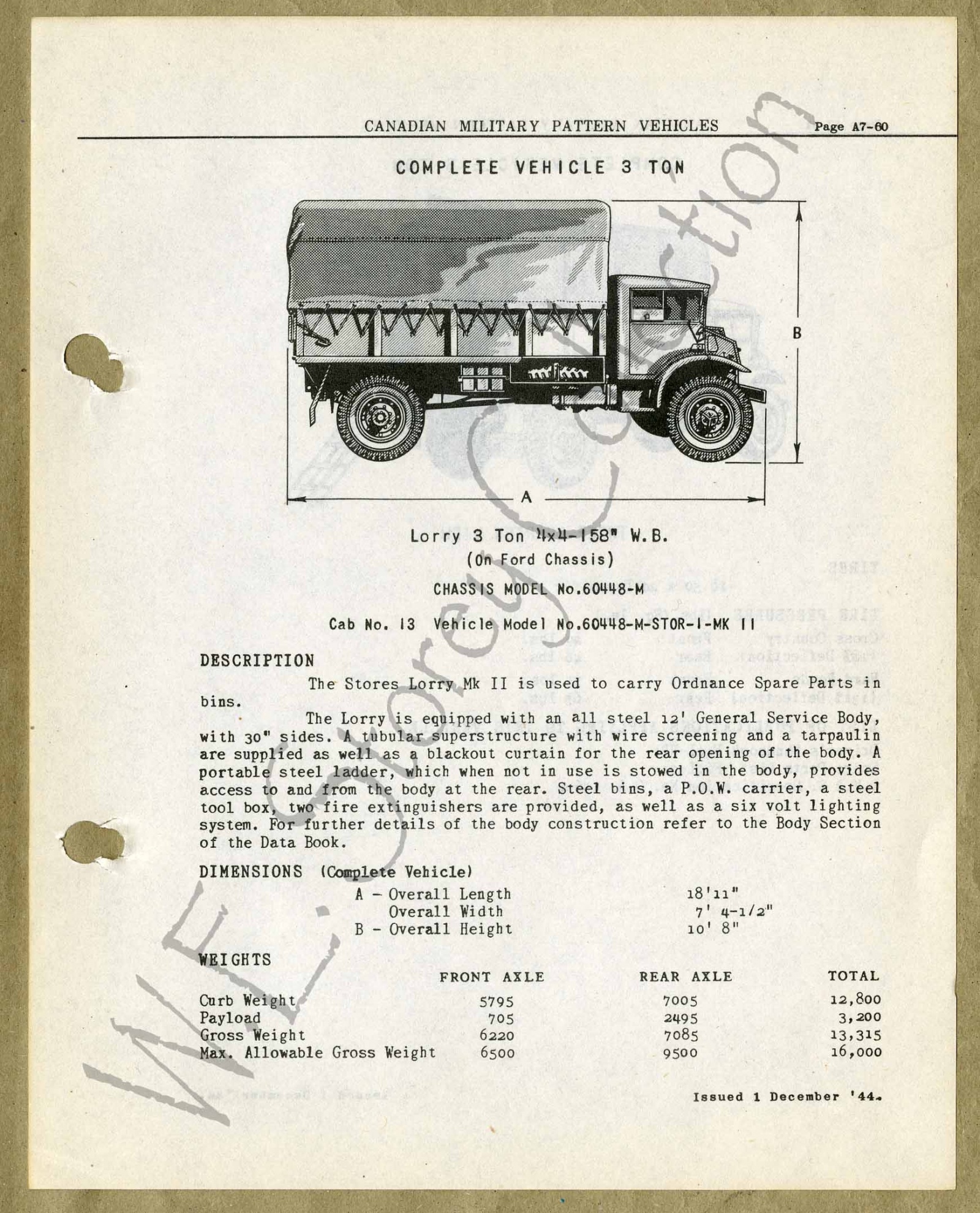

Posts: 1,742
Default 5E4 Flat Floor Body
I found these pages in the wartime CMP Data Book, I hope they are relevant to this thread.
Name:	Data - Page A7-60.jpg
ID:	132954 Click image for larger version
Name:	Data - Page A7-61.jpg
ID:	132955 Click image for larger version
Name:	Data - Page A7-62.jpg
