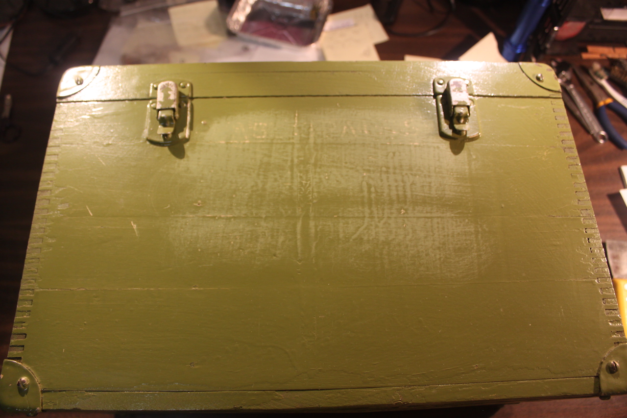

Since I will not be operating the Sender for a while. I disconnected the 2nd CCP-2 Power Supply from my 12 Volt DC feed system for the wireless bench to tidy up the cable clutter in one corner. I took this opportunity to clean up the twin connector cable I obtained from Brian Asbury for this CPP-2 and the effort paid off, as it now looks much more like its probable ancestor, the Connectors, Twin, No. C1 which was part of the Remote Receiver Kit for the 52-Set. Before and after pictures attached.
While I think of it, the cotton twine on this cable in the before photo has a distinct waxy feel to it. I have noticed this before with most wartime cotton twines used to secure items for packing and shipping, and a few postwar military items as well. It is probably a bees wax based item and may even include fungicides. Anyone know if this would be the case?

I have now started the first part of the work needed to strip down the old paint from all the metal hardware.

Old 24-05-23, 03:29
Posts: 3,721
Default CASES, Spares, No. 1 Cdn No. 52 ZA/CAN/BR 2349
In spite of the seasonal obligations of Yard Work, Painting and upgrades, I have now got the metal hardware on the top of the Cases, Spares cleared of old paint.
The next step will be to do the left and right end panels.
