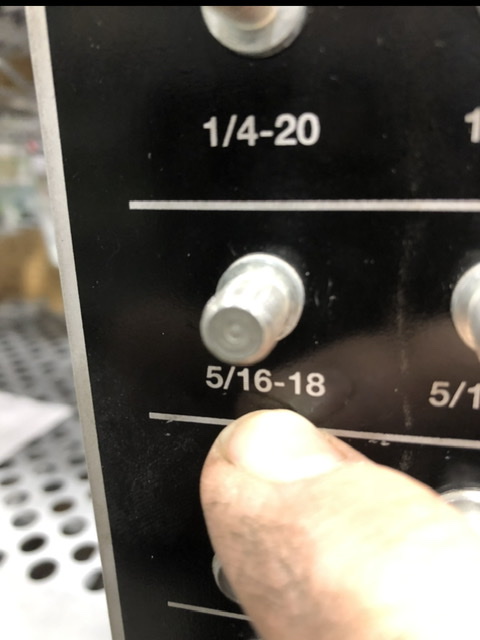

Default Charging panel
I am happy to report that the nuts on the charging panel posts are a common thread .
