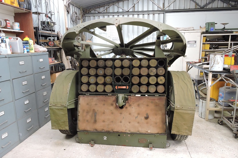

Greetings from Perth, West Aust. - I have come back to an 'old' restoration of mine, with the hope of adding some of the 'missing' items.
Hopefully the International Brains Trust can guide me, briefly the Aust Army at the start of ww2 had 2 types of 'pneumatised' 18pdr Limbers, ones with the Firing Platform frame on top / and ones without.
The pic'd Limber is framed.
From what I've seen on wrecks over the years the framed limber had Tools mounted on the old Foot Boards, while the frameless Limbers retained the Rifle mounts at the front having easier access - but field mods are common ?
My first question - on top at the rear is a bracket array, which I'm guessing holds 4 Aiming ( folding? ) Posts, I have a spare 3" Mortar post but it is too short. !8 Pdr aiming posts in manuals are mentioned but I have not seen one.
Question 2 - I'd like to make leather pouches for the Fuse Setting Key No 17,18,19? they were mounted on each side, does any one have dimensions of the Key. .................. there's a start ....... cheers
DSCN5691 - Copy.JPG   DSCN5683 - Copy.JPG   DSCN5692 - Copy.JPG   DSCN5693 - Copy.JPG   DSCN5696 - Copy.JPG

For demonstration purposes I’m fortunate to have a 25 Pdr Firing Platform to show how the 18 Pdr Platform would have appeared, I assume there were slight differences between the 25 Pdr and the 18 & 4.5” Platforms?
My 18 Pdr shells range from a Mk1 1905, thru ww1, 1920’s, 30’s. to 1942. ( I’m not a shell collector )
Question 3 – added ( 1939 ) to the rear door are two, once leather bound brackets, ~ 34 “ apart and supported something 2 “ wide …. Maybe a Range Scale ?
You might see that I have removed the 3 rivets which once held the rear door Key Pouch, I’m having a go at wet leather molding, ………. cheers
DSCN5698 - Copy.JPG   DSCN5697 - Copy.JPG   DSCN5700 - Copy.JPG   DSCN5702 - Copy.JPG   DSCN5703 - Copy.JPG

For your viewing is my *ww2,18 Pdr. Limber without Firing Platform frame.
Easier access to the Rifles, and no tools in storage.
The Army blanket on top is to show the Public where the 3 ww1 Gunners once sat.
Two Drag ropes on top connect to the Slip rings on the Wheel Hubs.
In ww1 there was another rope on top - the 66’ long Tethering Rope – for the Horses
Question - this Limber was made by ‘ Metro ‘, who were they?
Part of the original ww1 Arm Rest was used to support the ww2 Mudguards.
DSCN5704 - Copy.JPG   DSCN5705 - Copy.JPG   DSCN5707 - Copy.JPG   DSCN5710 - Copy.JPG   DSCN5716 - Copy.JPG

Default The Braking System on the Aussie ww2 18Pdr Limber.
The Brake Cable actuates/pulls from the Truck (not yet), the cable runs to a wonderful Aussie cantilever, which at the top pulls a rod which is connected to a lever on a cross shaft that then rotates to both Brake back plates actioning thru cams to the Brake shoes.
If there is another connected unit, the through running cable at the bottom of the Cantilever then engages the second unit, to cause the same Braking - when there are no further towing units the Through running cable is parked on a hook at the rear of the mudguard.
A grease nipple is provided on the flex to help overcome friction.
it was even harder to understand when it was found as wreckage
Blitz and Limbers 009.jpg   DSCN5751 - Copy.JPG   DSCN5755 - Copy.JPG   DSCN5750 - Copy.JPG   DSCN5756 - Copy.JPG

Default Ww2 Aussie 18 Pdr Limber Wheels
For my 18Pdr Limbers I’m happy to run 7.50 x 20 “ tyres, wrecks I’ve found seem to have used 8.25 x 20 ‘s. ….. The canvas covered steel mesh mudguards have been repaired and recovered.
And by the cast logo on the Hubs, Spyder and Brake drums, I’m assuming they were made by Sunshine Harvester in Sunshine, Victoria. The logo is similar to International Harvester.
Casting dates I’ve found are for 1939 & 1940.
The last pics show where the original Cartwheel Axle ran – with the new smaller diameter Tyre, the new axle had to be lowered – to raise the Limber body.
I have yet to find any technical records of the Pneumatization Program carried out on the 18pdr & 4.5 “ systems.
Hope you like my story - Gram
DSCN5752 - Copy.JPG   DSCN5760 - Copy.JPG   DSCN5761 - Copy.JPG   DSCN5758 - Copy.JPG   DSCN5759 - Copy.JPG

Default Rear Door Handle Strap
Inspired by M Kelly's pic - see the Yellow Arrow, an easy fix up with original rivet holes to go by ... and after scrounging through my old junk - a strap, easy, the replacement strap has allowed for some 105 years of sun damage , it being behind the top door flap, not as bad as what the key pouch copped.
The new strap will be wet molded back on itself.

Default Indicator Fuze Brackets
what a mongrel job trying to rivet in such confined space. After some investigation, trial and error, and wasting and ruining plenty of copper rivets, found that having the buckle end at the top of the mounting bracket gave a better purchase.
The old rivets on the two limbers varied 3/8 and 1/2 inch.
Indicator Mk11 brackets (1).JPG   Indicator Mk11 brackets (4).JPG   Indicator Mk11 brackets (7).JPG   Indicator Mk11 brackets (10).JPG   Indicator Mk11 brackets (16) - Copy.jpg

Default Indicator Fuze Mk11 Mounted
so, with buckle at the top , tongue strap under, rivets as ww1 (see broken G clamp), backing leather, this is what 'Their' getting on display at the local Annual Arms & Armour 9/10 Sept 2023.
