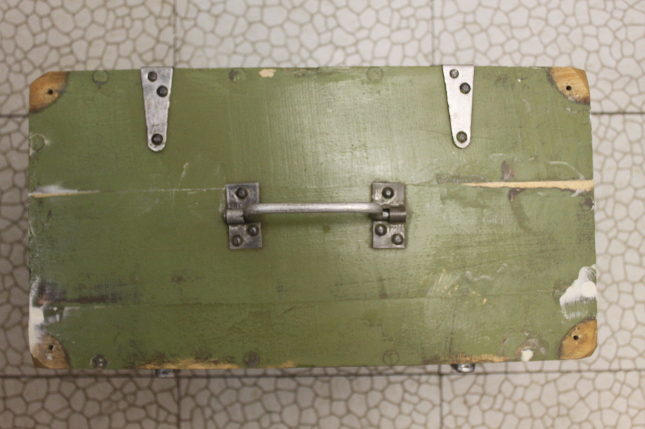

At that time, I noticed the left hand Handle Bracket, factory riveted to the lid, was actually a right hand Handle Bracket, properly drilled to fit the holes in the lid. As assembled, the handle works correctly, but it was odd at the time, the correct part was not installed.
While cutting back more of the grey paint on the front of this case last evening, more of the factory original stencil became visible, to the point where is looked to be a larger stencil font than what was on my green Cases, Spare Parts and the tool box. Putting a tape measure up to the two spare parts cases this morning confirmed the stencil on the grey case is indeed 3/4-inch, whereas the green case and tool box are both 1/2-inch. Both stencils are five lines in height, with each line holding the same characters. The top of the first line of each stencil starts exactly one inch below the lip of the case and the first lines are both centred between the two latches. However, because of the larger font size on the grey case, the fifth and last line ends up one inch lower on the front of the grey case than the last line on the green case does.
So now I am wondering. The green Spare Parts Case probably came out of the normal wartime production run of the 52-Set. There is nothing unusual about it. As far as the grey one goes, however, could it have been assembled at the end of the production run, at or very near to the end of the contract for the 52-Set using whatever available parts were still on hand on the assembly line? Not an unusual thing at all with various CMP production lines at the end of the war.

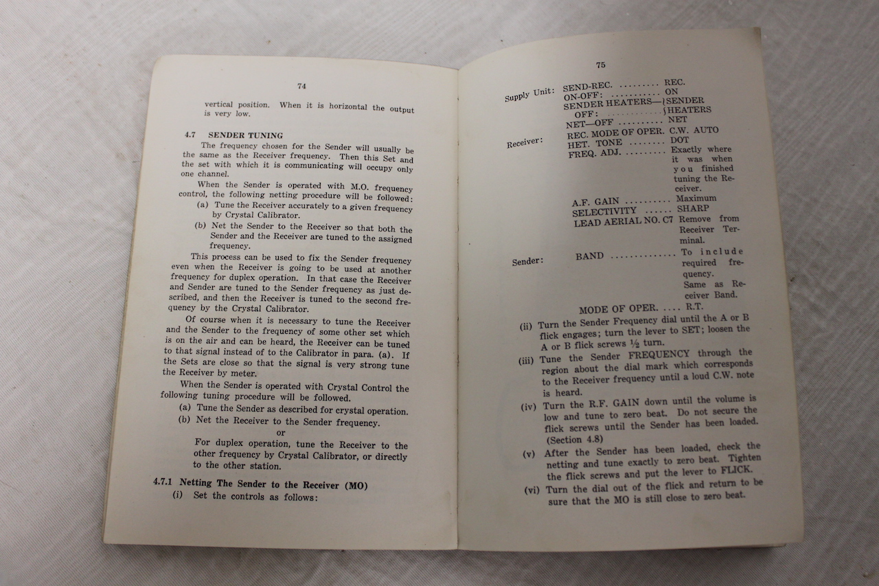

A couple of weeks ago, when the manual for the 52-Set surfaced on eBay, a second one was brought to my attention, off eBay but on the web. I eventually tracked it down and it was still available, so purchased it.
The manual arrived in the Post this morning from Northern England. It is in vastly better condition than the one I have been working with, no water damage at all and the spine is still stiff. The old manual will continue to be my working manual for the project. The schematics and most of the technical information is still readable, however, I will be rereading the dozen or so parts from the new manual which were damaged to the point of questionable reading in the old manual, to make sure I have everything straight. The new manual will then sit quietly in its receptacle on top of the Carriers No. 4 as. a permanent part of the set.
I did a similar thing back in the 80’s with my 19-Set Mk III, when a worn manual became my working manual and is close to being in loose leaf format today, while a much nicer manual became part of the set kit.
The photos show the old and new beside each other and one of the damaged set of pages from the two manuals for comparison. The last photo is the name and date found on the inside of the front cover of the new manual. Not sure at this point if this individual was a British Army member who worked with a 52-Set back in 1962, or if this might be the name of a British civilian who bought the manual in 1962. Perhaps even a British Amateur Radio operator back then.
Working Instructions Manual 1.JPG   Working Instructions Manual 2.JPG   Working Instructions Manual 3.JPG   Working Instructions Manual 4.JPG

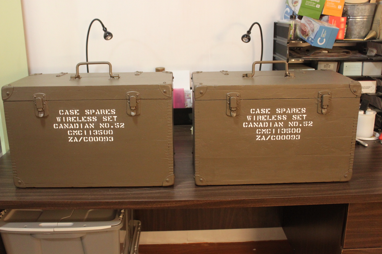

Final fills and sanding done on the grey case this morning and all the metal corner guards have been checked and reinstalled. only three of the eight needed a bit of careful hammer work to get them to sit flush on the case once again, and of those three, only one was quire bad. something had hit it on one side near the corner that really lifted that side off the wood. Fortunately I could just reach the raised bump on the inner side of the guard and work it flat.
So now both cases are ready to have all the metal bits final cleaned with the small steel wire wheel on the Dremel. Hopefully both cases will be done this step in the next week.

Jordan Baker sent me the attached photo of a pair of 52-Set Tool Boxes currently for sale on FB Market Place. $50.00 each, or the pair for $75.00.
The interesting thing about them is they still have most of their original factory Flat Olive Green paint and original stencils. These two boxes bring the total number of current survivors I am aware of to five in all. Four in Canada, including mine, and one in the UK. Three in Canada are still original externally, as is the one in the UK, whereas mine had gone NATO.
For the people interested in the 52-Set, the Tool Box seems to be the more difficult accessory to find, compared to the other two wooden cases. The prevalent thought for this phenomenon seems to be that at some point after the war and before the conversion to NATO Standard Paint in the Canadian Army, somebody in the Supply System realized the tools contained within this particular box for the 52-Set were nothing more than standard hand tools already held in supply under their own stock numbers. So the story goes these tool boxes were stripped of their tools which went back into the supply system under their individual stock numbers and the empty boxes were ‘destroyed, burned, or buried’, depending on which version of the information you encounter. The only survivors were tool boxes that had already been issued and which were in use. Being in use, they all got the NATO treatment paint-wise.
The fact three tool boxes have now turned up in Canada with original paintwork suggests the prevailing story is not entirely true and more documentation on the matter may eventually turn up clarifying it all.
It would make sense if you had a large number of fully equipped tool boxes sitting in a depot unused to redistribute their contents, but it is probably unlikely the entire stock was written off. It would still have been prudent to keep a limited supply of complete tool boxes on hand to replace any that were lost from the ones then in service. Same goes for the boxes themselves. A number on empty boxes were probably retained in the inventory to replace damaged or lost ones in use. When the 52-Set was finally declared obsolete and disposed of, surviving boxes in the supply system were then sold off and it is these items showing up today.
Still nice to know, however, that 80 year old items for the 52-Set keep turning up from time to time.

The factory ID stencils are now on the two Spare Parts cases and this step in the project is now done. The case I will be keeping is the one on the left in the first photo.
The mystery now will be trying to figure out the most logical way the staff at the factory packed these cases upon completion with the required items. The photos in the manual give some clue but a lot of decisions will be in the realm of ‘Best Guess’ I suspect.
The second photo is just the Tool Box and the Spare Parts Case sitting side by side. Probably been a while for either of them since that last happened.
