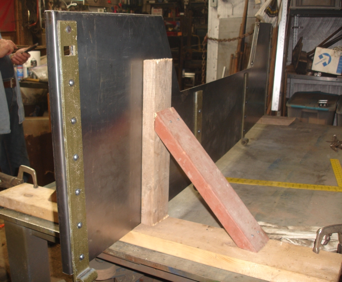

Work on refurbishing Bob's 2B1 body for his C15A has resumed. After considerable planning sheet steel was purchased, and layout done to cut blanks for fabrication of the replacement headboard, tailgate and dropsides.

The headboard (as a less complex shape and with some room for lower precision) was the first assembly made up and attached to the lower body. Before welding the upper stiffener into place blocks of 3/4" steel were installed as reinforcements in the holes for the dropside retainer hooks. The plan is to remove and bend the hooks once the dropsides are assembled. In the meantime the hooks have ribbon to try to keep us from poking out eyes.
Then we moved on to the more complex tailgate. First cutting the blank, then bendingindividual pieces, laying them out for a dry fit and comparison to the "rough" remains of the original.
Headboard tacked in place.jpg   Headboard inside.jpg   Dropside hook.jpg   Tailgate dry fit and original.jpg

The first sub-parts attached to the main sheet were the diagonal braces at the top of the opening. Installing these first let us use them to position the lateral stiffening brace and confirm its fit to the hinges and reinforcement straps. When it came to riveting the hinges to the gate, several experiments were made to try techniques. Although the original rivets were probably installed cold with a squeezer set-up we had to do one at a time. We were limited by several factors - my rivet gun is only rated to 3/16" steel rivets so we had to do without the nicer teasing control and use an "ordinary" air hammer. Even the heavier air hammer wouldn't do the 5/15 rivets cold so we had to heat each rivet to a toasty red, insert it in the holes of stacked hinge, tailgate sheet and reinforcing strap then grab our home-made bucking bar (made from a cast iron snow plow wear shoe) and use the air hammer on the rivet to make the shop head. Once the rivets were installed, the braces were welded into place. The holes for taillight visibility still need layout and creation - later. Also needed are the installation of the previously made hooks and cleats for tie down of the tarp.
First welds.jpg   Tailgate riveted.jpg   Tailgate rivets.jpg   Tailgate rivets 2.jpg   Tailgate welded.jpg

3 more photos showing addition of the reinforcements for the latch hook pivots, holes to permit seeing tail lights with the tailgate hanging down and adding hinges to the dropsides (to be more accurate - the second side still needs some fabrication before attaching hinges). The reinforcements for the latch had been removed from the sample tailgate so it wasn't originally something we realized would be needed. Then we saw photos... The hole saw used to make the cutouts for taillight visibility did leave a rough edge but were cleaned up both for better appearance and because the holes make an obvious grab point and would have cut fingers...
It is noticeable that Bob's smile gets a bit wider every time another part of the box gets fabricated and installed.

The dropsides are now firmly welded to their hinges and the bars the tailgate latches pass through are also welded. The hinge rods for tailgate and dropsides have been cross drilled for the securing cotter pins. The washers for the cotter pins on the hinge rods are a non standard size (at least for current Canadian common practice) so the appropriate size OD washer was drilled out to fit the hinge rods. Hooks were fabricated to hold the forward ends of the dropside in the upright position. (still "as fabricated" and needing to be trimmed for length). In case you are wondering - the large "left" and "right" labels were to stop us from trying to install the dropsides on the wrong sides of the truck. They had been made to be very close to the same but we didn't want to make trouble for ourselves switching them accidentally after making minor tweaks to make each fit in place...
Remaining fabrications: attach the "capstan style" tarp hold downs to the body with copper rivets (sourced, just need a few hits with the rivet gun...) Fabricate and install the tailgate hooks. Install the internal braces on the headboard. All jobs that will take a while and not jump out as huge progress...

The floor and substructure are original (with minor repairs) along with the wheel boxes (which reminds me that the footman loops on the wheel boxes also need to be added).
