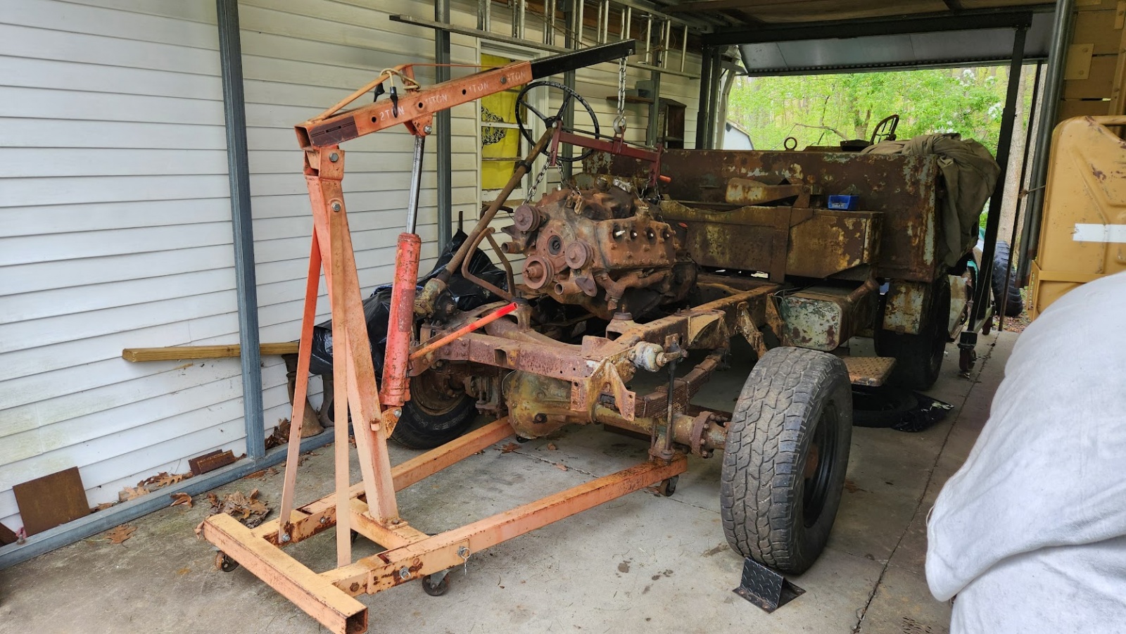

i can't believe it's been a year since i posted my progress. new computer and just super busy. but i have been working on the cmp right thru. with the cab off i have taken the engine out. i won't be using this block. so it will go into storage for now. it does have a rebuild plate dated 1947. the engine from the f60 will be used. it's at the machine shop and should be done in a few months. i use the winch to roll the frame back up over the 4" lip on my concrete pad. saves a lot of effort. now the engine and transmission are ready to be split.

so the transmission is in tough shape inside. the gear cluster is pretty much spare parts. so i will be using the transmission from the f60 also. it's in fantastic shape. i do a separate post on the transmissions later. so i have continued to strip down the frame. took the 3 small tool boxes off the under side of the bed. there in rough shape. probably fab them new, when i do the large tool box behind the cab too. i took the 41 to a local show, didn't unhook the PAK yet. can't be all work. lol
