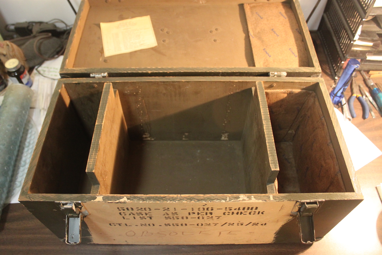

Three more photos today to give a better idea of the interior layout of this case.
The interior of the left section is remarkably free of most signs of use, probably because nothing really heavy, or with sharp edges, was ever stored here.
The main, central section definitely shows signs of the Remote Supply being placed in it over the years. It is a very heavy item, with most of the weight to the back of it. Even if you place the supply at the front of this section, its main weight sits behind the handle on the top of the case. When you lift the case up, it pivots slightly to the rear and you can feel the supply slowly slide up against the back wall of the case. When you next remove the supply from the case, some of the fittings on the back of the supply scrape the lower part of the rear panel of the case. You can see these vertical lines in the photo. Fully packed, this case is going to be a handful.
The KimPak installation for the righthand section follows a similar pattern to that for the Case, Spare Parts. A 9-inch wide strip would first have been fitted to the lid and the bottom of this section. Stapling of the KimPak was done in the same fashion as discussed with the Case, Spare Parts. A 7-inch wide strip of KimPak was then fitted around the walls of this section. This strip, as in the Case, Spare Parts, is set 3/4-inch below the upper lip of the case. However, because this case is not as tall as the Case, Spare Parts, it only reaches to 1/4-inch from the wooden bottom of the case, which means it rests nicely on top of the bottom KimPak pad. The wall pad runs from the left rear corner of the section, along the back wall, up the right side wall, across the front to the partition wall and back along the partition wall to the left rear corner where it rests on top of the rear pad.

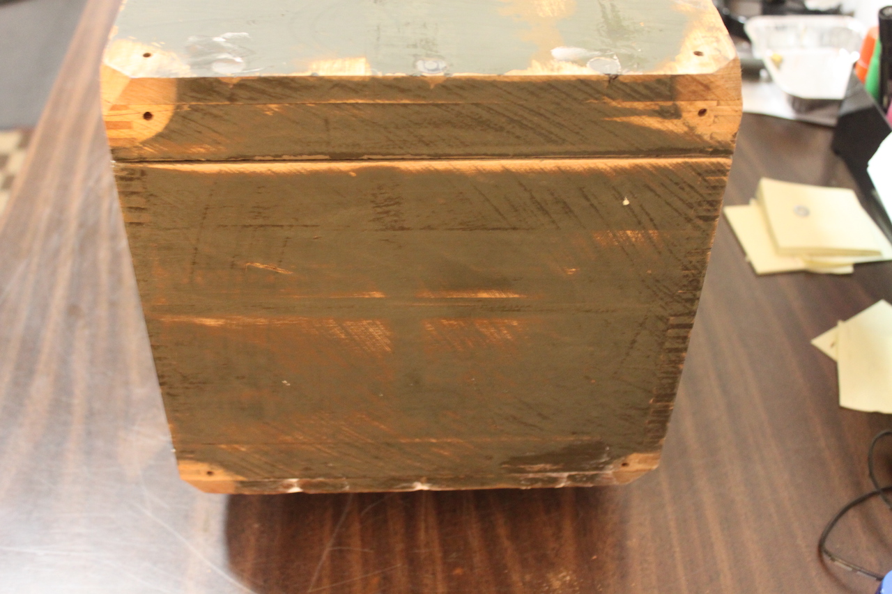

Sanding back the layers of paint on this case has revealed the most complex set of stencil markings I have ever encountered on a piece of Canadian Army equipment from the World War Two era, either vehicular or signals equipment related.
The attached five photos highlight the major finds as I worked my way down through the paint with both power and hand sanders and damp cloths.
Starting from the factory to most current:
On the factory Flat Olive Drab paint is the 1/2-inch stencil in six lines starting one inch below the lip of the case and centre justified. Lead line is the CMC part number for the case and the second line is the CMC version of the ZA/CAN Number.
On NATO Green, a 1/2-inch stencil in six lines starting 1/2-inch below the lip of the case and left justified 2 inches inside of the left hand latch assembly. Here, the CMC ZA/CAN Number has been replaced with the actual VAOS Number for this case.
On NATO Green, a 3/4-inch stencil in six lines starting 1/2-inch below the lip of the case and left justified 2 inches inside of the left hand latch assembly. This stencil also uses the actual VAOS assigned number for the case.
On NATO Green, a 3/4-inch stencil in six lines starting 2 inches below the lip of the case and left justified 2 inches inside of the left hand latch assembly. Again, the actual VAOS Number was used.
On NATO Green, a 3/4-inch stencil in five lines starting 2 inches below the lip and left justified 2 inches inside of the left hand latch assembly. The actual VAOS Number was used but the CMC Part Number was deleted.
On the tan/yellow layer of paint, the final black stencil using the NATO Stock Number data as shown in the photo in Post# 1030.
In addition to all of this, a free floating 1/2-inch stencil of just the actual VAOS ZA/CAN Number was found on either side of the front of the case, centred below each latch assembly, 3.5 inches below the lip. I could not match these up with any other surviving stencil lines on the front of the case, but they were both on a NATO Green background paint, and appeared to have been a one time only application.
What is interesting is the use once again of 3/4-inch stencils. They were also found on one of the two Spare Parts Cases I restored earlier this year; the one that also had traces of tan/yellow applied to the front.

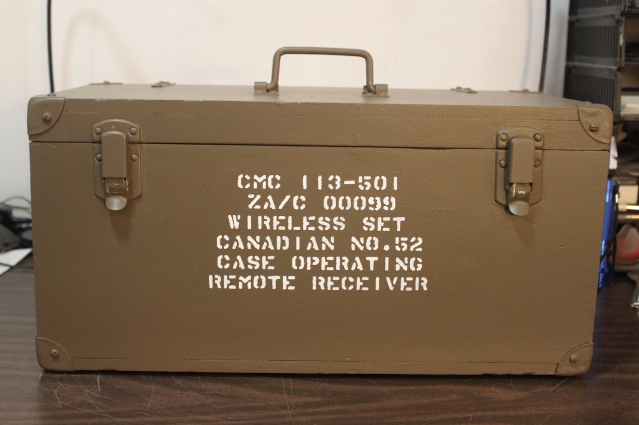

I managed to get the stencil done on the front of this case this afternoon. This was the largest of the ID stencils for the 52-Set boxes/cases, at six lines of text and that meant more surface area to get the paper cement applied to as quickly as possible, before the cement started to set up. The oil board stencil also had a bit of a curve to it towards the bottom right, so I went into this expecting a lot of paint bleed under unsecured portions. Turned out to be the best of the four stencils I have done. No bad bleeds at all and just four clean but fat characters to give a slight touchup to on Thursday.

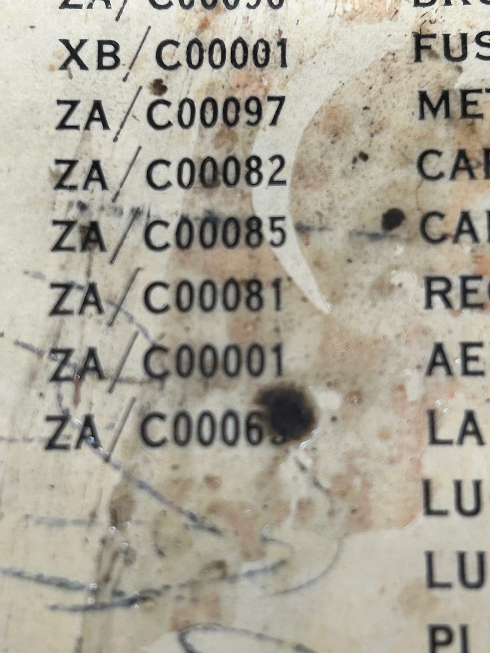

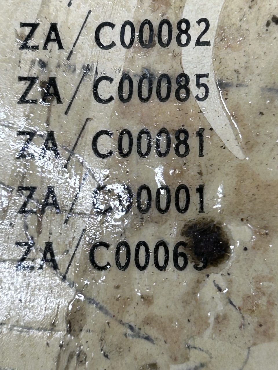

I asked for some detail photos from my friend, Reg, of his Case, Spares Contents List label to see if they would help in identifying the font Canadian Marconi Company used in printing these labels, They were a big help!
First, one photo was of the CMC Part Number for this list which turned out to be sequentially right behind the Contents List label for the Remote Operating Case: 114-554 versus 114-553.
After a close look at groups of identical characters in these three photos, the realization also dawned on me I was not looking a traditional, typeset printed characters at all. these labels were actually hand drawn by professional Artist/Illustrators. Probably the same team of workers responsible for the amazing detail in the illustrations in the Master Parts Lists for the 52-Set.
For any given character, there are no identical duplicates. when one looks carefully enough, you start to actually see the subtle variations in line thicknesses, heights, widths, curves and end points of each character. Their work 80 years ago is truly unique and amazing.

Reg sent along another photo of his list after carefully unwrapping the curled lower right corner to reveal the CMC Part Number for the list and regluing the corner to the KimPak padding on the lid of his case.
