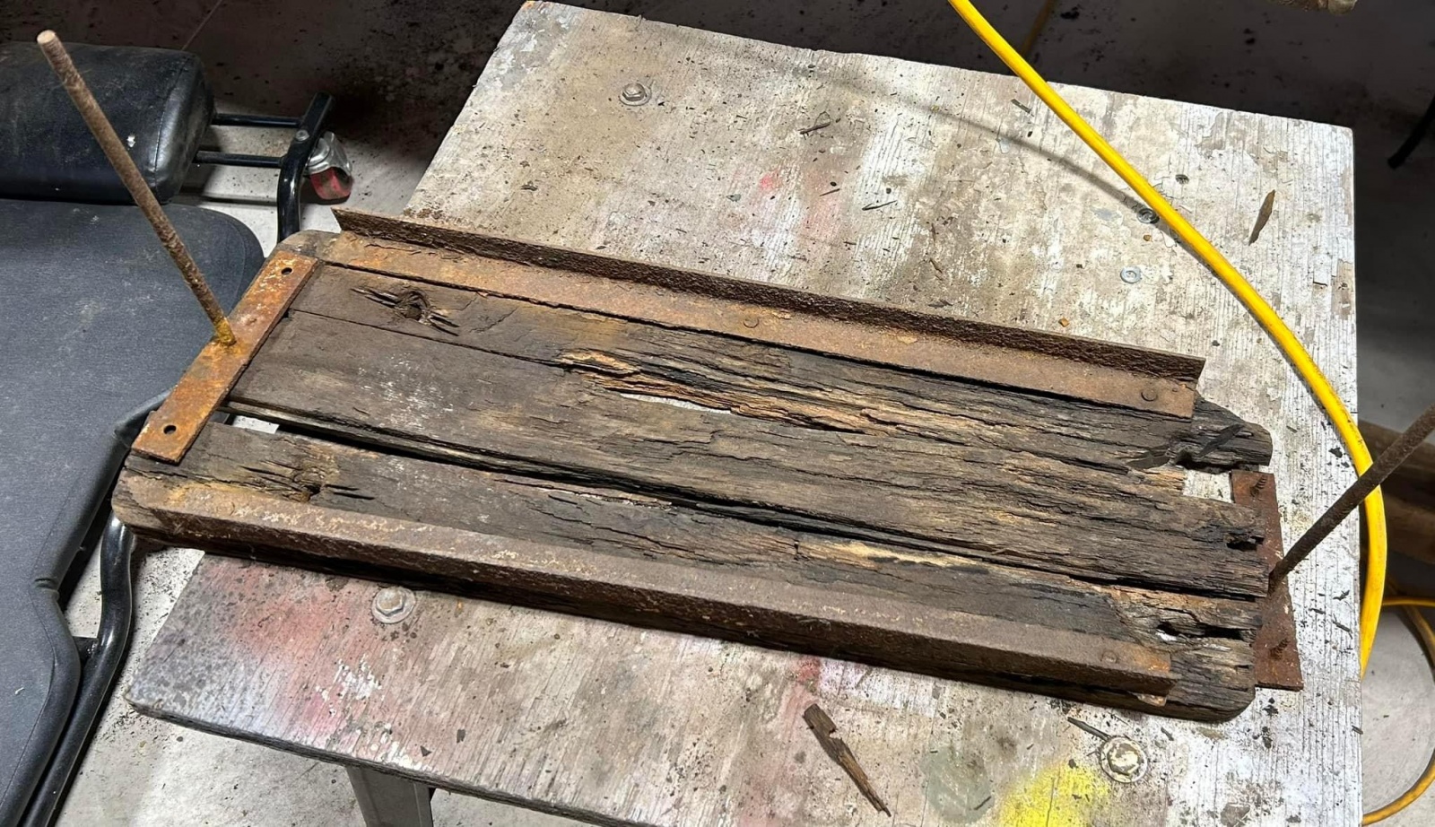

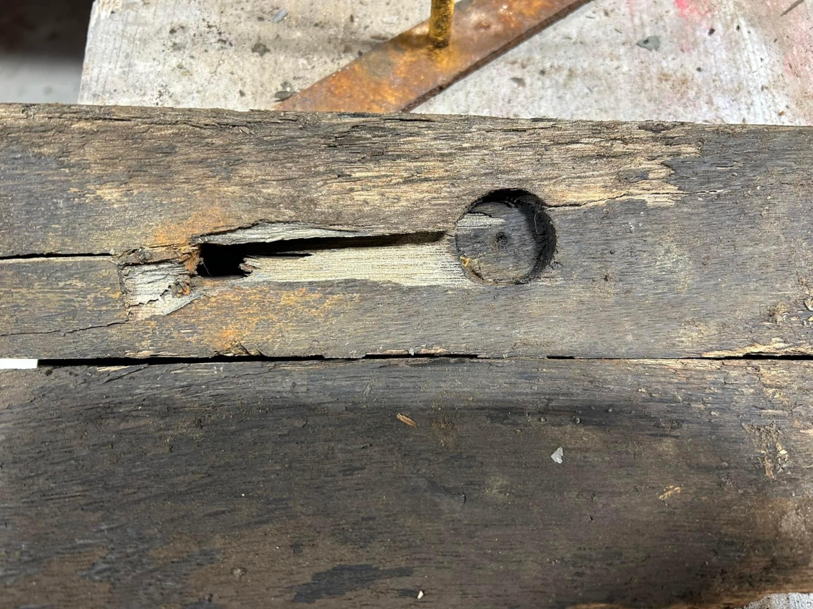

Todays allotted time in the shop (kids are napping) I managed to get the original battery tray removed. It was held in by 4 carriage bolts. I tried removing the nuts but the bolts ended up spinning around in the wood. In the end I used a Zip disk to cut the heads off the bolts. Yes this did mean that I had to cut into the wood and produce copious amounts of smoke in the shop. However the wood was too far gone to use again. Lots of dry rot had taken place.
The wood shall provide a very nice pattern to make a new one. I should also be able to use all of the original metal parts. It’s a simple construction of three pieces of white oak with a tongue and groove slot. Two metal angled pieces along the long top sides. One the end there is two flat bars with the vertical retaining rod and counter sunk holes for screws. It’s refreshing to see true 1” thick pieces of wood.
The last picture shows just how much crud came loose from the tray’s removal. The area had been vacuumed prior to removal.

Hi Jordan.
Is this tray for the wireless batteries, or the vehicular ones?

David,
The Otter used two 6v batteries in series to make 12v. The batteries were used to power both the vehicle and the radio. It also had an oversized generator and heavier wiring for the charging circuit to allow for a quicker charge back into the battery.

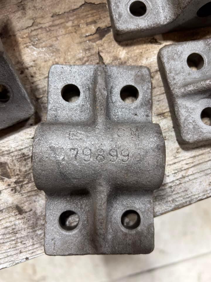

All four towing shackles removed and dissembled. Thankfully no heat was required. The Milwaukee impact driver did amazing work on the bolts and nuts getting everything removed. The shackle bolts did need to go in the shop press. These parts will all clean up nicely.

Towing clevis all sandblasted and cleaned up. Other than the four 9/16-18 castle nuts, all of the original bolts and nuts will be used. Interesting manufacturing marks were found on two of the clevis bolt heads. I believe they are “B D” I’m not sure what company that would have been.

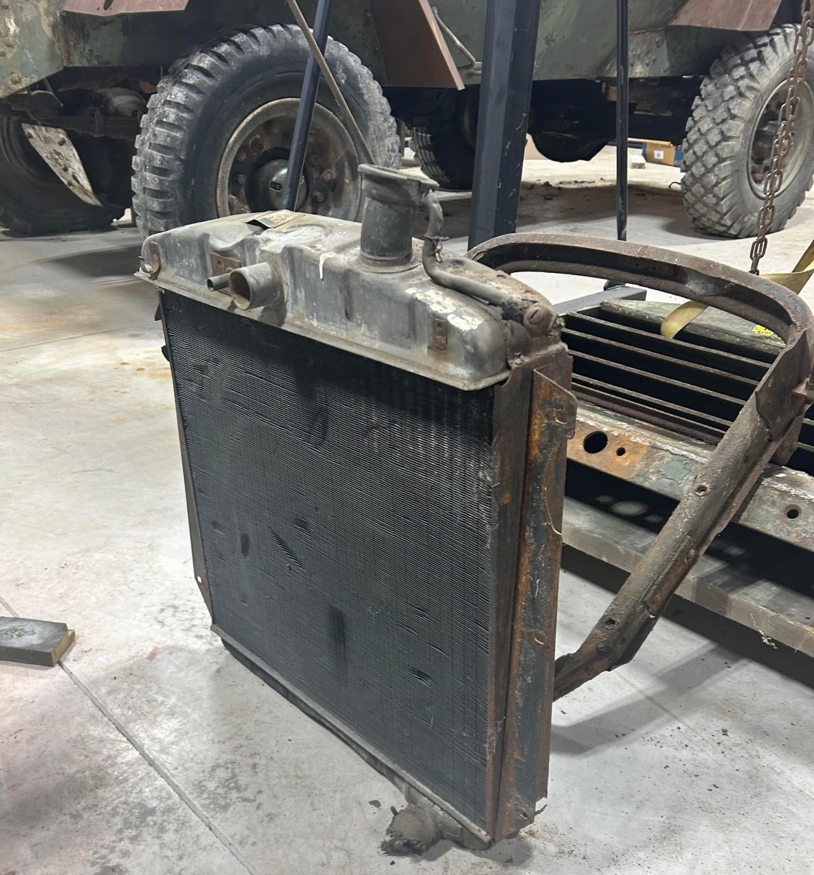

Once the shroud was removed the radiator is easily accessible. I’ve also included a few pictures of how the armoured body was attached to the frame and the engine crank bracket. I’m also quite pleased that most of the bonding straps are all still in place. Lastly the plate welded to the left side hull body plate. This was where the voltage regulator mounted. The remains of the shielded wiring ground are still attached.

..... the radiator support has a complete top section similar to civialian GM of that period...... in contrast the CMP has that same part with the top section cut off and referred to as the horse collar..... also your rad filler neck is similar to the cab 11 but cab11/12 had them on the pass. side yours is driver's side....
did your truck have a fan shroud???
Sure is built solid!!!!!!

Yes there was a fan side shroud. I’ve included a drawing from one of the Service Information Bulletins. Thankfully these drawings provide a lot of detail.
Interestingly the radiator has what I believe to be a Dutch rebuild tag on the top of if. I’ll try and get a picture in the next day or so. It was only ever half visible due to the way the armoured nose fits on.

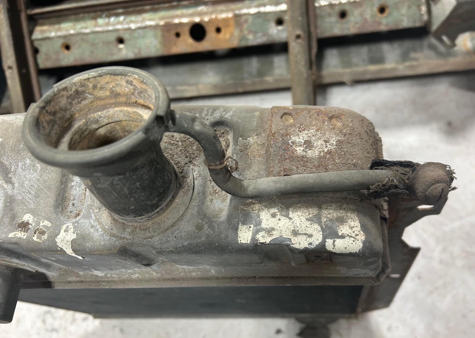

Radiator removed from the chassis. It’s quite the heavy duty mount that it sits in. Nice to see all the KG#3 paint when taking things apart. Interesting Dutch rebuild brass tag on the radiator top tank. Also some hand painted white numbers on the top of the tank. Appears to be 1953 and 254.

Lastly some updated pictures of the engine compartment now that the radiator is removed. It is nice to see spots of the GM chassis black and then over painted with KG#3.

Nice find! Bloksma Radiateurenfabriek (radiator factory) was a medium sized company founded by Mr Bloksma in 1920. In the 1970s they had 15 branches, which were later sold to the branch managers or amalgamated into Bloksma's Nederlandse Radiateuren Fabriek (Netherlands Radiator Factory, NRF) (https://www.nrf.eu/about-nrf/our-history/)

Any idea if this makers plate could be dated?
