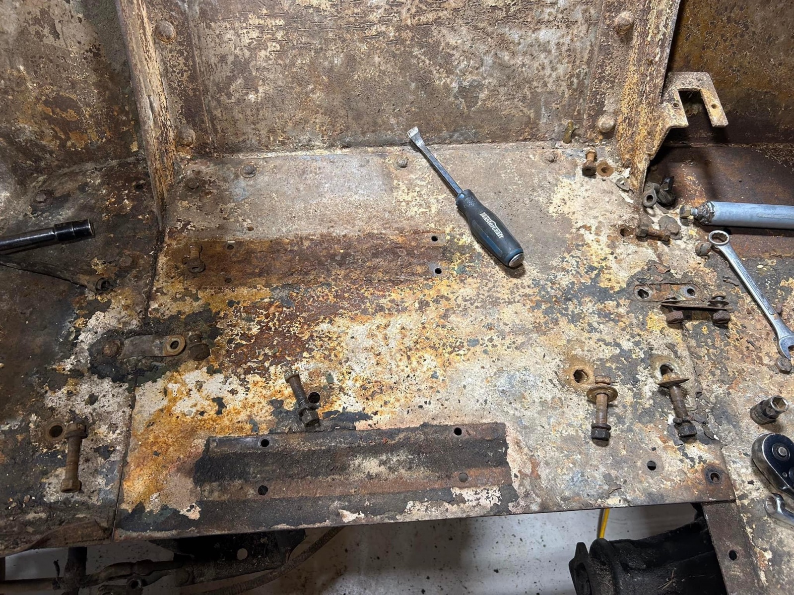

Old 08-03-24, 03:06
Posts: 4,183
Pulled the engine the other night. She is one heavy power plant with the bell housing and transmission all attached. I’ve still got to build a simple wooden cart to hold this engine so it can easily be moved around the shop. Once that is done, the plan will be to pull the transmission and get it taken apart and rebuilt.
The oil filter was also removed from the frame rail. I took advantage of the warmer weather and got it all cleaned up and painted. When I was cleaning the grime off, I realized the filter had been over sprayed with KG#3. But only the side that was visible and not covered by the frame. When I removed the mounting brackets they were the proper gloss black and the filter was the early grey colour. For now the filter will stay grey. But once it’s back on the frame I plan on giving it the same overspray of KG#3
Lastly I’ve started removing the floor panels. Lots of sand, rust and other debris is coming out of the Otter. It’s amazing just how much crud has accumulated in this vehicle.

The vehicle is getting lighter for sure. The shop vac is getting heavier though.
Did a little bit of work tonight pulling some more parts. The front floor panels are now all removed. I’ve also removed the brake/clutch pedal assembly, the handbrake lever assembly and the transfer case lever. All will be their own restoration projects.

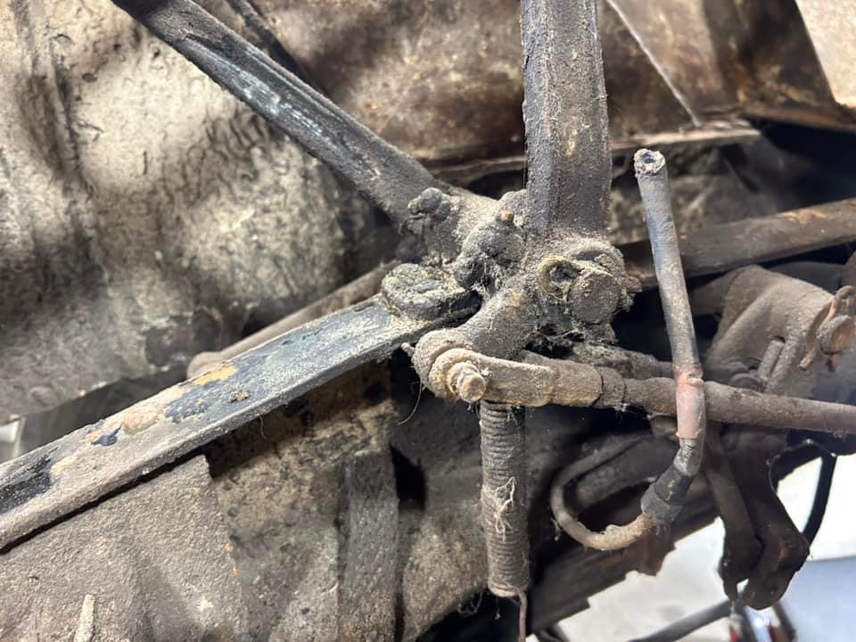

  #328
Old 09-03-24, 06:22
Posts: 4,183
Four shims were found under the brake/clutch assembly. The entire assembly is interesting as it comes off with the removal of 8 bolts. Four hold the master cylinder mounting bracket to the frame and 4 hold the pedal linkage to the frame.

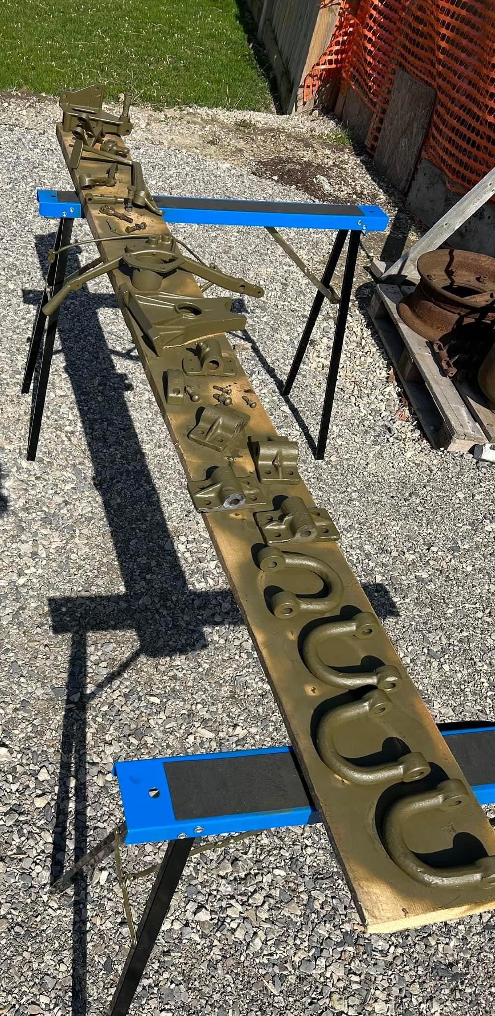

Old 10-04-24, 01:20
Posts: 4,183
Well it was a beautiful 25 degrees outside today. So taking advantage of this lock weather I decided to get a bunch of my otter parts all painted up.
