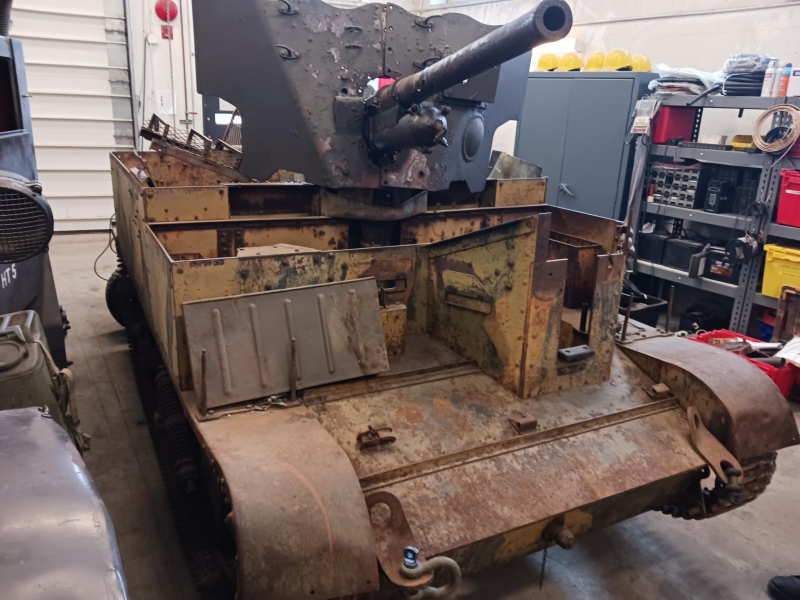

I made a quick trip to the Canadian War Museum and the technical expert there (Mike Miller) kindly let me take a few photos of their Tank Hunter Carrier. I believe it is somewhere on the list to get a restoration. Enjoy the photos.

The shield on the CWM example is a standard 2 pr shield, not the correct one for the tank hunter which was cut down along the lower edge.
Unless it is war art, medals groups or the social history of war, it does not matter as that is a minor detail that only the enthusiasts will spot.
Bit more than a minor detail 😂. I hope they replicate a new shield rather than slicing the bottom off that one.
Attachment 136783
Attachment 136784
Attachment 136785
Attachment 136786
Why "restore" if its wearing oiginal paint and markings ?? Make it safe and reliable to drive and operate, kit it with what should be on board and enjoy the barn find look. Far to great is the rush to "restore" with fresh paint (Holy Roller) and "make it better" to the eye...........everything, was only new once.
