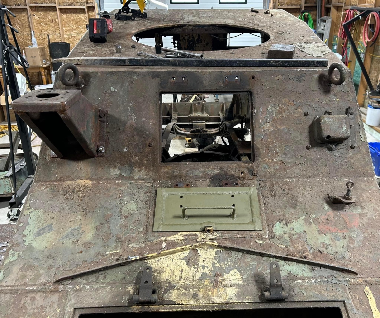

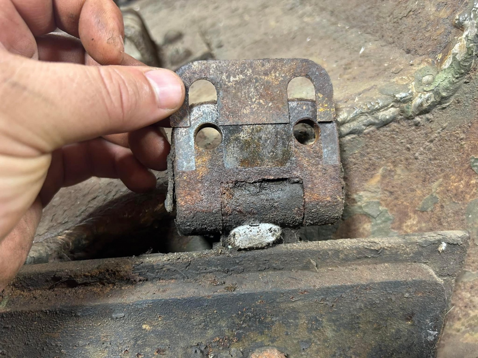

Slow but steady. Rear hatch removed for cleanup. Interestingly there were shims behind the hinges.

The Humber Mk 4 and Panzer 3 we restored also had shims under the various hinges
Interesting. Some aspects of these vehicles are pretty crude, then they instal shims under hatch hinges.
