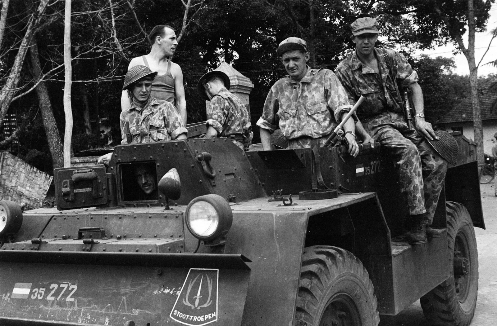

Old 13-11-24, 13:04
Posts: 14,974
Default Reg.no. 35-271 and 35-272
There are two Wheeled Carriers, both of which have the typical Indian Army census numbers of which the /|\ has been supplanted by a Dutch flag. They are following a Universal Carrier and what may be a Humfox leading the column.
These photos show Dr. C.P.M. Romme, a Dutch politician (in the light shirt) sitting on a Wheeled Armoured Carrier, part of a column on the "death road" from Medan to Belawan, Indonesia.
Apparently there was not a high risk of attacks on that day, otherwise Romme would have travelled under armour.
Date: 2 February 1947
