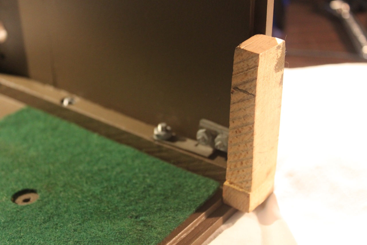

With the sanding and stripping down of the NATO Green paint on the exterior of the coil case and back cover completed, I have been focusing on getting this paint off all the 1/4-inch and 1/2-inch surfaces created by the recess cuts for the front panel and rear cover, and the six 1/2-inch square reinforcing strips in the four box corners and backing for the rear cover.
It has been very slow but steadt work. I have now assembled a nice assortment of tools that work well on this small stuff in tight spaces and have worked out a fairly reliable pattern. Once I can break through the heavy coat of NATO Green, I have found the pine has a pretty good hardness about it, such that a hard steel edge can actually chip chunks of the paint of very easily. The only tricky bits so far are the presence of saw ridges on some of the 1/2-inch strips that require a bit of sanding to smooth down first.
The last of these small pieces I have to clean now are the inside faces of the four pine strips that form the backing for the rear cover. I need to have the case resting on its back on the bench with several gooseneck lamps in close to properly light the interior of the case to see what I am doing, and reach down and in at a steep angle. I end up starting at a midpoint and moving to one end, vacuum the bits out and then swing the case around to clean up the opposite direction. Slow but steady.

Here are some photos I promised of the cramped quarters being worked in to strip out the last of the NATO Green paint.
The rearmost 1/2-inch trim is the worse, with just the lower right area section actually done. Once that stuff is gone, I can work my way forward through the interior panels with my two sanders easily enough to get rid of the last of this postwar paint.

  #1139
Old 02-01-25, 02:17
Posts: 3,721
Default COIL, Aerial Tuning No. 2 A. ZA/CAN 4725
First thing this morning, I started cleaning the lower left and right front panel mounting brackets and hardware and get them into the zinc plating bath. Once that was out of the way, I installed the Right Side Mounting Plate to the bottom of the coil case.
In the second photo here, you can clearly see the longer front 8-32 machine screw used at the front of the plate in order to fit the grounding strap. There is a depression in the countersunk ho;e here which gets filled by a flat washer that gets dropped down over the machine screw before the grounding strap is fitted. If that space is not levelled off, the brass grounding strap will get pulled down into the depression when its hardware is run home. Under the stress, the brass strap eventually fails and snaps. The one on this coil. did because no washer had been fitted, but the grounding strap on my parts coil was in perfect shape and had the missing washer.
