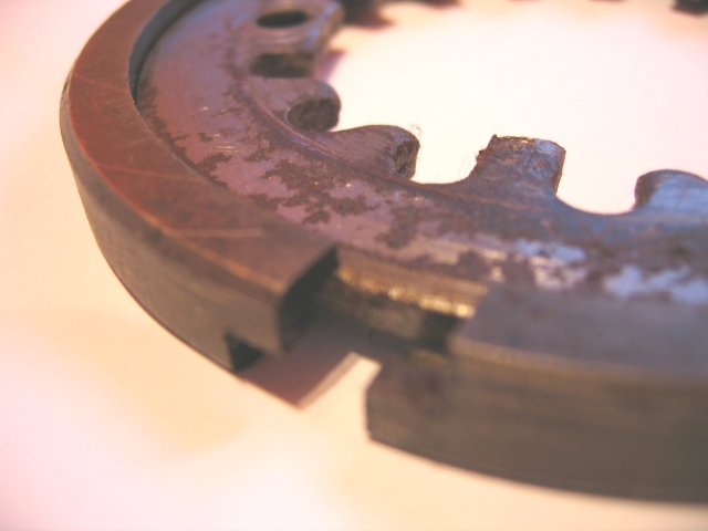

Can any one help in identifying item M in the attached image.
One off mine is broken and needs to be replaced. It would appear to be a standard ford part but I havent got a part number for it. Has anyone got one which I could purchase.

Although this information comes from an Aussie Carrier Spare Parts Manual it appears to be a standard Ford part. It looks like it is a "Ring - grease retaining" and has a part number of BB-4245-B.

The Canadian U.C. manual lists that seal as C01T4702 and as Ford GAE 4702 and UK No. LV3/FD/BB 4245-B, (this is what I told you on P.M.),when I checked my N.O.S.,those were marked VICTOR 49850 and B-241126. I pulled an axle from the Mk1 U.C. in my driveway,and that seal was also a Victor 49850 (B-241126).

The item shown in the photo actually looks like a combination of the seal and the locking washer. On the Cdn carriers (and the Chev 15cwts as well) these are two seperate pieces.
As Cliff mentioned, the seal is C01T 4702. The ring is an 01T 1124. There must have been a change up at some point because the carrier manual does not reflect the seperate lock washer, yet that is all I have ever seen.

The photo indicates 2 separate pieces;"L",and the seal,"M".

I see the L and M, but I see only 1 part. I've never seen the seal before with all the tab slots in it. And the locking washer goes on before the seal, so we should be looking at the seal in the photo.
FUC-03 shows the locking washer on the outside of the second adjusting nut, with the seal in the middle of the two nuts. Seems like the washer would do very little good there; it would rattle off and ride on the axle shaft. The location of it in the parts diagram made me think it was an add on.
The workshop manual UC F-1, 0n pages H0 and H1, show it between the bearing and the adjusting nut. In fig 1 it even gives it a different group number; 1240 and calls the adj nut 1124.

Here are some photos of the real thing. It would apear that the lock tab part of this assembly is with held in the outer grease retainer.
I am trying to find the grease retainer part 'M' which is shown in the illistration.

A comparison of seal location in a Canadian U.C. and of the combination seal/ lock washer in U.K. carrier.
U.K. first, Can. second.

Thats great so I need to be tracking down a british carrier version.
I can see the diffrances you were explaining now. You dont happen to have a part number for type I am looking for.
