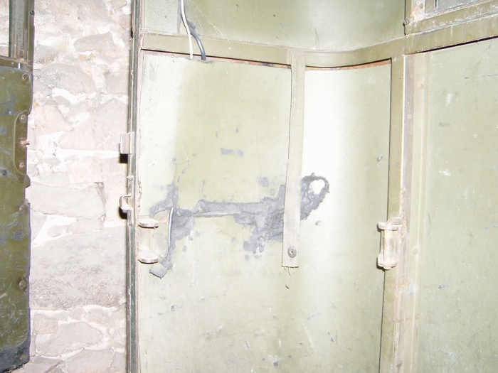

the "behindrearwheel space" . the front plate with lamps is of course not orig., they have to be there because of traffic

the stanchion that keeps the legs is on the spring, so it keeps them near the seat when it is up....

Much gratitude for the jump seat pics - now I know how the things are supposed to look and how they work.
I like the taillight setup also.
But I see *two* PERS-3s in the Pilsen parade shot - whose is the one numbered "4046328" on the right side of the photo?

Rob, The checker pattern is on the underside as the PERS-3 staff car had a linoleum floor, so the plates were just flipped and flopped to leave the smooth side up. Mine's the same.
Really neat to see the toolbox setup under the rear - that will be a whole project in itself.
The front spring hangers are waaay different from the earlier HUPs, as they are at the front end of the frame rail and back up a big casting on the inside which is the bumper mount - something else I'm hoping for pics of from Frantisek (hint, hint).
As for "wood" in the rear fender - are you referring to the fender welt? Or am I missing something else?
