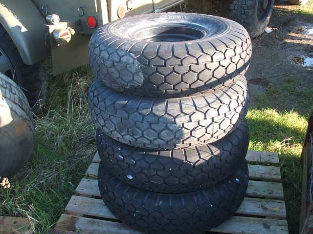

Could be worth following up JetStream spray carts used this tyre for years in OZ. Spray cart tyre rolling radius is critical to accurate spray delivery so tyres of precisisely the same diameter are essential to primary producers. Check the spray cart suppliers near you.
Olympic 9.00x13

I've checked all the tires sources I can find to no avail. The last place I started to look at farm implement tires. However, now that I have access to this site, I thought I might save myself some work if any of you had any sources. I live in Arizona but would be willing to bear the freight costs from any supplier you all could recommend.
I'm aware that these size tires are scarcer than hens' teeth so any words of comfort will be appreciated!

Hi, Jim and welcome to Maple Leaf Up.
Much has been written on 9.00-13 tyres, but little has been found in the way of a suitable new replacement product. I'm afraid you're limited to scouring swapmeets for usable 2nd hand tyres, or settling for modern styles with ATV or agricultural tread patterns!
Read up on the subject here.

Posts: 514
Dirk Leegwater still has tires posted on his site. I think the shipping would be prohibitive though. Tires are near the bottom of this page.
http://www.lwdparts.com/vwwvehprts?o...id=a&count=100
Paul
