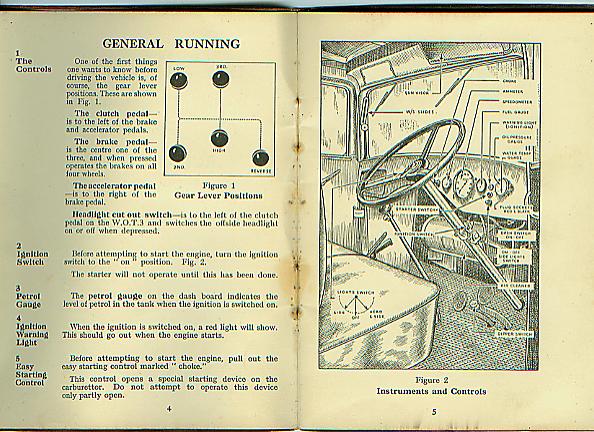

A couple more items first from the handbook and second, the ministry of supply issued a large number of WOT3s for civilian emergency use, this cutting from firecover shows a row for the overseas column
