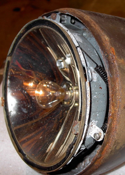

Default Cab 11 vs 1 1/2 ton Chevy headlice...
Well I took apart one of the 1 1/2 ton chevy headlights to compare to the Cab 11....vs ...UC... and there are some similarity.
See picture below....... NOS 1 1/2 Chevy has identical lens and reflector bulb arrangement... except the Chevy did not have the small parkinglight bulb installed similar to the cab 11... all wired but no bulb.
The retainer ring... the one that holds the lens in place is only 1/2 inch thick or wide one the cab 11 and 1 inch wide on the 1 1/2 ton chevy.
The refelctors and bulb are in remarkable shape....BUJT.. for the love of God.... I oculd not remove the large bulb from the cab 11 or the 1 1/2 tonner.... I pushed... twisted...puller... swore a little... it moves but could not take it out.....
Main bulb read 2320

Old 08-01-06, 05:31
Default Pic. 2
Smaller rusted ring is for the cab 11........
Old 08-01-06, 05:32
Default Pic ....3
On the left is the NOS Chevy..... dull one on right is cab 11
Lens are identical.
Old 08-01-06, 05:36
Default 4th and last....
Look at the bucket arrangement on the 1 1/2 ton chevy....
typical modern setup..... well circa 1960 anyways... with springs and beam alignment screws..... reflector polished real nice.
Old 08-01-06, 06:52
Posts: 4,189
HI Bob
Your picture #2 has both kinds of retainer rings that I have. The smaller is the same kind in my UC lamp whereas the larger is the same that I have for the Cab 13 lamp. None of my reflectors have the hole for the park light but one of the CMP lamps did have it wired.
I have noticed that both your reflectors and mine are identical except for where the sockets plug in as they would be Chev/Ford specific.
I found I needed a third hand to remove the bulb from the Chevy lamp. One to push the socket from the rear, one to hold the reflector and one to twist the bulb out.
I woud say from your photos that the UC mk1 lamps and the Cab11/12 lamps shared a lot of common parts and would be interchanable to a point. But with the Cab 13 trucks it looks like they went back to the civie style lamps as had been used on the cars and truck of the period.
