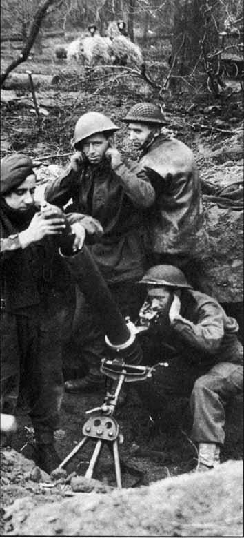

Default British 4.2-inch Heavy Mortar
I canīt find much info on this weapon on the internet, and am interested to learn more about it in relation to the Carrier, 4.2 inch Mortar (T16).
Is this picture depicting the correct type?
Source: http://www.mortarsinminiature.com/photo_shop.htm
Thanks,

You do have the correct Mortar. Attached (hopefuly) is a page from the long out of print book WW2 Fact Files on Mortars and Rockets.
There is another late war version which has wheel's on the base plate allowing it to be towed behind a jeep. This type remained in British Army service untill the 1960's. I believe the Dutch army retained stocks untill quite recently.

Having said it's original the legs could well be a post war mod looking at the pictures.

The gun in your original photograph seems to have some significant modications to my pictures. There was an American 4.2" Mortar but this looks significantly different again. I am not a where of any 100% original 4.2" Mortars in private ownership in Europe.

The 4.2in Mortar pictured at the top of this thread is a rarer version, but the one pictured is from the Bandiana museum.
Indeed the American 4.2-inch mortar was an entirely different weapon.
The one pictured above looks similar to the one below, but yet there are differences which I can't explain. Who can tell what the (wartime) different models are of the British 4.2-inch mortar?
