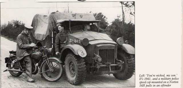

Just idle curiosity really. This photo first appeared in "The Motor Cycle" of 27/3/1941 and was subsequently reprinted in "Classic Bike"
Identification of the Norton WD16H is not a problem but the truck is puzzling me.
I have been informed that the Census number relates to a 15cwt Morris Commercial but must confess that I am unfamiliar with the bonnet styling and cannot identify it from my limited resources.

I'll open the bidding on a Morris 15cwt of around 1936 vintage, nice picture full of atmosphere

The Census number appears to be Z34849 which places it as a Morris Commercial 15 cwt built to Contract No. V2695........a very early one and I would guess the first main batch after the trial ones.

Thanks as well for the identification. Looking at the printed copy, I think that the number may be Z24845 (I'm pretty sure about the last digit) Presumably this would not alter the contract information ?

Here is another early CS8, that has been given a modified windscreen, while in use with the British Army in Italy. Although the aero screens have gone, the vehicle still retains the less angular early style bonnet and mud guards which on early models had a thicker edge.
Rich,
No, it definitely starts with 3, if it was as you say, it would make it an Austin 4x2 ambulance. Last digit is irrelevant in this case as it falls well within the batch.
