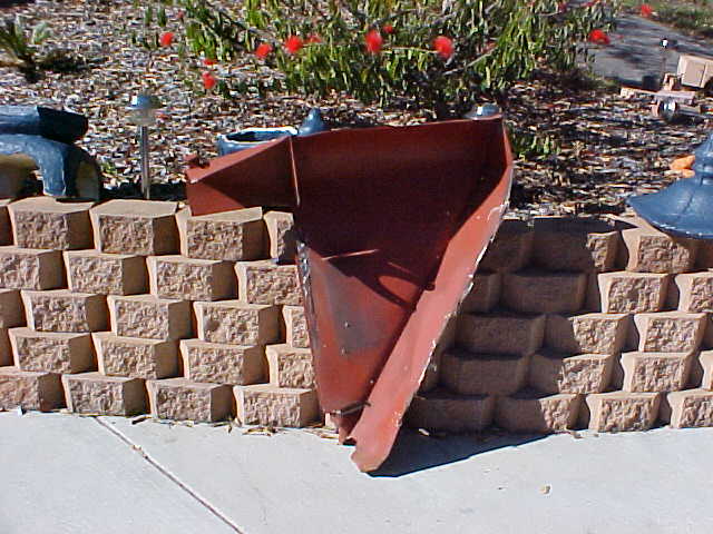

Old 02-07-06, 04:29
ron ron is offline
Posts: 1,294
Default air scoops
Hi Eric,
Here are the pics of the remains of the scoop.
Ron,
Ron Winfer
Old 02-07-06, 04:31
ron ron is offline
Posts: 1,294
Default other side
This is a shot of the other side
Ron,
Ron Winfer
