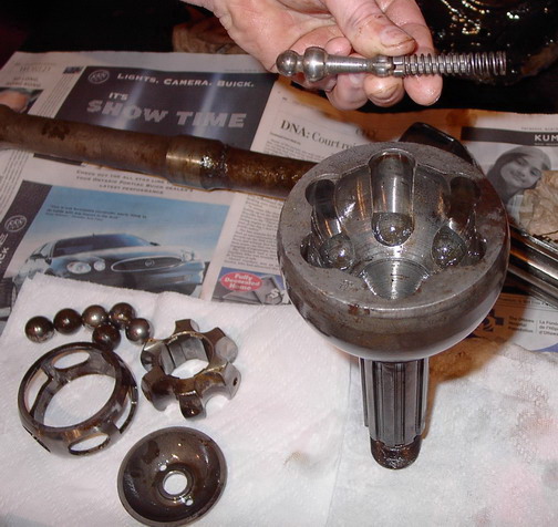

Old 07-09-06, 05:25
Default Back to the Rzeppa.....
Here are some pictures of a.... finally.... disassembled Rzeppa joint.
With a lot of help from Grant Bowker who found some detailed instrcution in a Ford manual..... there seems to be some indication that Ford favored the Rzeppa and GM went to the Bendix a lot sooner....
Any ways.... the trick is to cleanup the hole at the very end of the axle where the big nut goes on...... behind the gunk is a set screw seen as a small black dot on the pictures..... once that is removed a skiiny screw driver can push out the center pin and the spring plunger that is behind it... only then can you rotate the cage and bearing enough for the... in this case rusted... ball bearing can be removed than the cage comes apart....
I am totally facinated by the fine machining and tight tolerances in these old parts..... no wonder they went for a simpler Bendix or tatra design.....
So here are the pictures....
Old 07-09-06, 05:35
Default more pics....
In the previous picture the top joint is a 4 7/8 inch joint and that is the good one I salvaged of the axle from Stew/Chris......
The bottom one is from an assembly from Dan/Jeff Caldwell... unfortunately rusted but a good subject to learn from......
The rusted joint is a 4 5/16 joint used very early in production according to the Ford manual..... possibly found wanting for strenght.
The Ford manual refers to two(?) other large sizes the last one being 6 inches.....
They are very intricate pieces of mechanical marvel......
here is a close up of the central pin and spring plunger held by Grant...... that central pin actually fits a tightly machined hole in the end of the central half of the axle........
We have since disassembled the long axle shaft side and also found it on excellent shape.
Plans are to take the two good joints apart... one at a time so as not to mix the matched parts.... clean and relube with Moly grease... reassemble and store wrapped in grenn plastic bags until ready to insert into the axle tube of the cab 11.....
If I canbe of any help to soemone doing the same please ask..... I have other pictures that I can share.....
