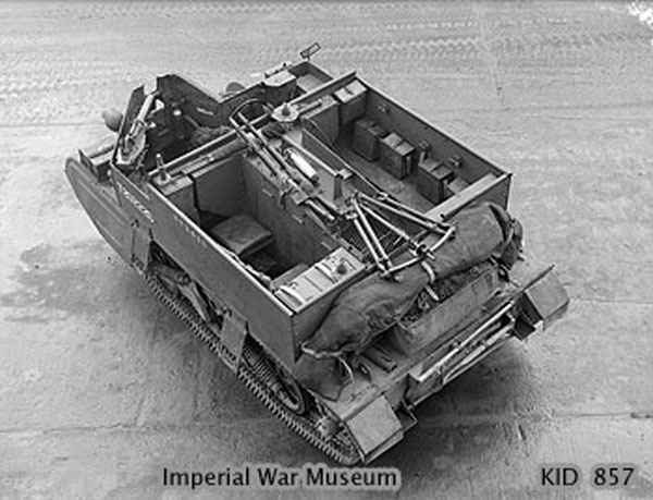

This one shows the same setup that Stewart has in his wonderful carrier. You can also see that mounting it one the engine deck was no longer an option since the rifles are now there along with other things.
